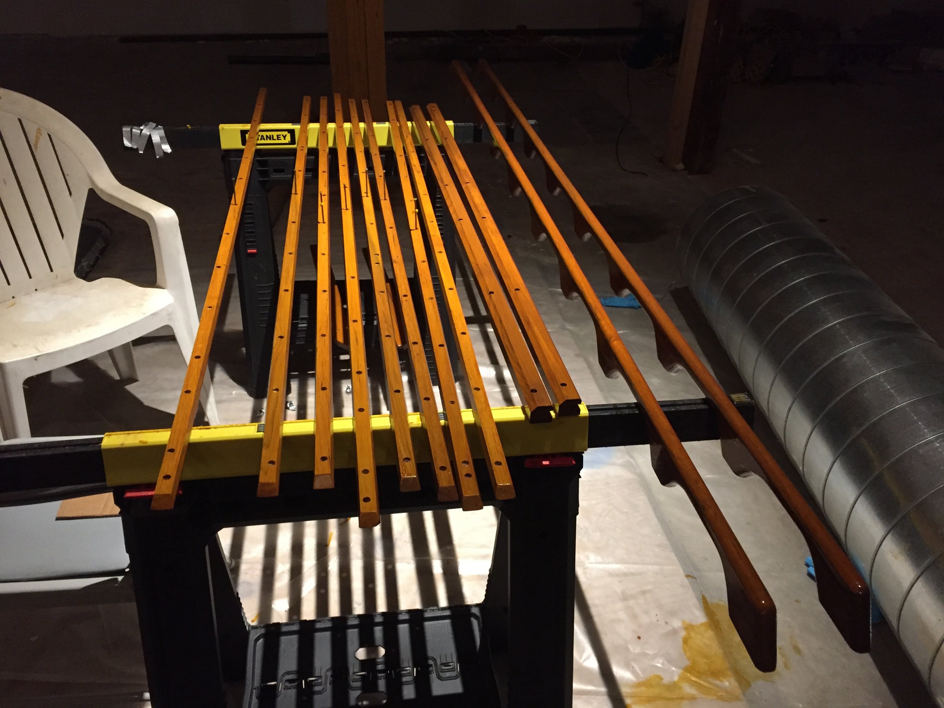

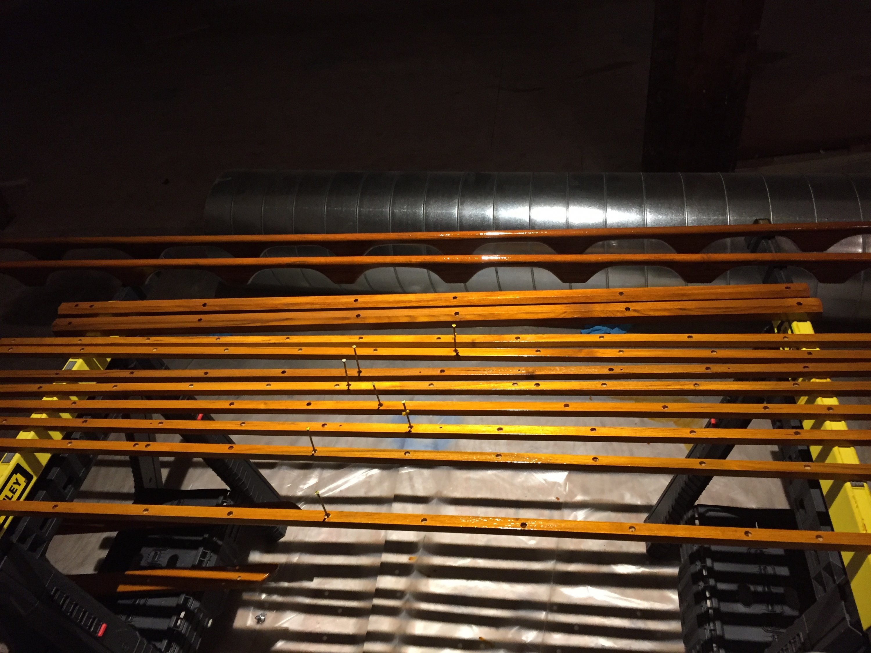

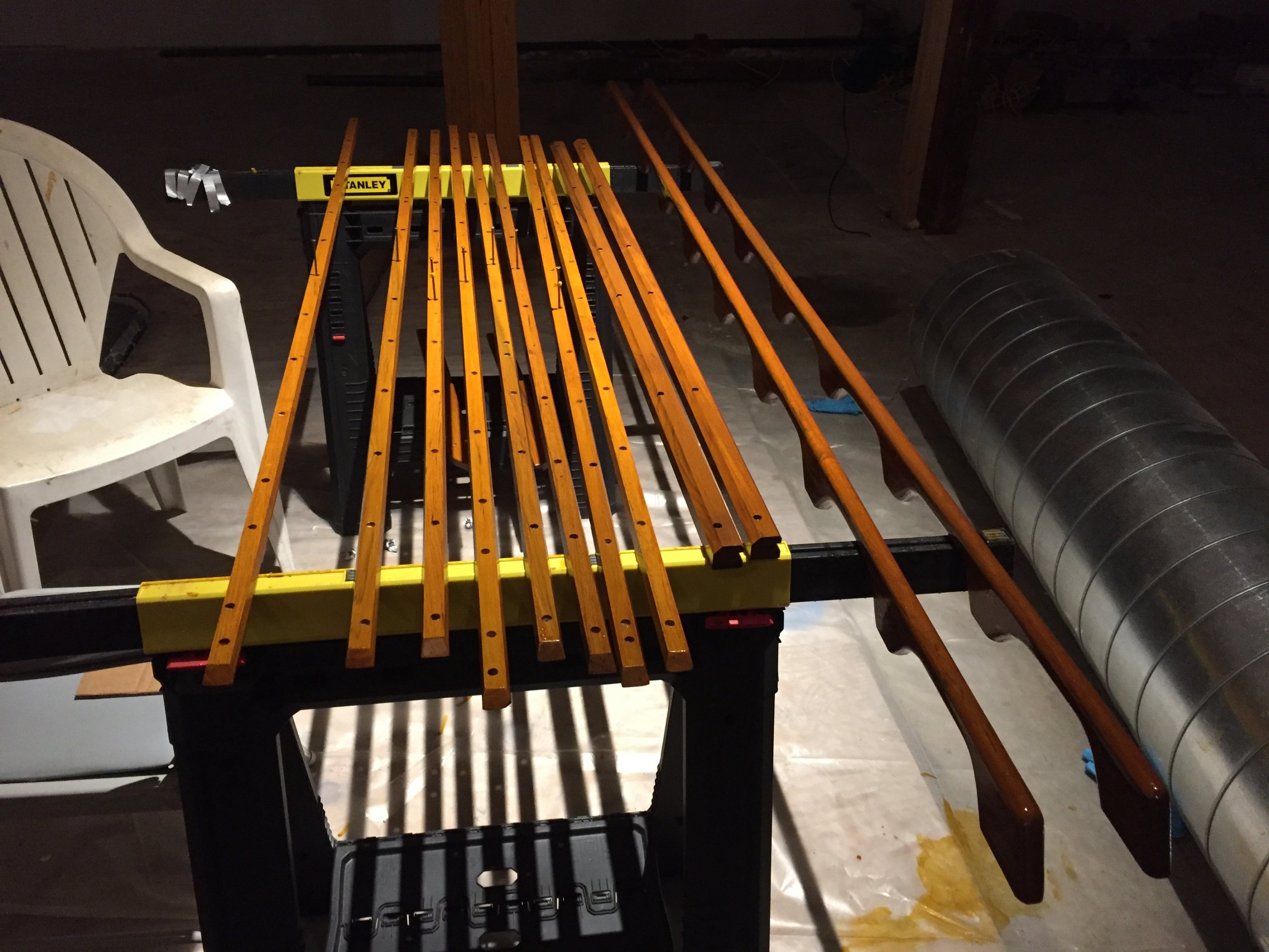

I want to thank everyone for their input. I decided to go with Honey Teak and i put it on off the boat.
It took a few late nights but it looks good. I'll be installing it today and then I will need to treat the bungs on the boat.
