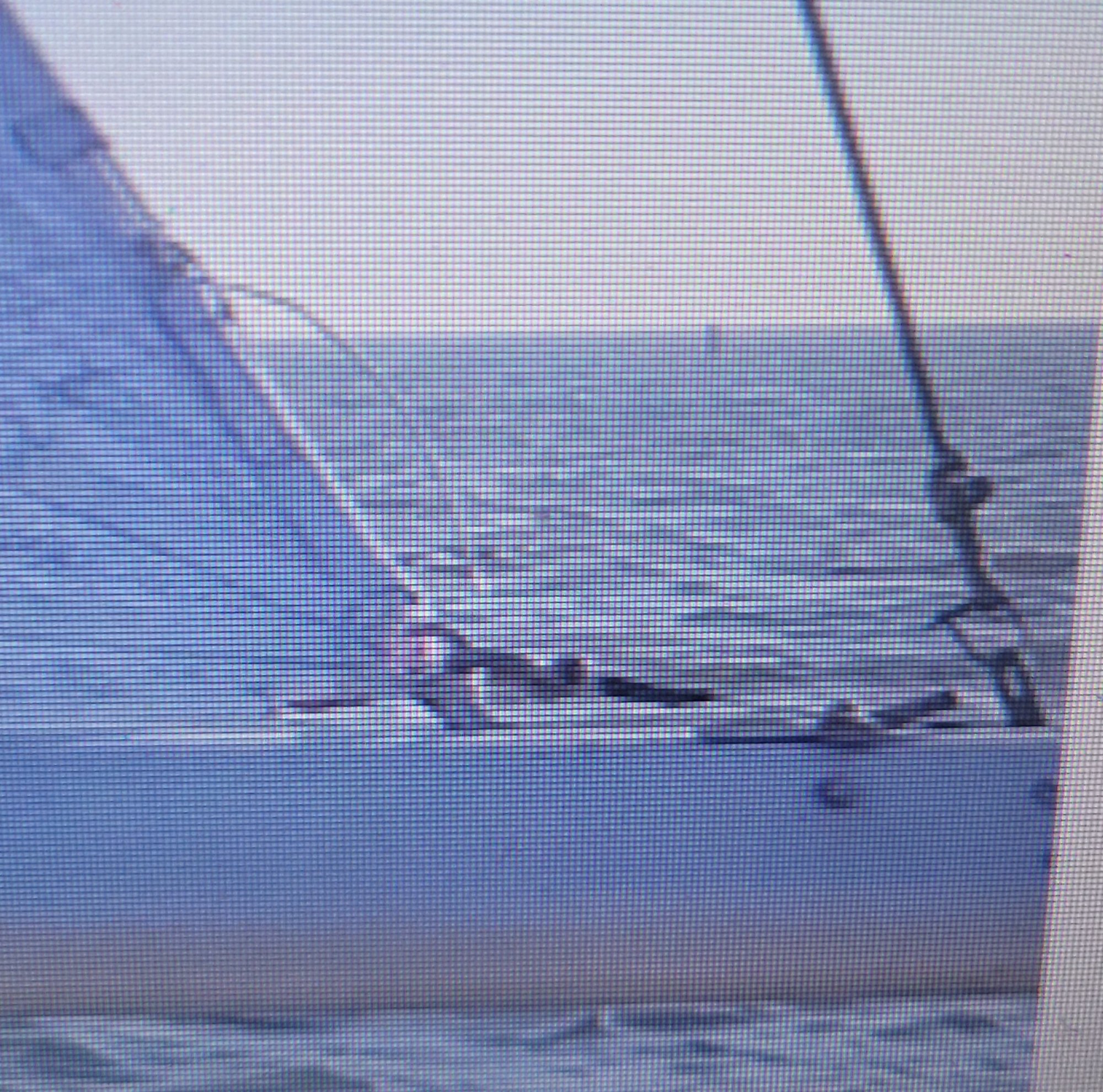

if you make an opening at the end/aft of the boom just in front of the block for the outhaul.
that would make life more simple. just long enough to put the slug in and out. We got the old style sail (not the original)
the outhaul block is all the way at the end of the boom. The left bolt is for the reefing blocks.

Thanks for the picture, that helps.
I was leaning toward that approach, widening the slot near the aft end of the boom, but as I explained in post #25, there is some uncertainty on the exact length of the foot on my sail. The manual for the boat says 13 ft, the sailmaker we got ours from says the last main they made for a 310 was 13.25 ft. I don't want that extra 3 inches to put the slug too close to the end of the slot at full tension. The slug is 3 inches long, so the widened part of the slot needs to be nearly that.
Right now the boat is out of the water on the stands, the mast is off and next to the boat, the boom and stackpack are up on deck, and the sails are in the cabin. No good way to lay out the main and measure it. So I'm going to go with plan B as in post #28, put it back together the way it was, as much trouble as that is to do, and once the main is in place, see where the slug ends up and pick a spot to enlarge the track then.
I don't expect to remove the main very often, not like the racers I know, but improving the installation anyway is a good thing, and an aid to any future owners. Just like the oil change pump mod the previous owner did- it was a bit of fuss to install originally, but I say a word of thanks to him every time I change the engine oil- it makes the change easier, quicker, and less messy than changing the oil on my car.
