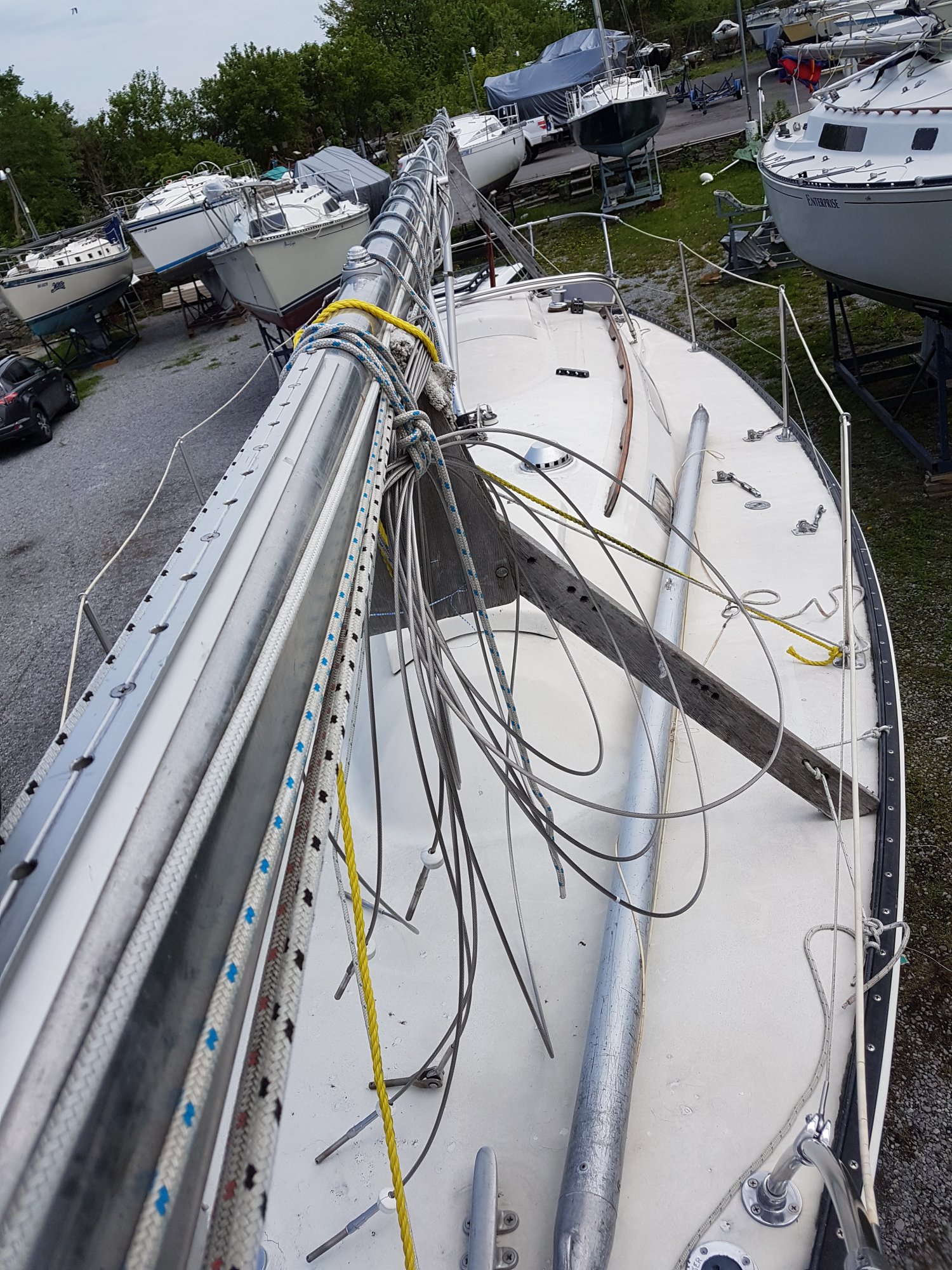

I oversee the process of unstepping and stepping the masts at our club. The weight varies. Double spreaders tend to weigh less than singles. ALL of out masts are laid across the bow and stern rails. However, all boats have their own mast " caddies". These " caddies" are wooden and span the area to extend past each rail side by a few inches. Boats with heavier masts have " caddies" that also use vertical supports that augment the rail and share the load with the deck. Attached is my caddie. I used 2x8's . The top plank just barely makes contact with the top rail and is secured in place with U bolts on each side. The weight is transmitted down to the cockpit combing.

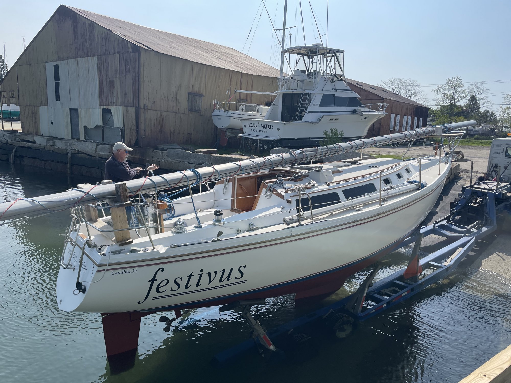

I stored the mast on deck every winter when I had a C&C27. The boat came with very good mast supports fitted to the boat. The supports lasted the 20 years I had that boat so I didn't have to remake them but they look pretty simple to construct. Each support has two pieces of plywood cut to the shape of the mast plus some clearance for padding, mine used carpet scraps, and two 2x4s. There are 2 carriage bolts through each 2x4, so 4 bolts total per support.
These worked very well and I would go with this design again if I was storing a mast on deck. This gives better support and more clearance under the mast than resting on the pulpit and pushpit.

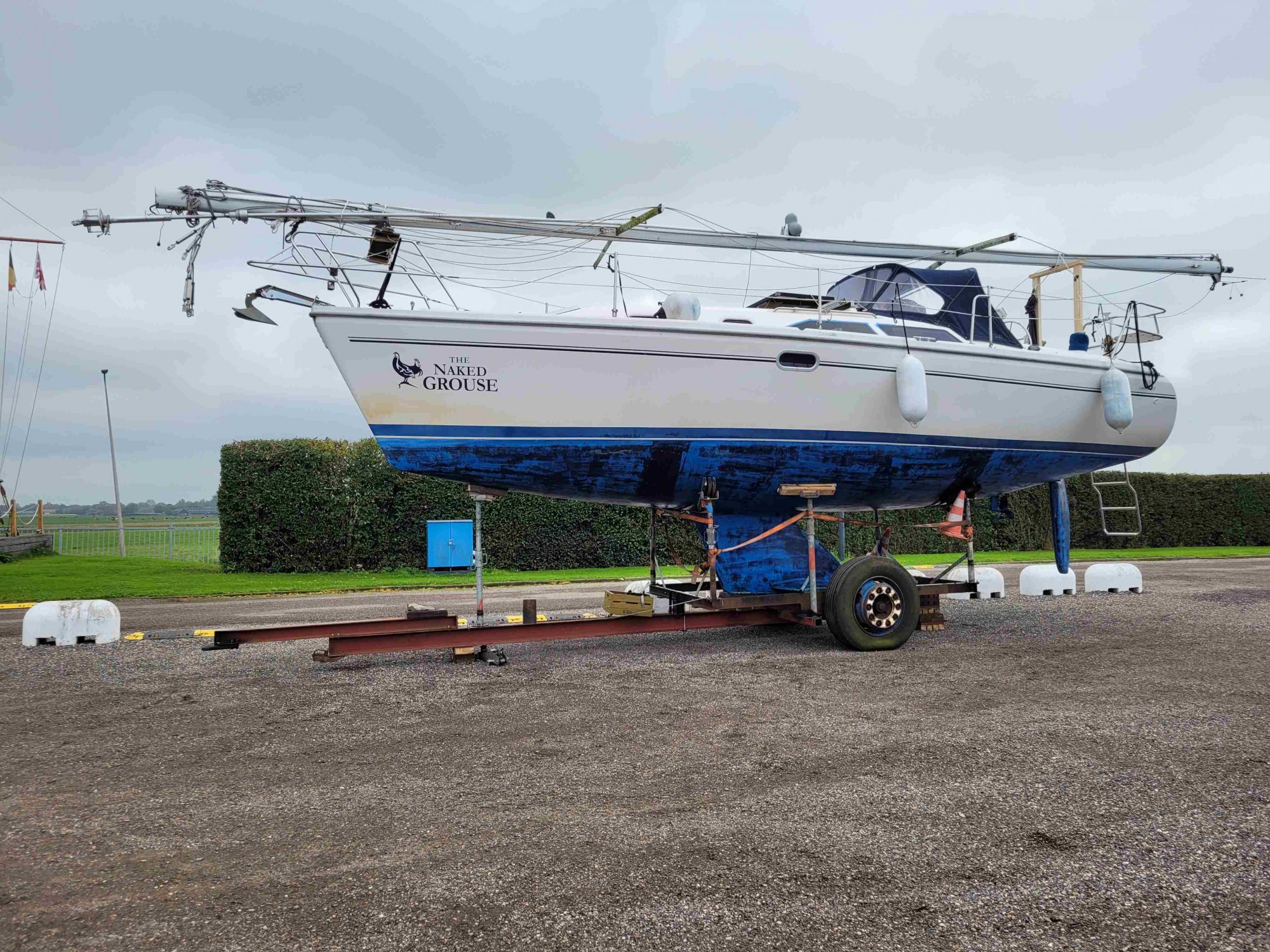

The mast came down easy, wiring was all with connectors at the mast base.
now we can finally clean the spreaders:)
a thirth leg will be added at the mast base.

looks good..... is the port forward bow rail stanchion bent or optical illusion ?

that's no illlusion..... some damage which came with the boat. gonna fix it this winter

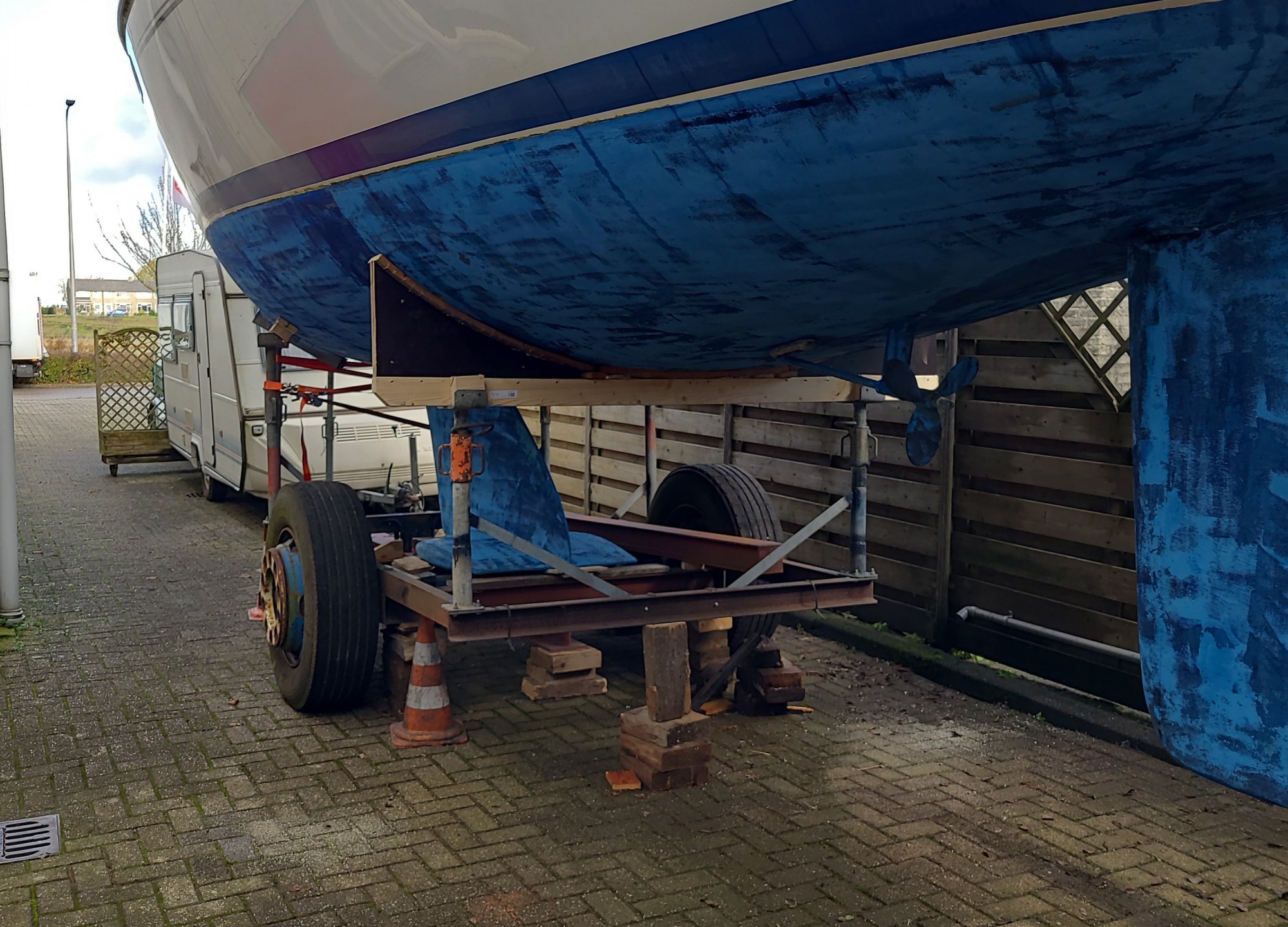

Is this your trailer or a yard trailer? I ask as my C30 on it's factory cradle with four pads suffered some liner crushing damage

this is my own trailer, our boat has had some damage from a pad left aft so now i made a larger pad to supper the hull much better.
did the same at the nose (an extra 7th pad in the shape of the hull.) They were not there on first photo.

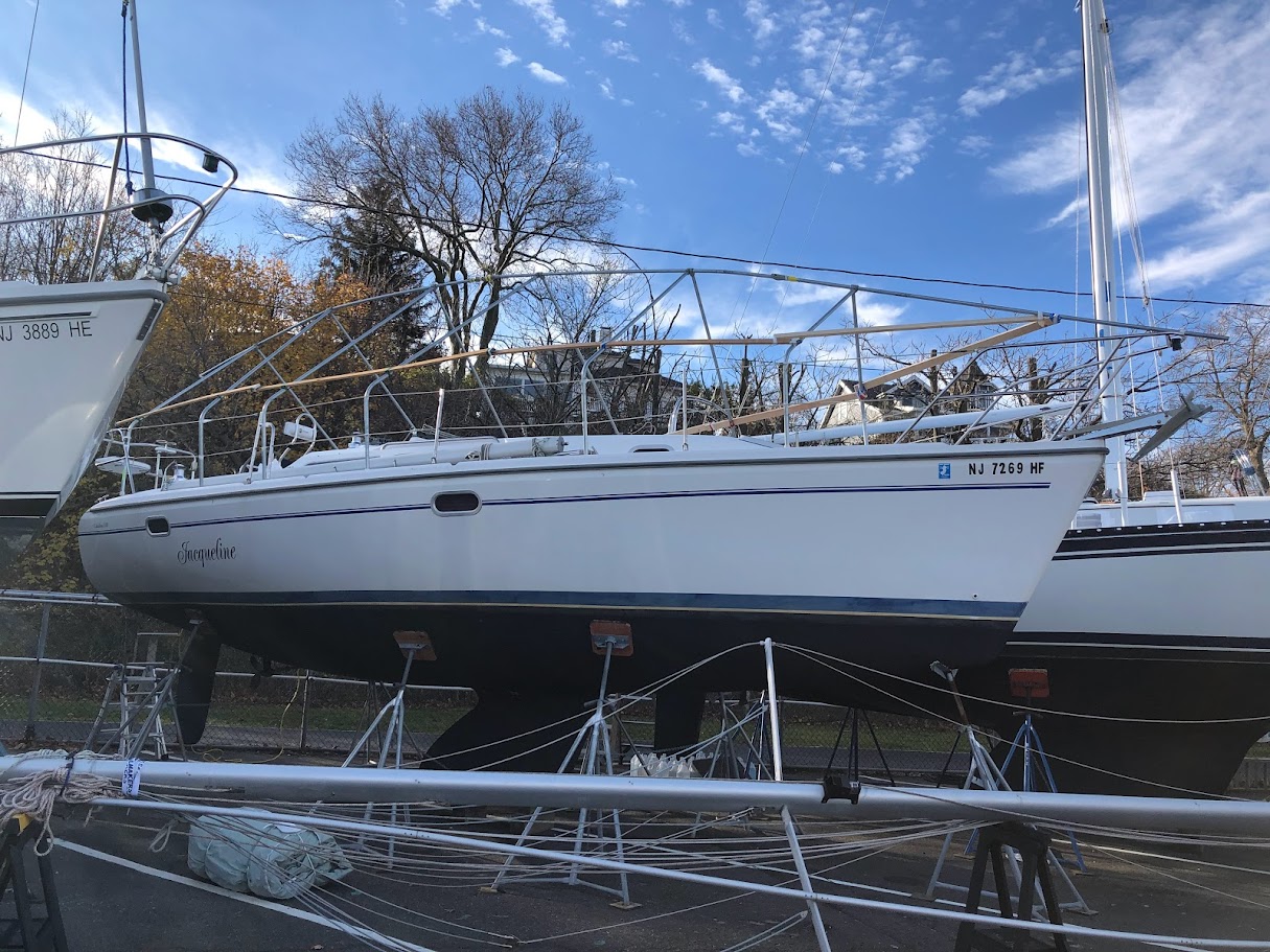

When I take mine down (C310), and I don't do it every year as I have 2 covers - one for mast up and one for mast down, I put it on 4 saw horses. This picture isn't great, but it is the one I could find the quickest.
