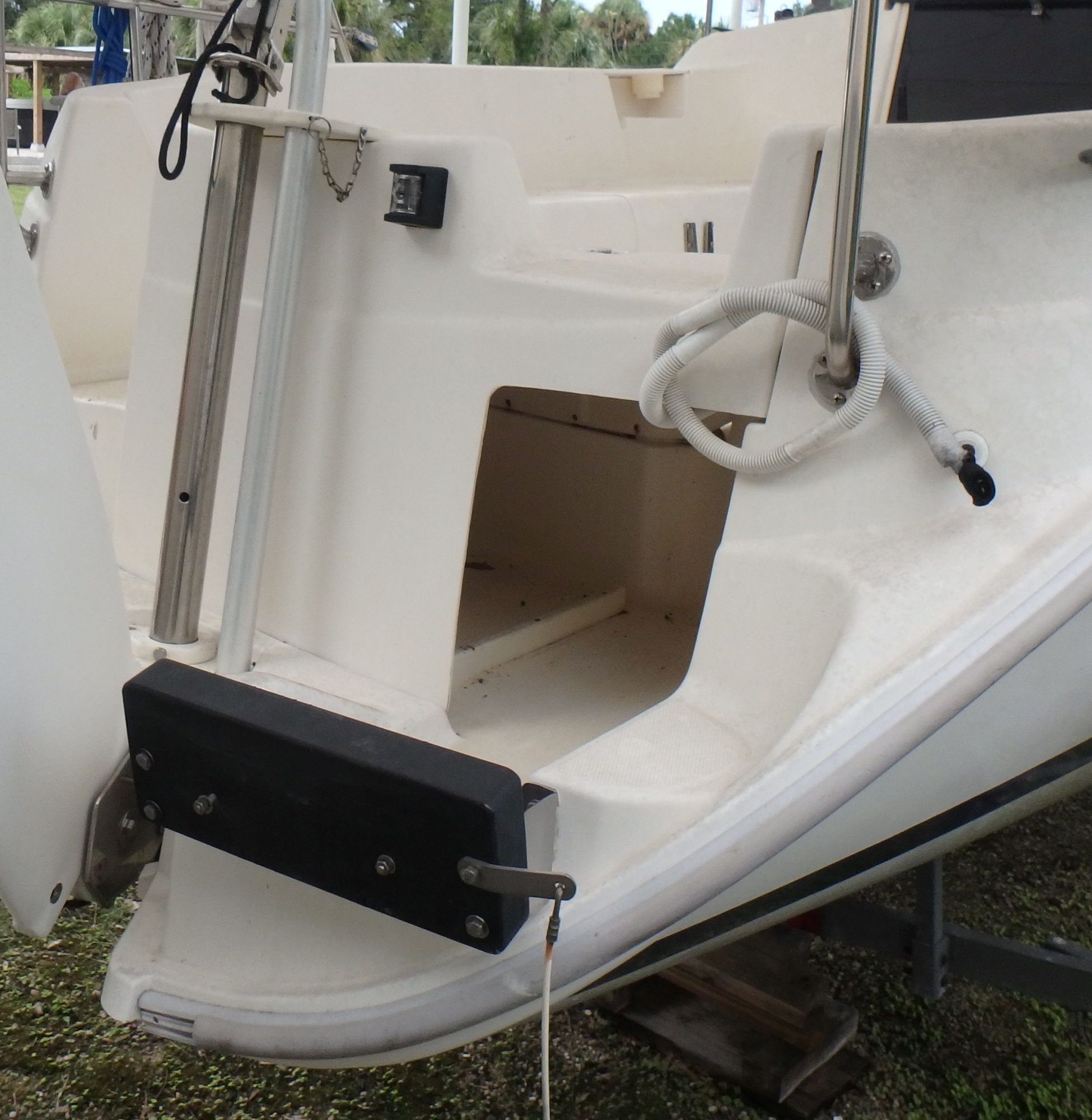

I had an 8 hp Honda on mine and replaced it with a 5 hp Mercury propane. It works fine. I bought the standard Sailboat model without the extra long shaft. The mount on the H240 is very low to the water.Fuel Compartment Transom Opening.jpg

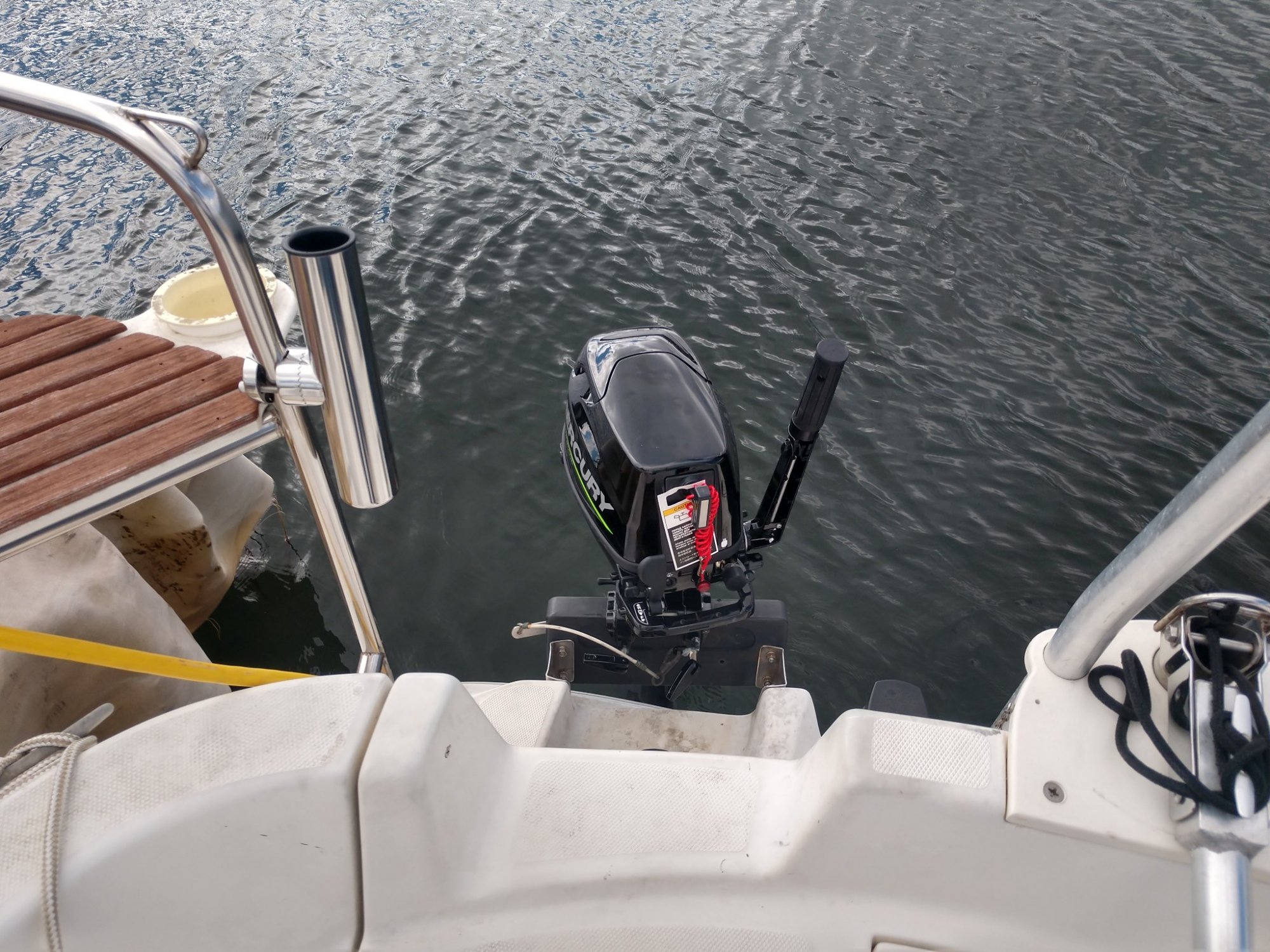

It takes a long arm. I dial up he resistance knob so that is will hold a straight heading and then steer with the tiller. It is awkward when you are docking and need to put her in reverse and turn the throttle. It feels like you are falling off the stern. I have the five HP that they make for Mercury and it is only 57 lbs. It would be ideal if I had remote control that I could use while sitting in one of the stern seats. I could easily dock the boat single handed with my boat hook.Mercury on Transom.jpg
