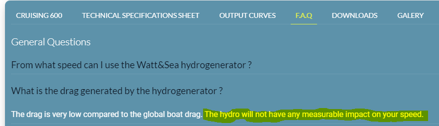

The power has to come from somewhere, no magic involved, and no such thing as a perpetual motion machine. Even at 100% efficiency for every component of the system, all of the propulsive power used would have to be taken away when regenerating. Reality is worse.
A thought experiment: Assuming 100% efficiency for every component of the system, if you drive the boat with the propulsion system for one hour at 5 kt., and your regeneration system knocks a knot off your speed when sailing, you'd have to sail at 5 kt for 5 hours to put the energy back into the bank. Now start increasing the hours of sailing to make up for the less than 100% efficiency of the propulsion system and charging system.
Given the complexity of the system; driving via the internal electric engine; regeneration of power through a turbine driven regeneration system - it is not as simple as your thought experiment.
You have to look at energy consumption via the drive system and then look at what the regeneration system generates. The impact on sailing speed is not a direct one-to-one. Just a snippet from Watt & Sea:
dj
That statement by Watt & Sea is nonsense. I am not kidding, I'm an electrical engineer, and I've made a study of energy conversion. Any bit of energy generated by the hydro charger is taking speed off your boat. Otherwise, it would be magic. Where do you think the energy is coming from?
As a mechanical engineer, it makes perfect sense to me. They have a 300W unit which they say is used on boats up to 35 feet, and there a 600W unit for bigger boats. If you look at the power generation curves for the 300 you will see that it doesn't get to 300W until around 10 knots. You will need a LOT of power to get a 35 foot boat to 10 knots. The C&C115 I race on rarely gets there, only on a reach in 20 knots of wind. I would say you are looking at well over 50hp (probably more than 100hp) to get to 10 knots. My heavy, cruising, 36 foot boat will never get to 10 knots with its 50hp motor. 600 watts is less than 1hp. It is negligible, not magic, just not measurable. You will not notice the speed impact.
In which case, it's a waste of time and money to try to put a meaningful amount of energy back into a propulsion bank with such a generator, no?
