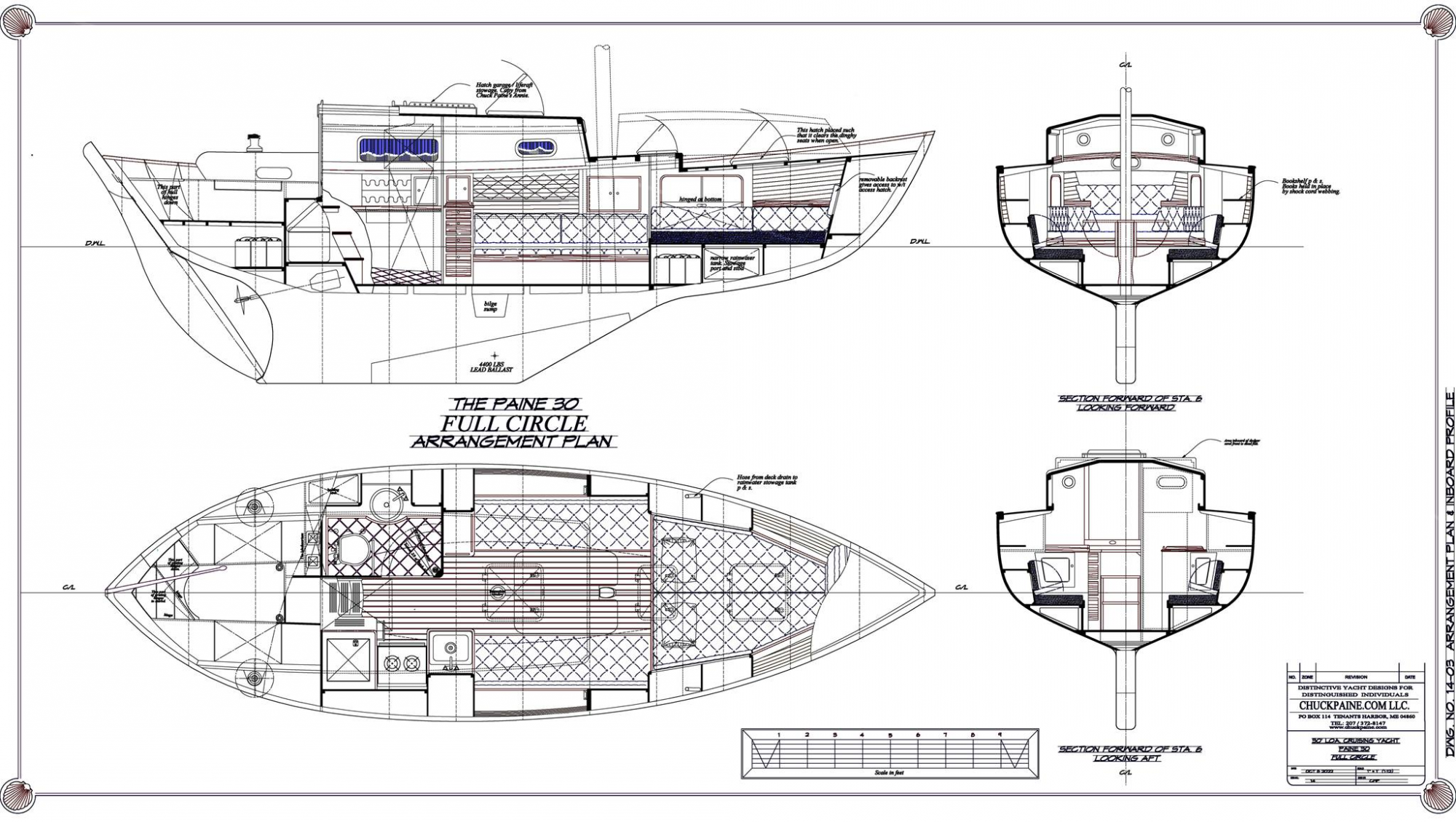

Here's something that might be of interest. Chuck Paine has been playing around with a new design during his retirement. It's a 30 footer called "Full Circle" and it's based on his original design of the 26' Frances with improvements based on everything he has learned since designing the Frances. He said the motor choice was an obvious one to make.

(From web page)
  • Mechanical propulsion is by electric motor. The day of the internal combustion engine is behind us. Charging will be by windmill and solar panels, as well as shore power when at a dock or marina. And you can now buy “contractor’s generators” that can feed battery chargers and when they give up the ghost, buy another at a modest price.​

(From web page)

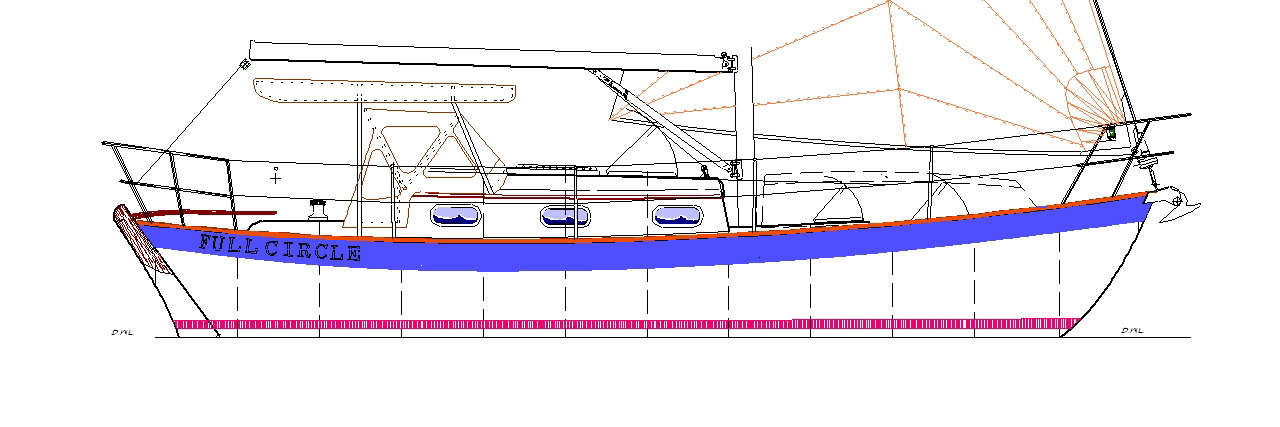

A while back he posted a version of the plans showing a hard dodger. It looked awesome and provided real estate for a couple large solar panels.
Edit: here's the version with the dodger and 3 opening ports.
