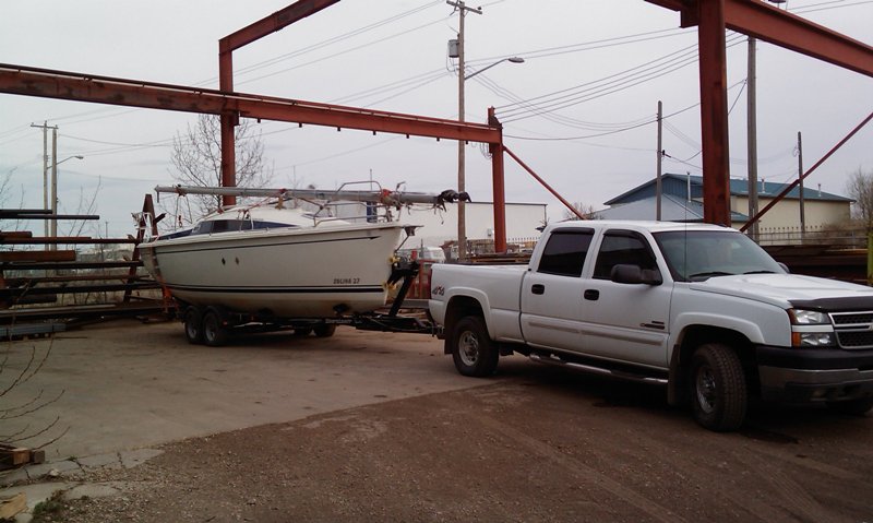

Does the design of the trailer allow to lower the keel with the boat on the trailer (ie parallel down)? I have looked at the diagram from sailboatdata and it would appear that it does not need to be lowered very much in order to withdraw it from the boat. Can you post a photo of your boat on the trailer? 1200lbs is quite heavy and while you would be able to stabilise it with help of another person or two, a wooden jig and at least two hydraulic jacks would be required to lift it back up. When I was inspecting the keel on my boat I was using a crane to lift the boat up and then lower the keel. Although mine does not weigh as mush as yours (about 240-260lbs) it was difficult to handle with two people.
12,968
...Can you post a photo of your boat on the trailer?... .
Here is the best pic I have at the moment. I don't think I could lower it enough to inspect the bushing while still on the trailer.
And I think you are correct, handling 1200# safely will be a challenge. Some sort of jig will be needed.

Another option (what I did) is to drive around your city and visit heavy duty metal fabrication shops. Some of them will have overhead cranes. Second shop I visited did not have any problems lifting my boat up off the trailer and gave me an hour to remove the keel, then two weeks later another hour to put it back. I did not even try to lift the boat myself as she weighs good 7300 lbs. Transaction was sealed with a small cash fee :)

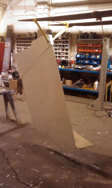

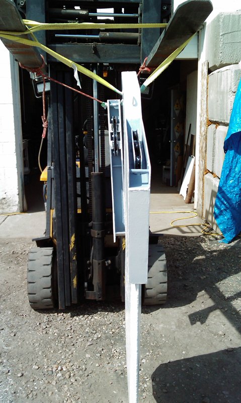

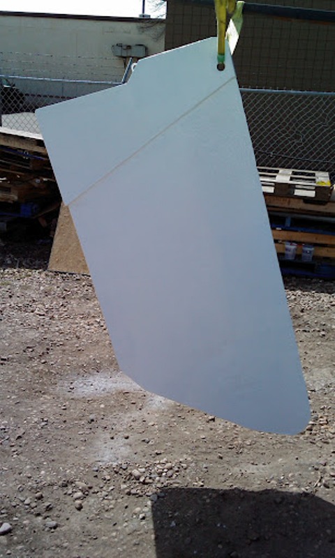

Well, before I even started I have acquired information from the builder on how exactly the keel is attached and the best procedure for the removal. I also got technical drawings of the parts. Then, when the day came, I arrived with two friends to help me out. It took about an hour for the shop staff to position the lift straps properly to keep the boat balanced. At that time I have removed all the nuts for the bolts holding the keel in place and broke them free (ie turned them with a rachet to make sure they will come out easily). It took about 15 minutes to remove the keel, once it was not attached to anything the boat was simply lifted up and the keel stayed on the trailer. Three of us then moved it onto a pick-up truck and the boat placed back on the trailer.
What I did to the swing keel:
- full sand blasting (paid $50 at the local blasting shop)
- treat entire surface with phosporic acid (removes any left over rust and protects from flash rust)
- apply Interlux 2000E barrier to seal the metal
- fill surface imperfections with epoxy sealer and sand down
- re-treat exposed metal (as a result of sanding) with phosporic acid again
- two more coats of Interlux 2000E
- two coats of epoxy paint for super smooth finish
- replaced sheaves and control line
- I did not perform any welding on the keel as there are lead pellets inside secured with epoxy resin. High temperature of welding could cause fire, lead vapour and another hazardous gases. Besides welding was not required.
I did not use anti-fouling paint as my keel sits in its trunk at marina, where it is dark and algae growth does not occur. Some anti-fouling paints will accelerate corrosion, so if you plan to apply anti-fouling paint to your keel do check that carefully.
During the re-attachment the keel was placed in the raised position on the trailer and supported by two pieces of metal. The boat was then lowered onto it carefully and after some fight to get the attachment holes aligned, securing bolts were re-inserted. This took about 30 minutes... Overall it was much less headache than I anticipated.
