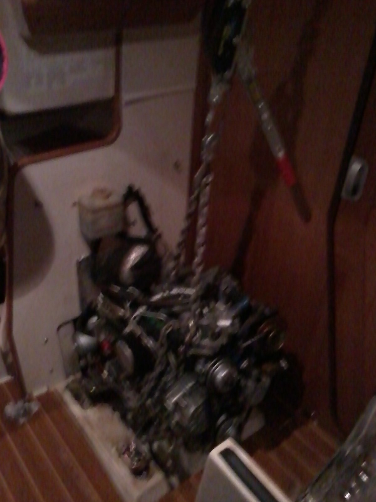

Transmission is easy to pull replace. Coming out I did not have to lift the engine as the damper plate was shot. BUT ;) with the new damper plate in I had to lift the engine with a come-along, a 4x4 overhead and some chain with hooks.:biggrin: Catalina Direct has the ( sic) matching gel coat. Good wet sanding and patience will make it look like new. These boats are super easy to work on unless you are rebedding those f@#$%&! Stanchions.

Would that it were that easy. Disconnect the prop shaft. Ease transmission bolts you can access. Pull the engines off the mounts and lift the engine (come-along on board supported above companionway). Disconnect throttle and gear shift. Remove all transmission bolts and lift transmission as engine is raised.
Putting it back requires realigning the transmission with shaft. When the engine is off the mounts, replace them as well.

@Grichell, normally that would be the procedure, and I did have to loosen the motor mounts, but I only needed to raise the engine 2" to do the deed so I avoided all the rest.
