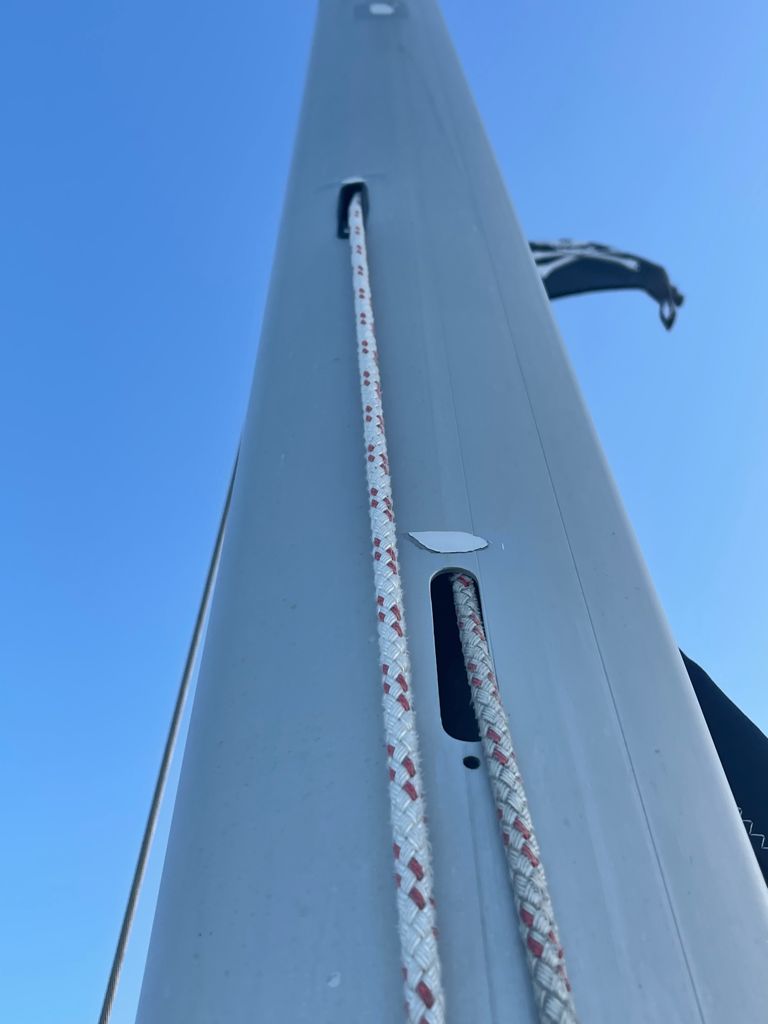

-While going through my checks before we set sail I noticed that one of the plastic "anti-chafing" guides that goes into the mast is missing. Does anyone know where I could find one? (picture below)

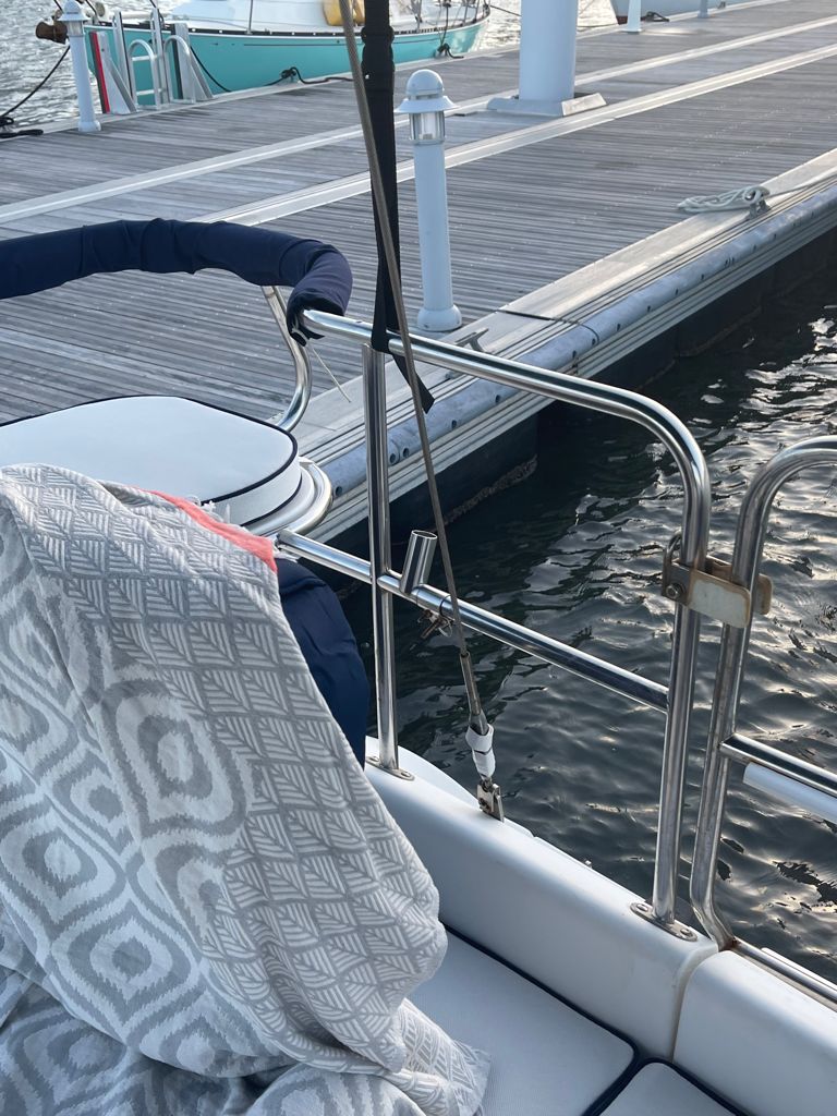

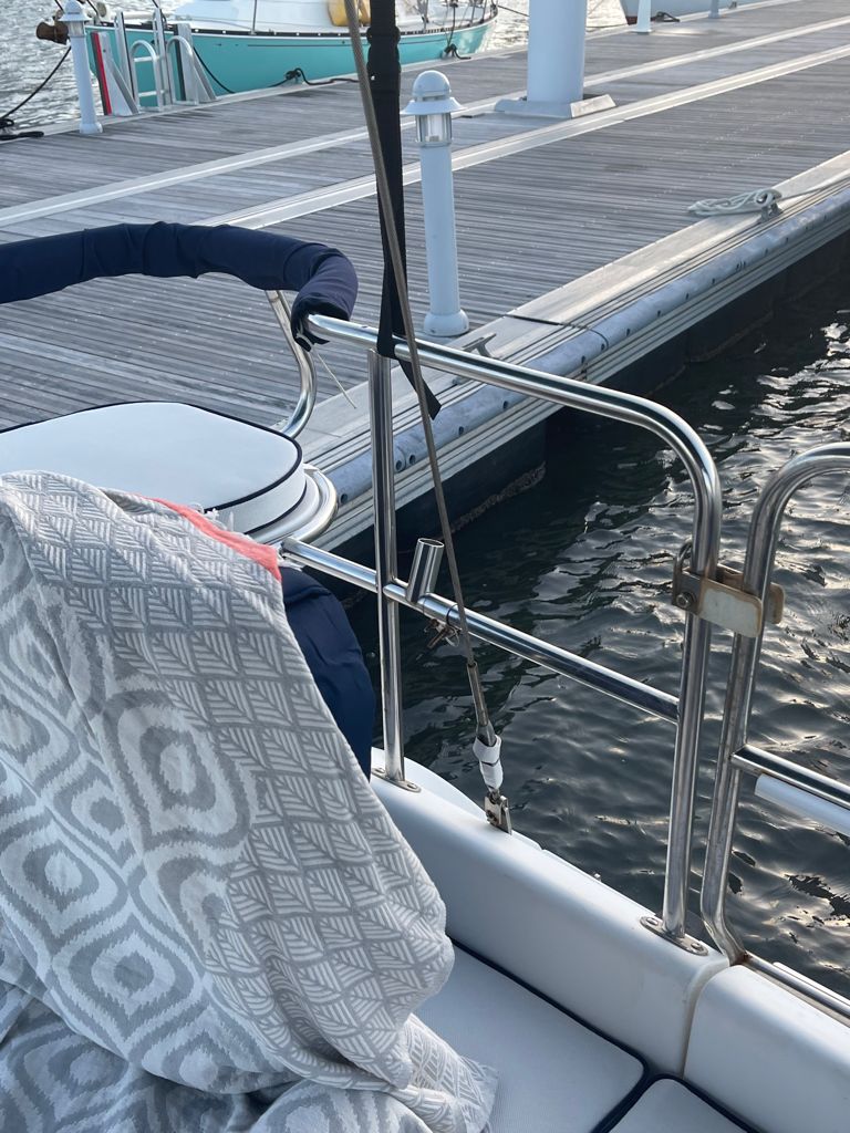

-Also on a less important note, the back rail has what looks like a flag pole holder, is that what it is? (picture below) What kind of pole is used? It has no holes or anything that is threaded, it would seem like a normal wooden pole would fall off in the right conditions.

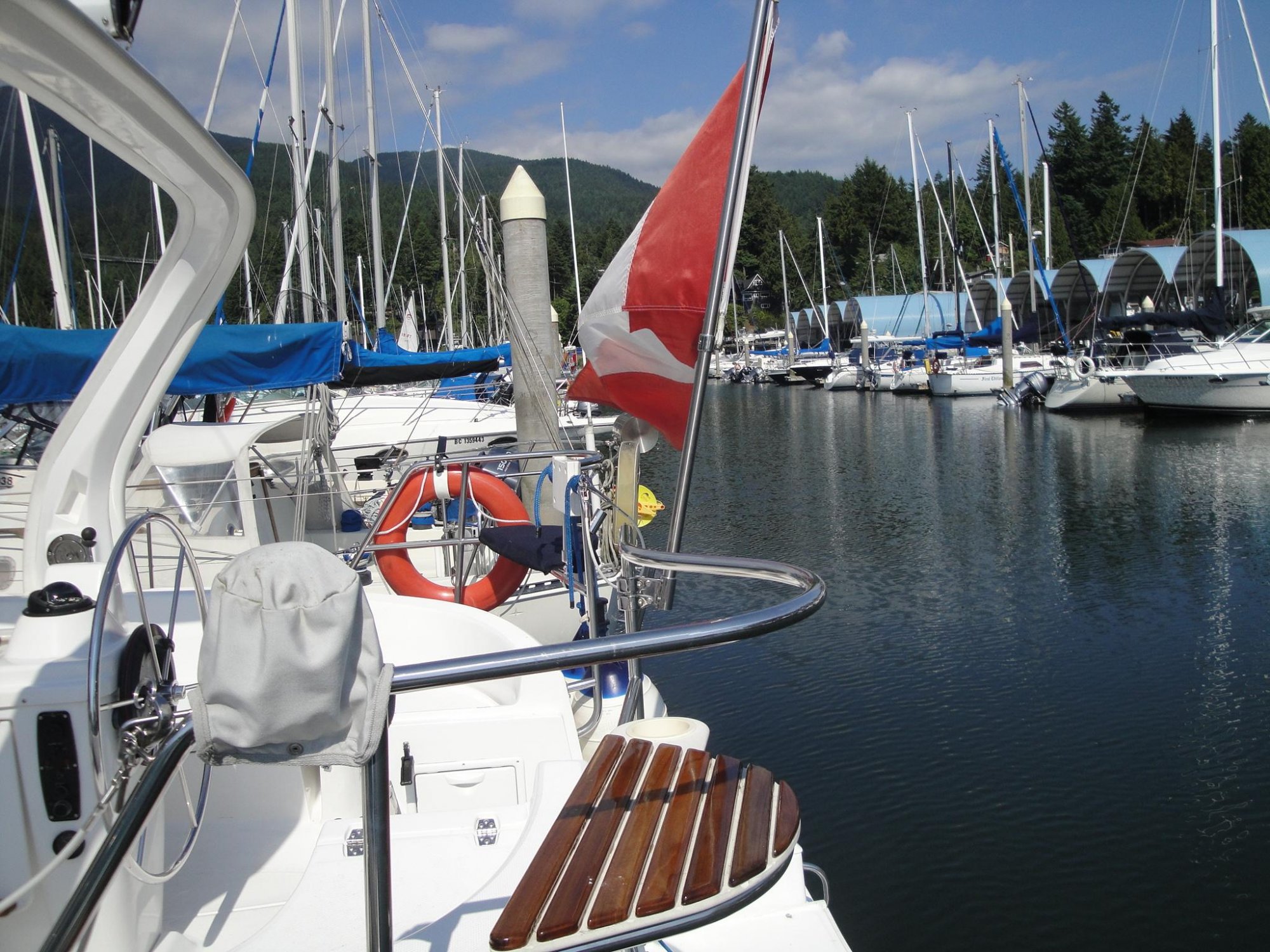

It is a flag holder. I’ve never had a problem with flags falling out. I use an oversized dowel which I turned to put a knob on the end and then sanded the base so it would fit into the holder. I stained it and coated with polyurethane.
I’ve also used it for committee boat flags
If you get a staff that is a sloppy fit, just wrap tape at the base.

Great, what I will likely end up doing is putting tape to the wooden flag pole I currently have as it is a little loose!

The halyard exit plates on the mast were plastic, replacements in stainless available, CD didn't have them at the time so I got them from Rigrite. Called CD and they ordered some, cheaper then other sources, check for size, these are the small ones, others are 1 inch longer.
Halyard Exit Plate Riveted, Stainless C-320, C-350
If you use the stainless be sure to isolate the steel from the aluminum. You may never want to remove them, but it’s a good idea, nevertheless.

Who is the manufacturer of the mast? I would prefer to remain with the current ones. I don't think the ones that CD sells are the same, as the mention that the original ones are clipped in, mine have a rivet on the bottom.
Looks pretty spindly. If you think it's solid enough, they are "usually" intended to use 1" SS tubing and make your own flag pole. The same stuff as your SS push and pulpits.

Isomat, The clipped in thing is in error, originals were the plastic with rivet, stainless is same maker and size.
Isomat Exit Plates
