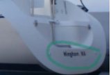

Also I saw some vertical cracks on the gel coat on the bottom of the stern, I've attached a picture for example of where these are. I assume PO back up a little too fast into a slip perhaps? Hope this turns out to not be an issue since I've looked for any humidity inside but visibility is not great...
