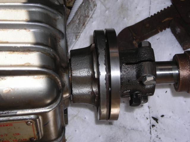

The damper plate does not feel the forces due the a miss-aligned drive shaft, only the output bearing on the transmission. I believe the damper plate failed because it was too stiff for the movement required to smooth out the periodic rotational accelerations and decelerations (torsional vibration) caused by idling a low cylinder count lite flywheeled engine. Basically the flywheel does not have enough mass to absorb these vibrations.
My transmission's output bearing and seal appears to be still OK. Over time these vibrations started to wear the contact points between the collar on the damper plate and the transmission spline eventually striping the collar out. Please refer to:

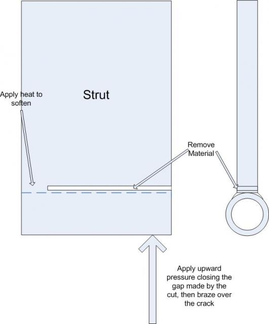

Another idea is to make a cut, but not all the way through leaving the front 1" or so in place. Then heat it and bend it back into alignment by putting upward pressure on the back of the bearing with a hydraulic jack. This way I can control the position of the bearing and get it just where I want it and then have the crack brazed over. See the diagram.

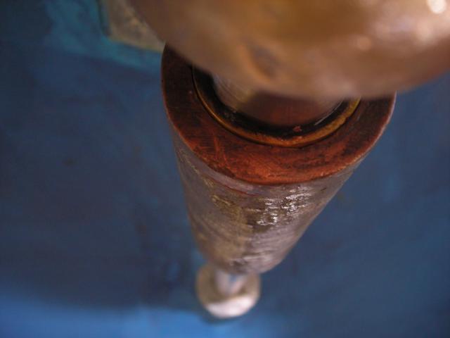

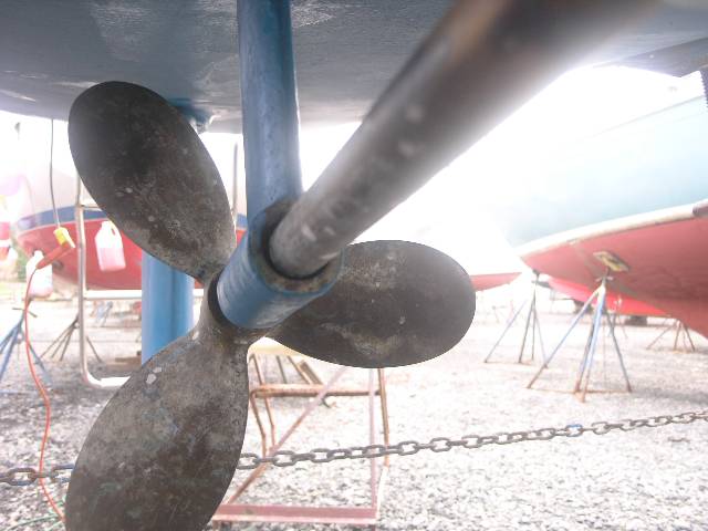

I dug up these older pics.
The first was from the survey when we bought the boat. The surveyor only grabbed the prop and wiggled up and down and side to side, and then checked for anything bent by rotating it. He never inspected to see if the gap around the bearing was even.
The second photo is after I raised the engine to stop the shaft from slapping the tube. It did not change very much, and is the best representation of what I'm dealing with now that I can show.
Whether or not I can get the engine any higher by shortening what I believe to be excessive length of shaft tube inside the boat and maybe beveling the top inside ( if I think I can get away with it without affecting the integrity of the tube), I don't know. Also not sure how much of this alignment issue is as a result of being on the hard. I'm going to raise the adjustments on the rear jack stands a little and see if it changes.
Again I will take current pictures the next time I'm up.

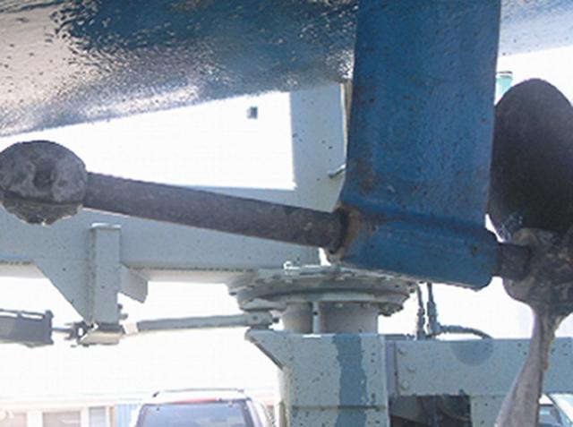

It doesn't look all that bad now
Here is how mine looked and what the alignment looked like on the hard. It got significantly better in the water. The shaft seems low at about 7 o'clock aft, which is exactly how it was before I replaced it, excepting for perhaps a slight improvement (off center by say 1/16 instead of 1/8).
During the alignment another boat owner talked me into dropping the back of the engine about an eighth instead of shimming the front. The engine is currently at the top of the mounts in front. That is what I attributed the slight ringing I had initially, which disappeared and has not returned. I will be at the boat on Thursday and see how it looks this year. I will inspect it, but if there are no apparent issues I will likely leave it alone for now. At some point I will need to address the mounts, but I think I will leave that for a future repower.
