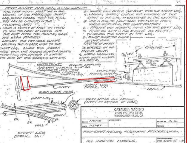

After successfully replacing my cutlass bearing (slid in with relative ease after thoroughly giving the strut a brush job with the drill and putting the bearing in the snow and warming up the strut with a torch), it is now quite apparent that the strut is way out of alignment and this was the real reason for the wear on the original bearing. The settling of the motor due to worn mounts contributed, but most of the problem lies in the incorrect alignment of the strut. How much of a PITA is it to align the strut? Looks like it is glassed in to me. When I inseart the shaft using soapy water it is crushing the top aft of the bearing and the bottom forward and is so tight I can barely turn the shaft by hand. This all while keeping the shaft at the top of the shaft tube in an effort to relieve the pressure.
BTW the Moris "BlackFish" is advertized with a 1/32" wall thickness, and it actually is 3/64" So it seem both manufactures have their specs incorrect. I can live with the 3/64" (.046) but not the .07 that the Duramax "Back" was. The Duramax literally had no rubber in it.
So far I'm very disappointed with the quality of this C310. I can't believe that the factory shipped this boat with the strut so far out. Also the mess I have had with the use of the R&D damper plate which failed after 500 hours and the damaged it caused to input spline of the transmission shaft. I'm F!@#$%ing pissed and will never buy another Catalina or production boat again!!! No quality controll!! Are you listening Catalina!!!
I will try to take a pic next time I'm at the boat.

Thanks for the quick response Maine!! What are the chances that Catalina will honor this? I doubt it after 9 years. Might it be easier to raise the shaft tube and engine? In fact the shaft hits the inside end of the through hull tube while only being in the center on the outside of the tube, so it would appear that the tube is cocked forward end down as well.

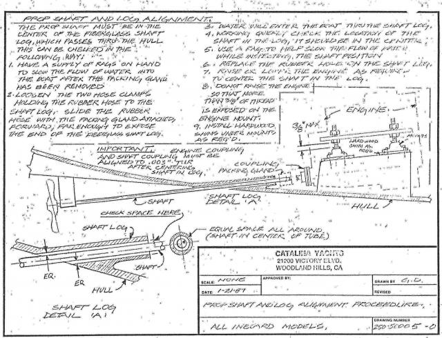

I'm happy you are taking the leed on this project.
If your boat is out of water it would be nice to have pictures of prop strut and shaft entering and exiting log shaft before fixing.
I think the final adjustments to align the shaft to the engine should be when the boat is in the water, mast is tuned and engine not running:laugh:.
Where is it binding in this sketch?

Paul, attached is a ROM of the alignment issues. As you can see I'm getting squeezed here. I will take some pics the next time I'm up.
This thing went out the door with a squeezed bearing, than the engine ran miss-aligned until it wore away the Natril on the top aft and bottom forward. It may be cheaper in the long run to do the same and after 500 hours change it again. In fact if I keep the alignment as high as I can, it may last longer. I also may be able to get the alignment closer by beveling the top of the inside of the tube.
Am I talking myself out of doing the right thing here, or is history telling me I can get away with it for another 500+ hours?
