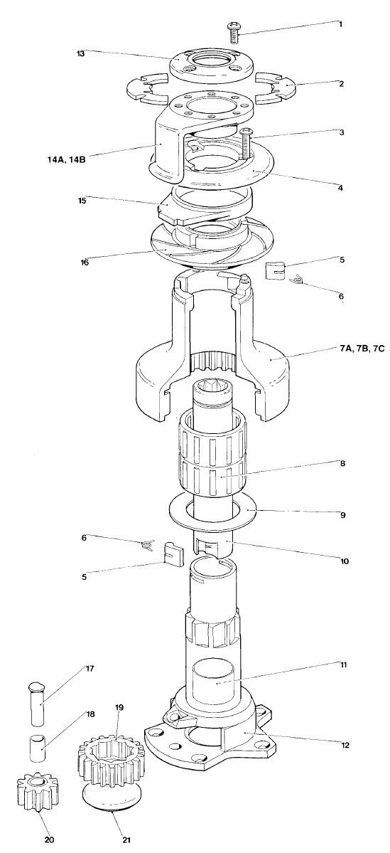

Ok...I know the title of the post was click bait, but I'm hoping someone can help.
I have Lewmar Wavegrip self-tailing winches. The 16ST has a broken stripper ring. The ring collar is intact. The triangular tab broke off so that the tailing line doubles up on itself and fouls in the jaws when I grind the winch. And I can't find a source for a replacement. Well...I did find P2 Marine website which will "manufacture" a replacement for about $200. Does anyone know a more economical source? It is part 15 below. I think the part number is 15000459. Googling didn't find much. I sat on hold with Lewmar for a while without reaching an agent and an email to Lewmar tech support last Thursday has gone unanswered. Thanks for any suggestions you might have.

Thanks to the folks who posted links to Lewmar repair parts. My concern is that those links are for parts to the Lewmar Ocean series ST Winch. Which is their more current line. I have the Wavegrip ST produced before 1991.
I'm fairly confident the parts aren't going to be interchangeable.

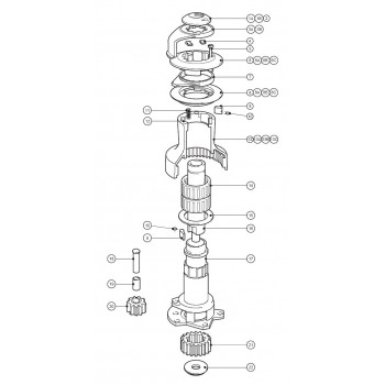

Here's a drawing of the Ocean Series for comparison:
The parts don't look the same to my eye. The dimensions aren't given here.
Nov 8, 2010
11,386
The two series are totally different. The Lewmar ocean winch series are works of art. They will end up in the sailing hall of fame. Launched in 1995, they are still current and state of the art.

Did call and waited 45 mins this time. I learned the winches have been discontinued for decades, the tooling is lost for all time, and they will custom machine a replacement for $198. That basically means look for a winch being sold for parts or save up to buy a replacement that has spares readily available.....
