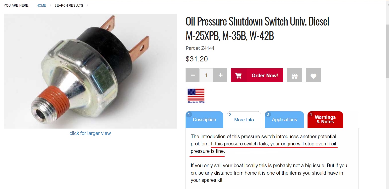

Most unusual. According to Catalina Direct, it also shuts down the engine in the event of low oil pressure or switch failure which you don't mention.
I can't help wonder if both you and the OP have a different type of pressure switch rather than the one recommended for the Universal M25XPB. Neither of you have problems with the engine shutting down and the switch only has TWO contacts. Maybe Catalina changed their mind because of the engine shut down problem.
I honestly don't know.
If I remember correctly, the M25XPB has an oil pressure switch, not a low oil pressure switch. When you hold the "ignition" key on, it provides power to the lift pump and silences the oil pressure alarm. When the engine develops enough oil pressure, the pressure switch provides power to the lift pump and silences the alarm. If the oil pressure drops, the lift pump shuts down the engine and the low oil pressure alarm is engaged. This is a normally open switch, not normally closed.
Unfortunately on the C310, the engine will often run without the lift pump working, since the fuel level is sometimes higher than the lift pump.

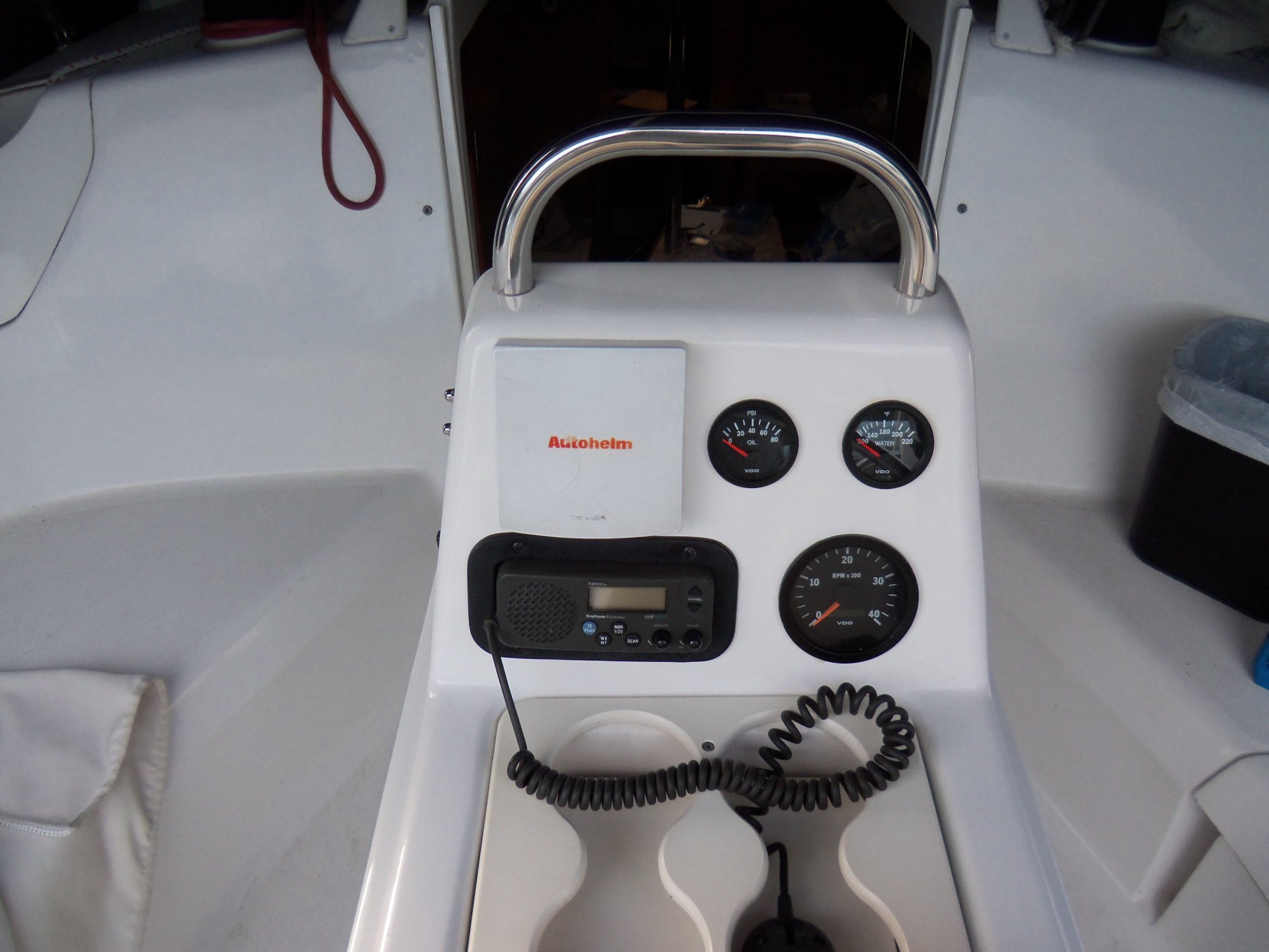

I am going to have a mechanic look at it just to confirm that is the issue and make sure there isn't something worse going on. Will share what he says. I am thinking I will add an oil gauge and sending unit because I would like a more accurate and sure way to know I have adequate oil pressure. I on the Catalina Direct site that many people put the gauge where the battery monitor gauge is now as there is also a battery gauge on the main panel.
24,871
Top two battery gauges from our SBO Marine Electrical Engineer.
If you want to know amperage or energy into and out of the bank you'd need a battery monitor such as a Balmar SG200 or a Victron BMV series. An accurate digital volt meter, sensing directly at the battery terminals, can also be a good "bottom voltage" guide (12.2V).

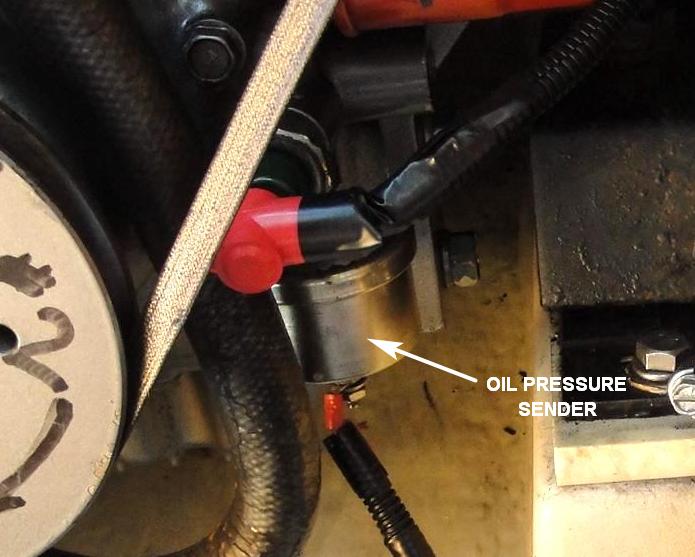

That will eliminate all head scratching as loss of oil pressure is the #1 destroyer of your engine. The presure gauge will answer a lot of questions immediately. With engine temperature, at least you've got a minute to consider what's going on.
The pressure sender is simple to install on the engine. Running the wiring can be a little more painstaking.
Keep us up to date.
