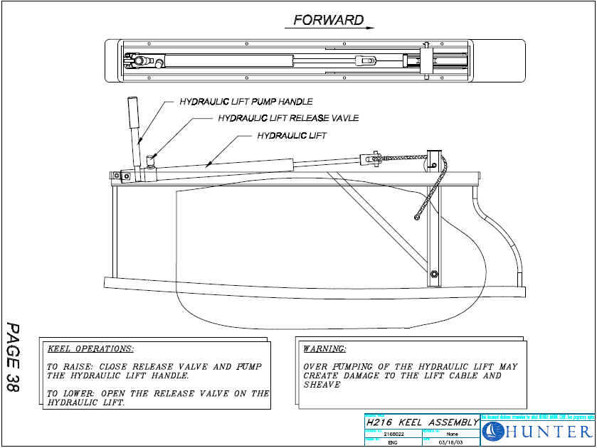

Here's the diagram. To inspect the pivot, would you need to remove the entire assembly?
Thanks Doug. Yes, I've learned the hard way (when one time the cable snapped!) that I would have to remove the entire assembly. But still, I'm thinking that might not be necessary, since this is a 'swinging' issue, and I suspect that everyone must have faced it at some time?
