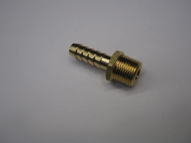

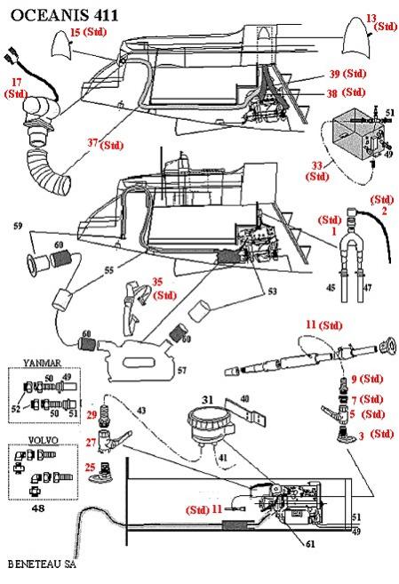

Hi all just had an email from Beneteau Uk they have found the replacement fitting kit but it will take 4 weeks or longer to deliver it from France!!!! Beneteau UK have been very helpful and have forwarded a diagram of the stern tube set up but the part I need is not identified by any number. But Beneteau France have said the part number for the replacement fitting kit is PN 460646 pictures are below. (repair kit 460646 “STERN TUBE FITTING REPAIR KIT” 47,36 €)
I don't know if this will be of any use to anyone but thought I would put it on here just in case.

Also, after you receive the kit, let us know if it is the exact same fitting as the OEM fitting that broke. The photo on the left appears different in size as compared to your fitting that broke; the photo on the right appears to be the correct size fitting. Hopefully you will receive the correct fitting. As I mentioned previously in an earlier post, I recently bought a kit from Annapolis Yacht Sales. I spoke to the parts manager and she told me that they had a US manufacturer duplicate the OEM fitting. When I received the kit, the fitting was not to the OEM specs, different size as well as thin wall brass. I hope that your source has the OEM fitting, if so I will definitely order a kit. Thanks for the update

That fitting looks as if it is a fairly standard male pipe to barb fitting. Probably not much bigger than 1/4" NPT. Might be even smaller.
I just looked up pipe to barb fittings on eBay and there are several sizes shown, including some metric sizes. Probably brass, bronze may be harder to locate.
Prices are $10 US or less for more than one in a package. Probably cost more than that to ship to the UK

I think that the fitting size is 1/8"mnpt x 1/4" or 3/8" hose barb. Was looking at another site and the nomenclature for these fittings is a bit confusing. On the mnpt side, the measurement is the internal diameter of the fitting; on the hose barb side, the measurement is the external diameter of the fitting (internal diameter of the hose).
Another thing about this fitting, when I removed mine, last year, I used a pair of vise grip pliers as there was no hex between the mnpt side and the barb side; it was constructed more like a nipple. Without the hex, it allowed beneteau to build up around the nipple with the "special epoxy" fillet to give more strength. When I removed my fitting for inspection, the epoxy remained in place and I was able to reinsert the same fitting without difficulty.
