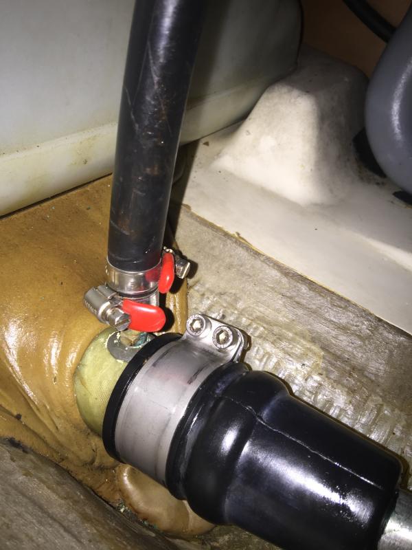

Unfortunately I don't remember the size but even if I did it's probably not the same. My boat has a 25mm shaft and yours, I guess, it's 30mm. So if the shaft tube on yours is also bigger then maybe a different size fitting is there (this is all guessing of course).

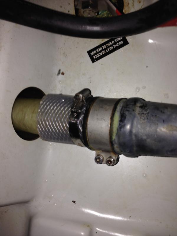

I remember using loctite. If you see my photo attached the fitting is screwed directly on the grp shaft tube. Not actually on grp but there's a little piece of metal there.

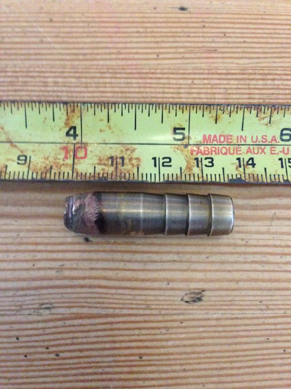

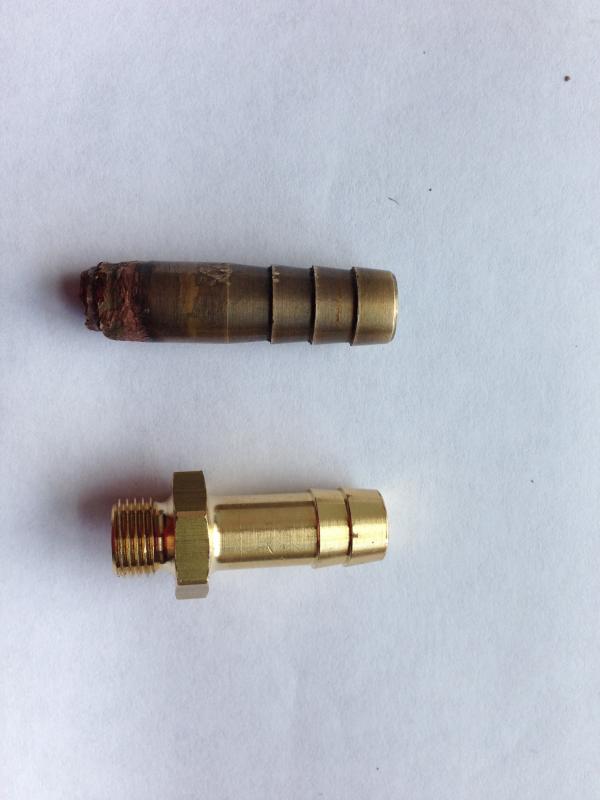

I too have been trying to contact beneteau for spares for this part but to be honest hasn't been that great. I have also tried most of the chandlers in the area with no success. I also tried a local hydraulic suppliers Armarda in falmouth and they did have a fitting but the outside diameter is 10mm apposed to the 8mm O/D on the little bit of thread left on the fitting that has snapped off.
I hope I have managed to upload the photo to show you the fitting that snapped off (top) and the new one I got from Armarda. The main problem I have is the new one is made of brass and not bronze so will not be as permanent as I would like. I don't know if it would be possible to glass in a grp or a glass filled nylon hose barb connection so this would be a permanent fix, also I have concerns if it will be strong enough. I will do further research to find out. Thanks very much for your comments Big easy will keep you informed of my progress. Still waiting for a slot to have her lifted out, but should be attempting the repair in the next week or so. I have just added another couple of pictures to show you the temporary repair to stop her leaking and a better picture of the hose barb that snapped off.

Yep, that is exactly what my fitting looks like (sans broken threads) on an '06 Ben 343.
Can't find anything that is even closely resembles the OEM fitting. Somebody out there makes these fittings and they should be available. I wouldn't have a problem replacing it every two years on haulout just to ensure that it isn't corroding, with the potential for snapping off as yours did. Very easy to unscrew it, place some sealer the new fitting, and reinstall---if the fittings were available.
Here is a link to the photos of the "beefed up" stern tube following additional fiberglass layups on a Ben 423 stern tube. Shows a new SS fitting that has all threads engaged in the thicker stern tube. Nice work. http://groups.yahoo.com/group/Benet...de=tn&order=ordinal&start=21&count=20&dir=asc
