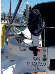

This question came on this thread with guidance of what others have done Rail Mount for Outboard Motor | Sailboat Owners Forums. 85 lbs is a very heavy motor and would not want that much weight on my stern. I use and Edson motor mount designed to hold a 100 lb outboard motor Edson Marine: Stern Rail Outboard Motor Mount - Aluminum for 1-1/4" Railings (521-125AL) to carry my lightweight Torqeedo electric motor (without the extra weight of its battery and control arm).

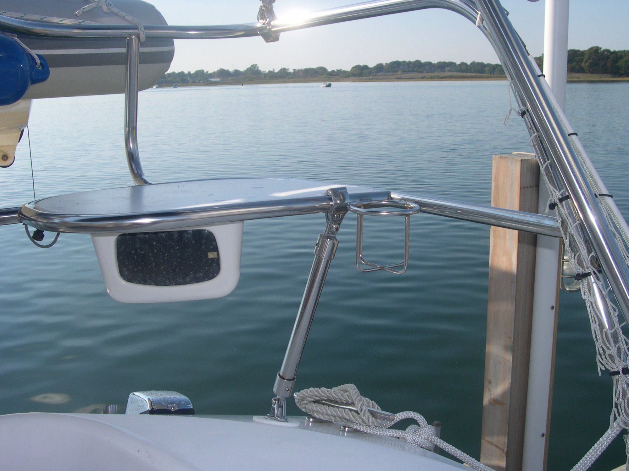

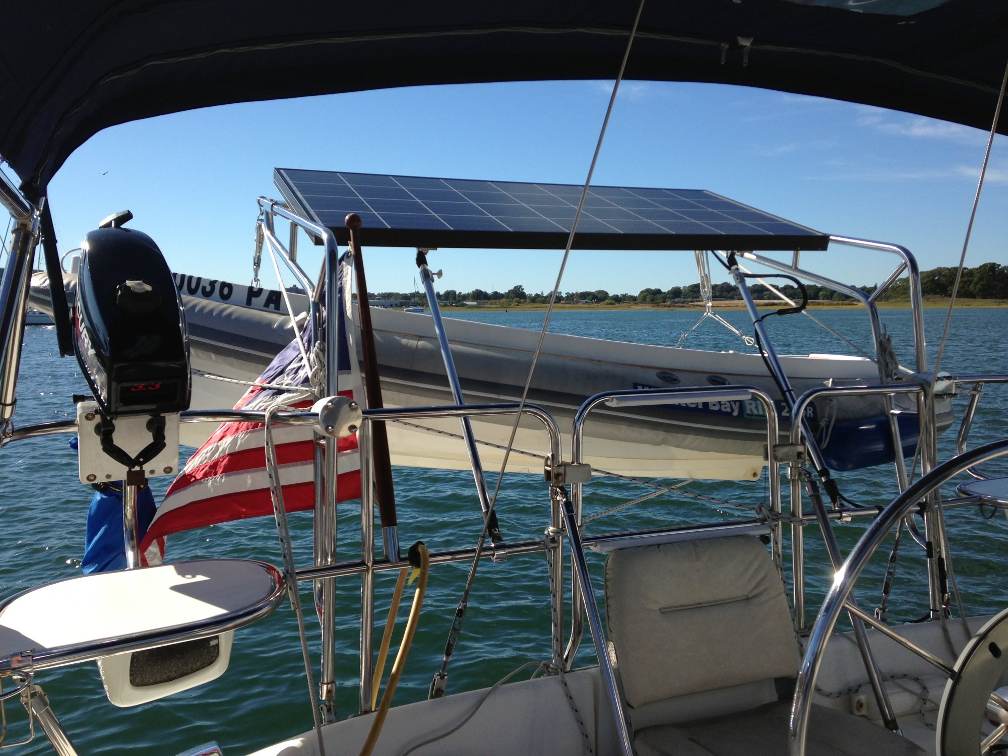

I installed a brace for the perch seats. There was some sagging, since they are the most popular seats in the house. The outboard lived on a typical motor mount, which is now home to a Torqeedo, which, as mentioned, is very light. I also braced the stern rail to take the weight of the davits/dingy and solar panels (two, now).IMG_0199.JPGDSCN1239.JPG

We've carried our 9.9 Tohatsu on the stern rail for several years without trouble. Our is on the port side and the pad is as close to the seats as possible. It's a challenge to mount and demount a ~90lb motor. We use the main halyard as protection against a drop, and my wife tends the halyard on the winch. No crank necessary.
When taking the motor off with the dinghy tied close to the stern, we pad the propane locker lid. I lift the motor while wife takes up the halyard slack. I rest the motor skeg on the lid while I reposition myself higher for the lift onto the rail. We reverse this when mounting the motor on the dinghy. As usual, it's all "ankles and elbows" placing the motor in a floating dinghy.
