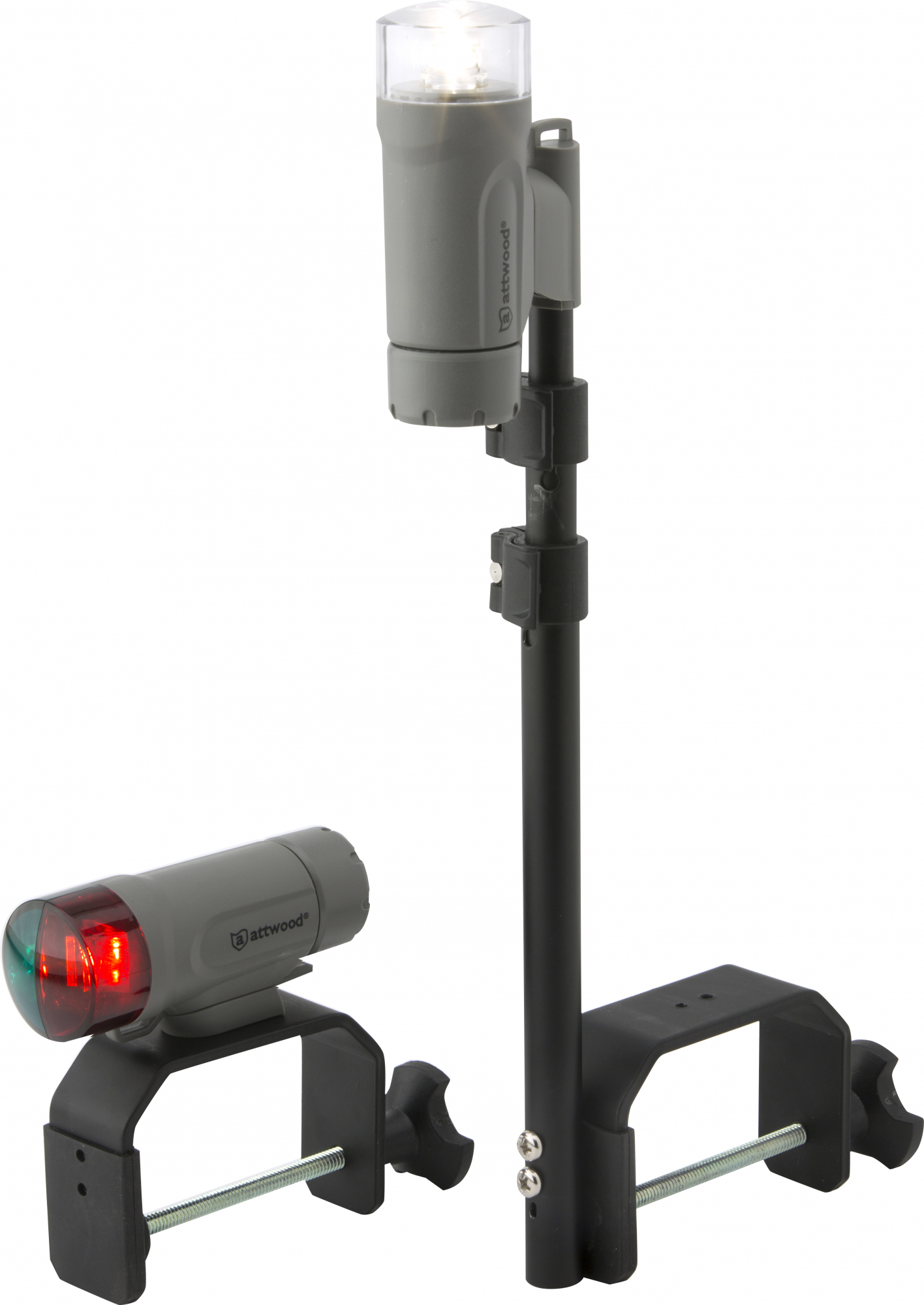

It has been my experience that time spent dealing with nav light function (running down a short, burnt bulb, cracked lense, etc.) far exceeds the amount of time we actually sail at night. I keep mine working to be legal but assume they won't work when I actually need them.... so I keep a set of these on board.
If it were my boat, I would not spend time moving the stern light and just stow a light I could clamp onto the stern rail when I needed it.
2 cents.... YMMV
2 cents.... YMMV
This light set is a powerboat running light setup as it has a 360 degree white light, so it would not solve the OP's problem, as his issue is proper lighting when sailing. That said, I would rather use the 360 degree white light, and risk confusion as to my vessel type, than sail with an obscured stern light, which would be a game of Russian-roulette.
Best to relocate the stern light to be legal, and shame on the builder for putting out a boat with an improperly positioned stern light.

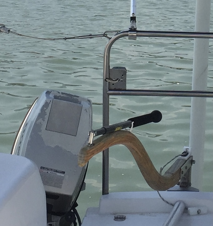

On the H26 (and maybe the H260?) they eventually put the stern running light on the stern rail (see it above the tiller in the attached photo) but there is still a blank pad molded on the right transom in the original location.
13,096
Thats a nice location and BTW: I really like your tiller....:beer:
