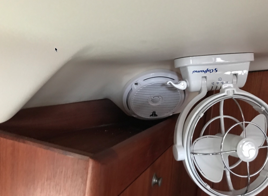

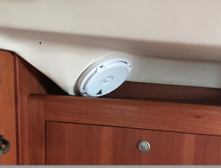

Here you go Scott...Do you have any pictures of the Saloon speakers? I'm curious if yours is set the same way as mine. My speakers come out without removing any cabinetry.
Thanks
IMG_2646

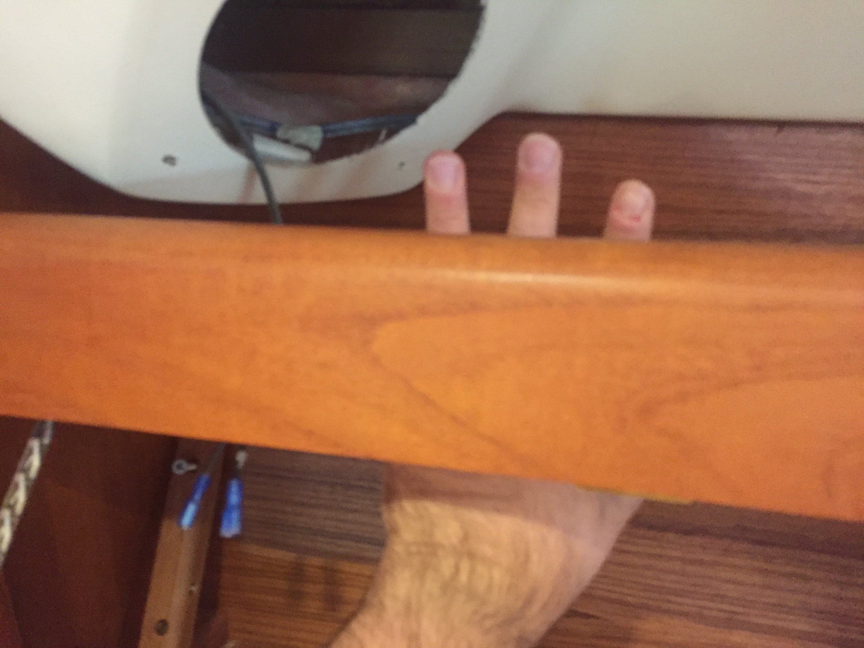

						16 screws need removal to get out the top shelf.  This is necessary to get tools in to...
			IMG_2680

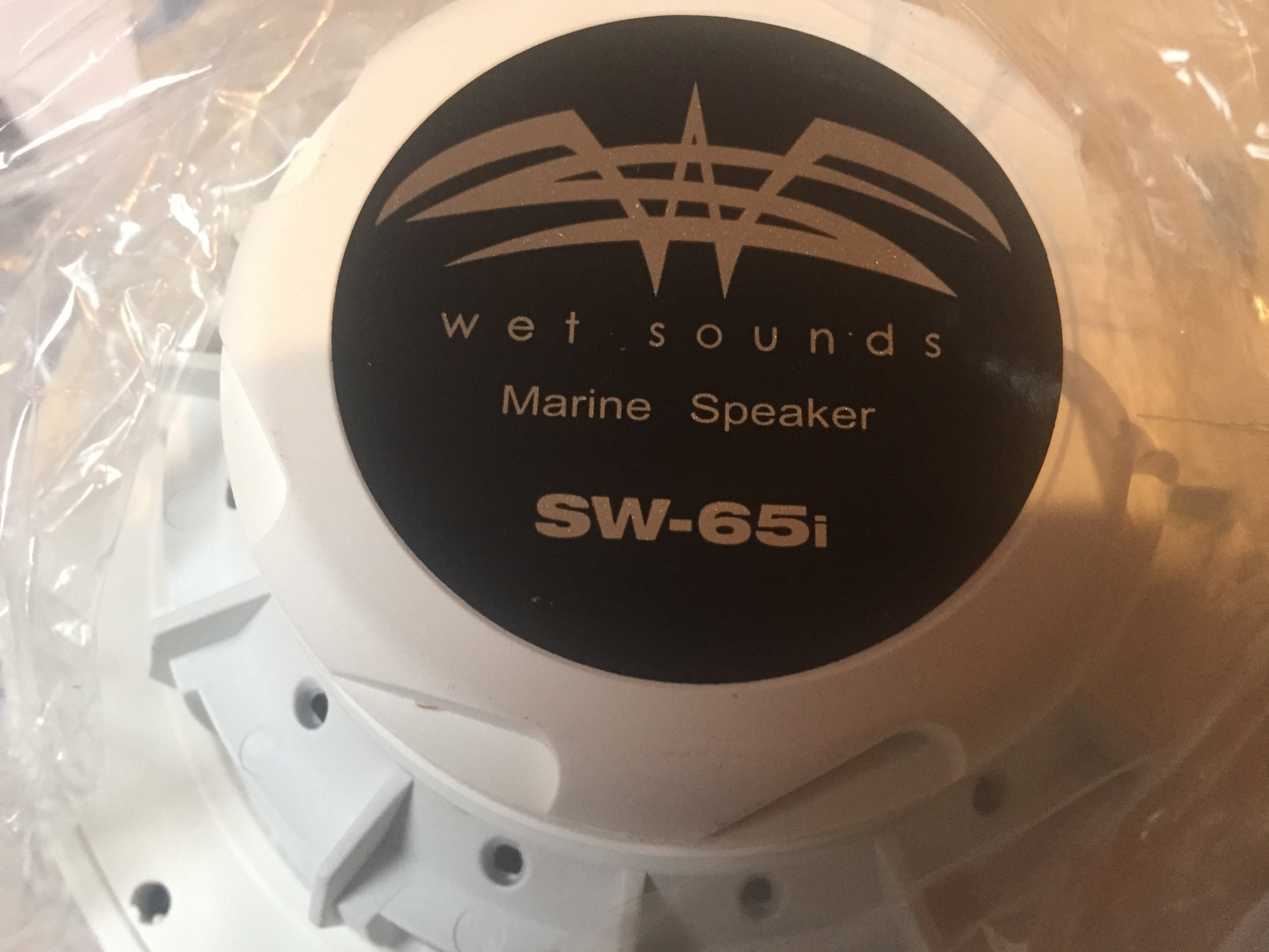

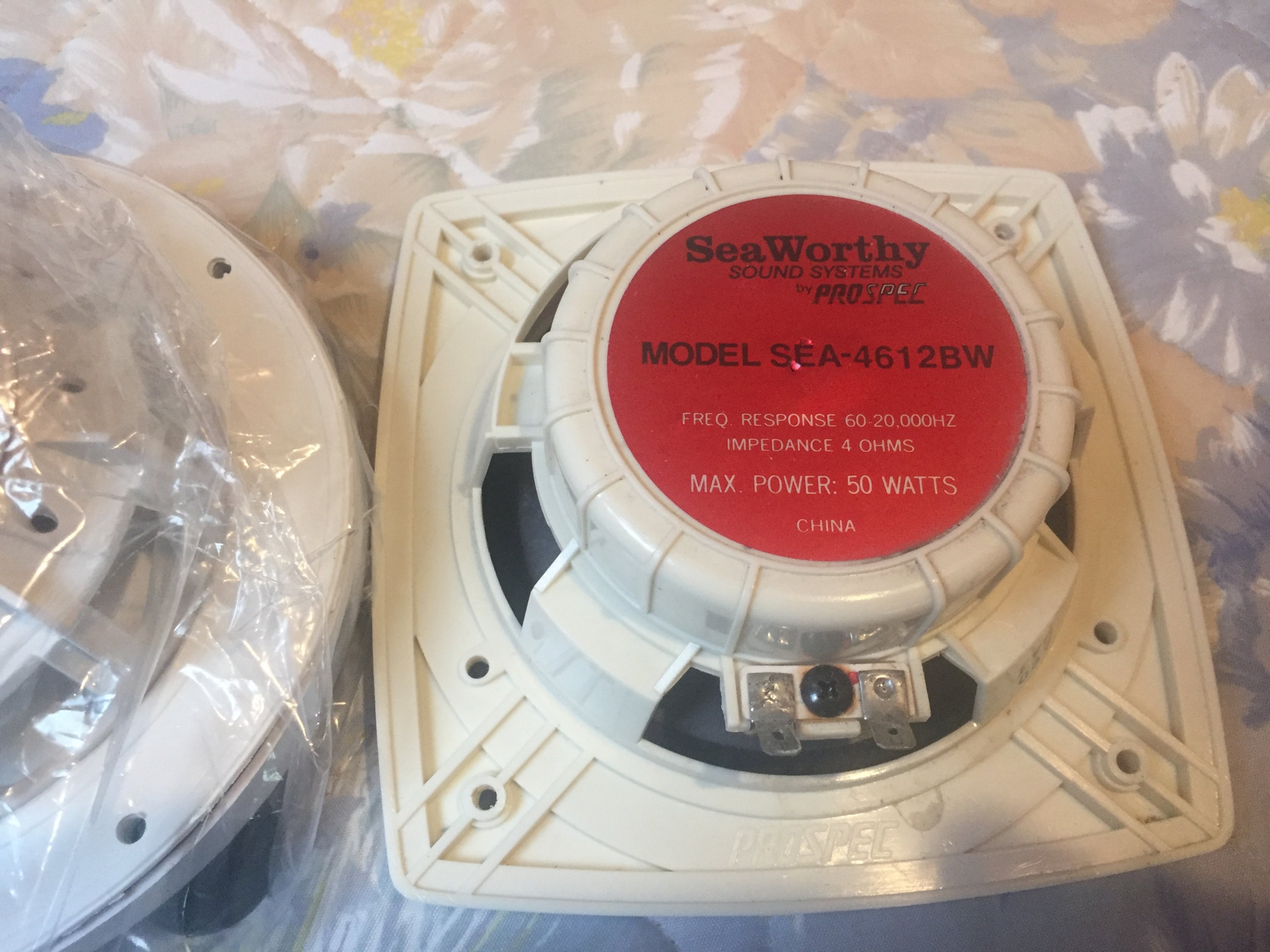

						The OEM speakers are really poor quality.  Hunter dropped the ball when choosing this supplier.
			IMG_2683

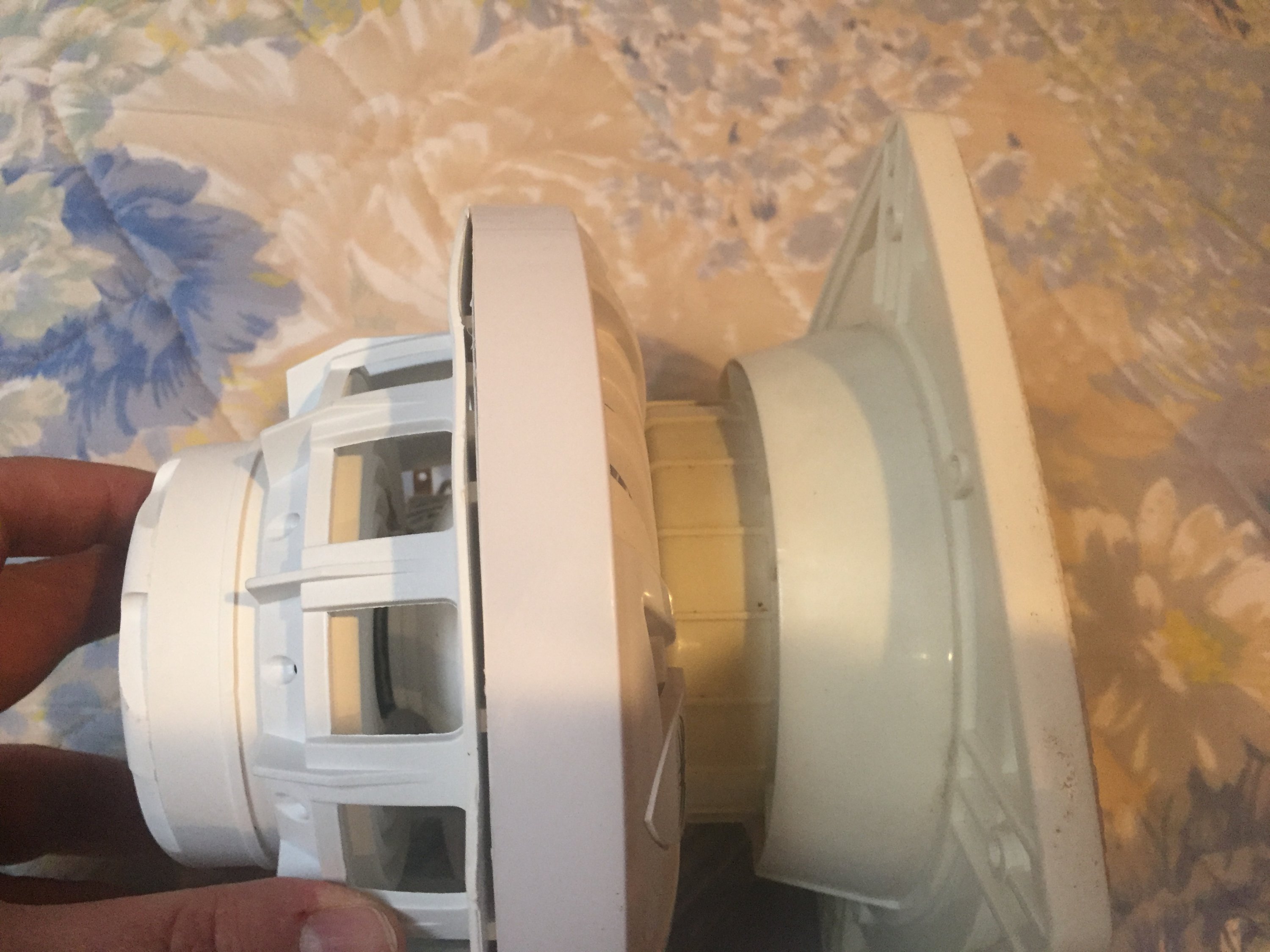

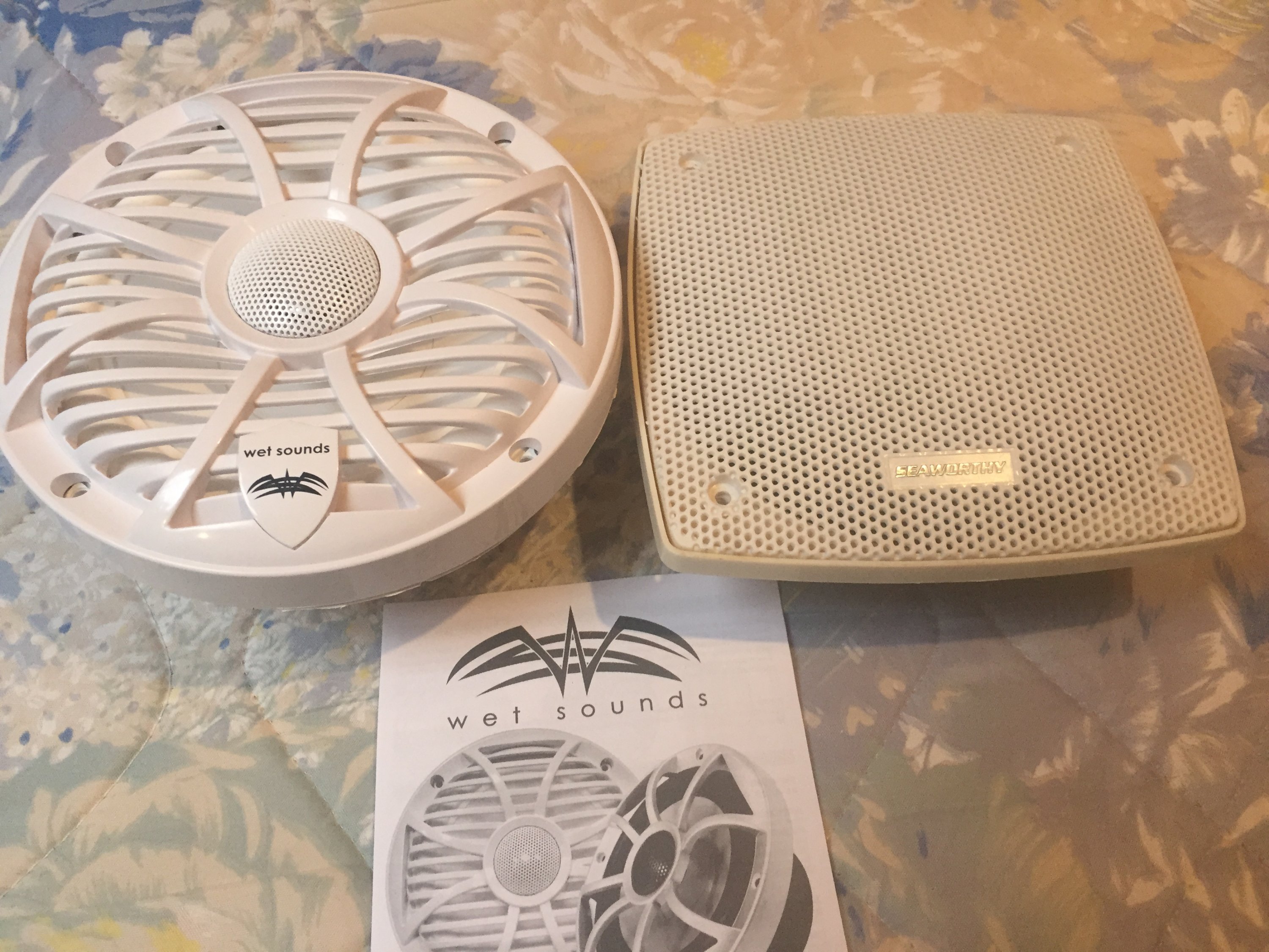

						Side by side, depth is slightly more, cut hole is identical.  There is also a white rubber boot...
			IMG_2688

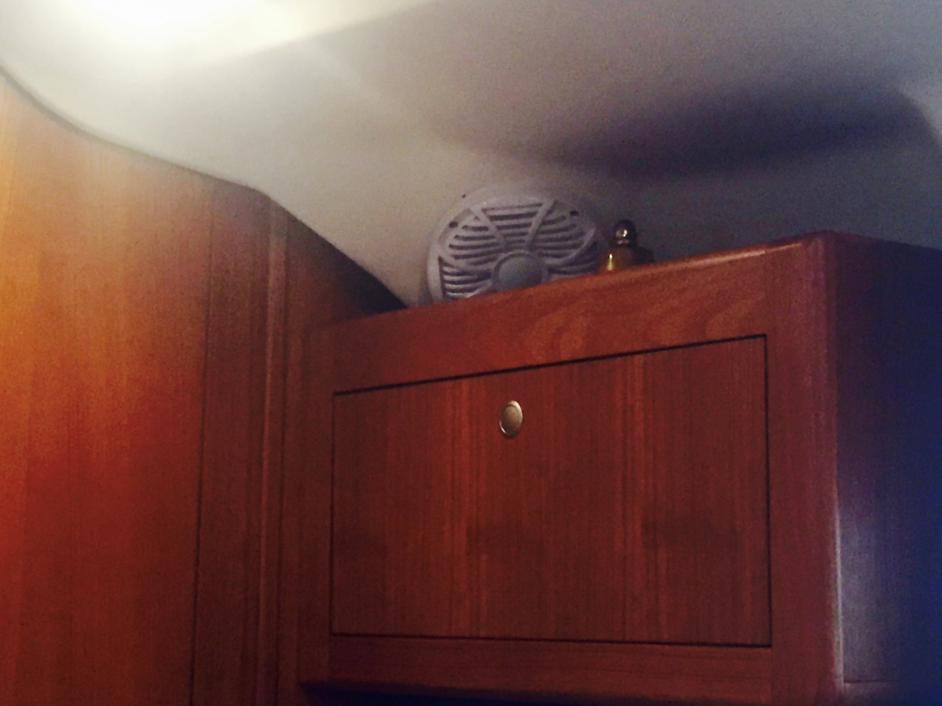

						After the install.  3 cabinets needed top shelf removal for access.  The rest were simple.  Note...
