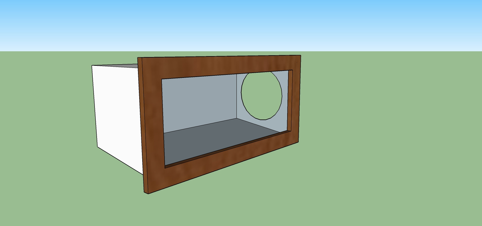

I have been playing with the best way to install speakers in my cockpit. I am planning on making custom coaming boxes which will accept a 6" waterproof speaker. I am fortunate that there is plenty of room between the coaming and hull. Look at the sketch to see where I am going with this, 1/4" ply wrapped on the outside with glass and epoxy. epoxy and varnish interior and trim.
