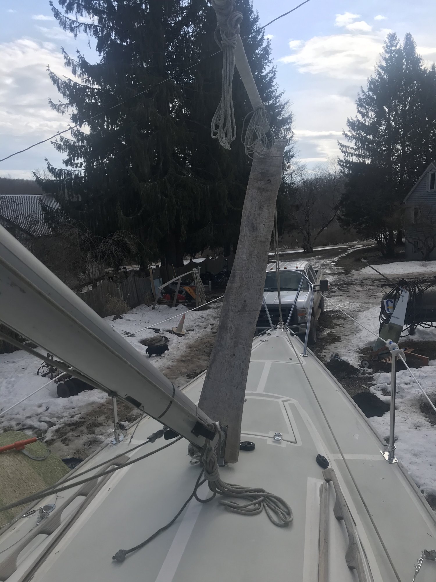

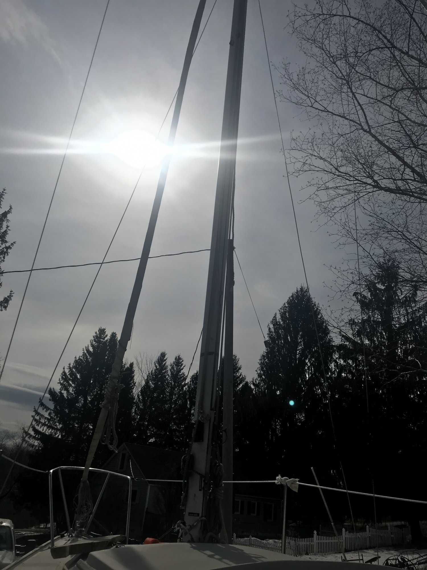

Proud sailor today! Stepped the mast for the first time and single handed too! Modified a system I saw on YouTube.
How tight should the shrouds be? I saw a tension measuring device, but I don’t have one and I want to ensure I am in the ball park before I launch next week.
