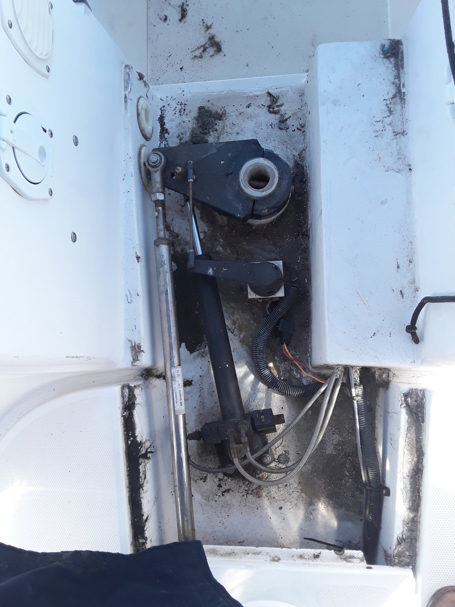

The steering linkage on my 2005 Hunter 41DS makes a knocking sound, what might that be and how might I fix it? Thanks Hunter family
I removed the cockpit floor to troubleshoot why the Raymarine hydraulic the linear drive failed and that is when I discover the draglink arm to the tiller nuts and washer had vibrated off the connecting bolt. I ended up replacing the entire hydraulic linear drive AFTER I discovered the clutch failed since I could not replace that component by itself. As far as the steering linkage recommend checking it and tighten with existing nut or replace the nut with a nylon lock nut on the bolt using loctite blue 242 designed to lock and seal threaded fasteners and prevent loosening from vibration and protects threads from rusting and corrosion..............Do you any have pictures from your remedy and what part did you order for the nylon knock nut?
