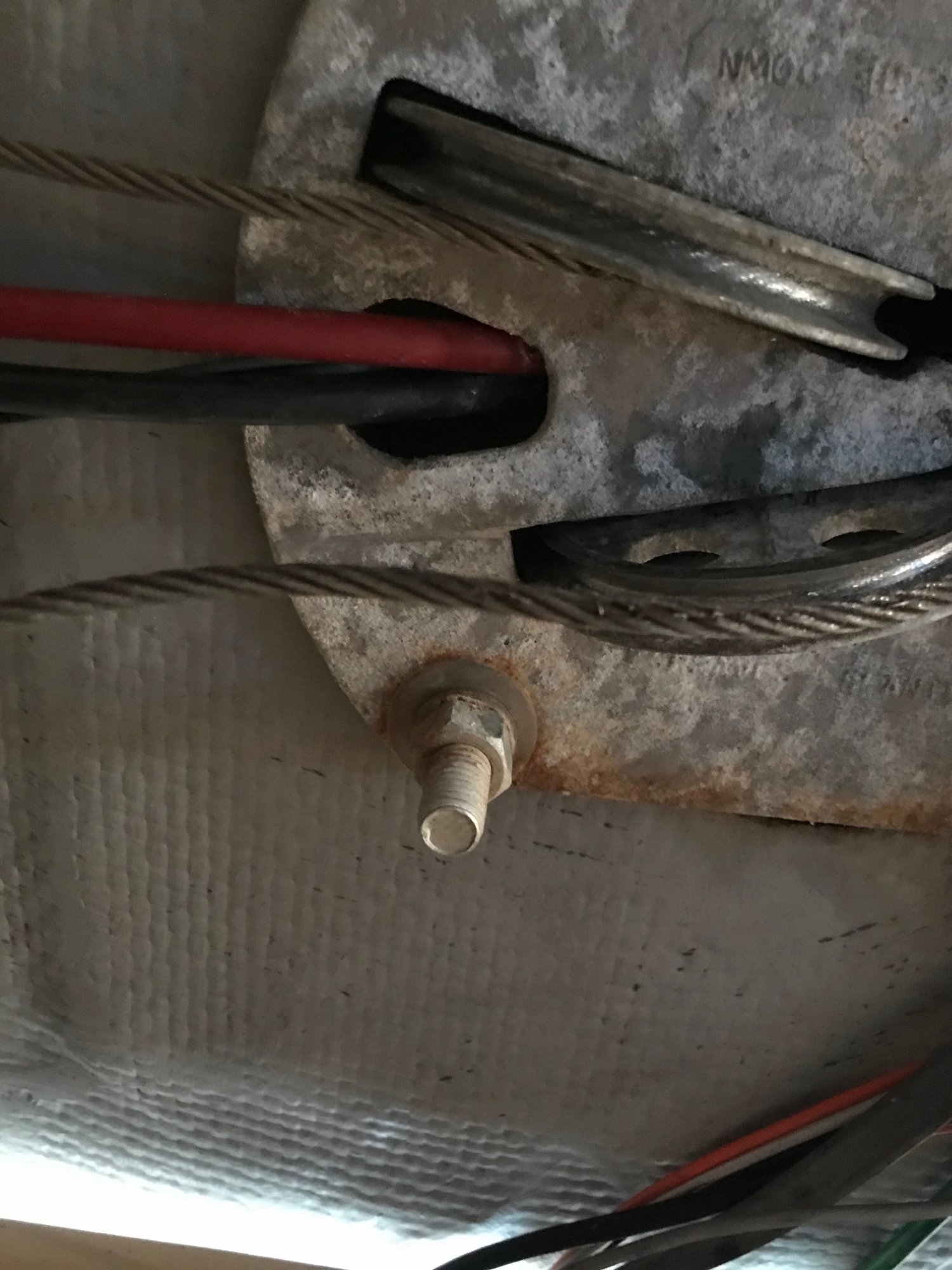

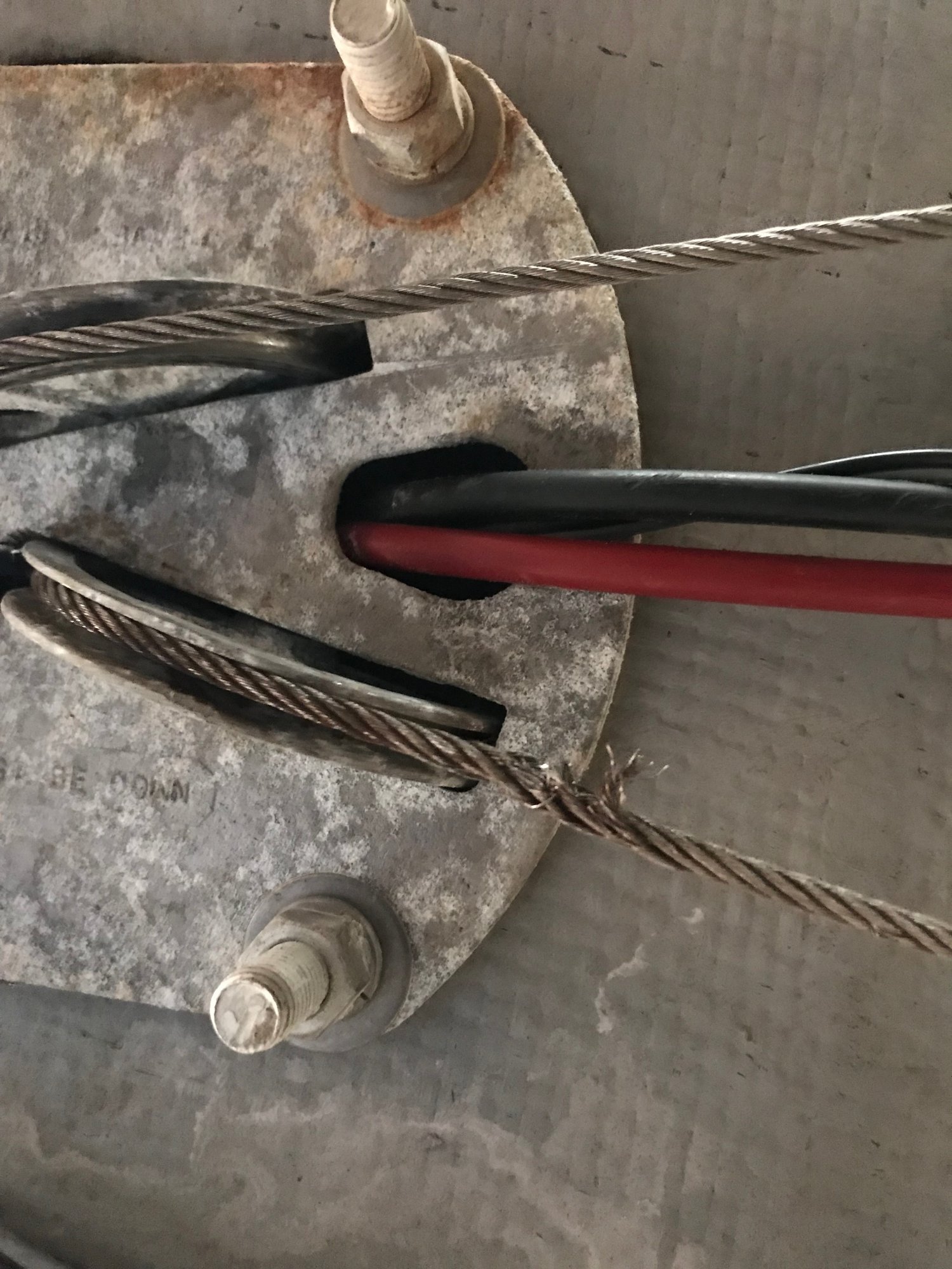

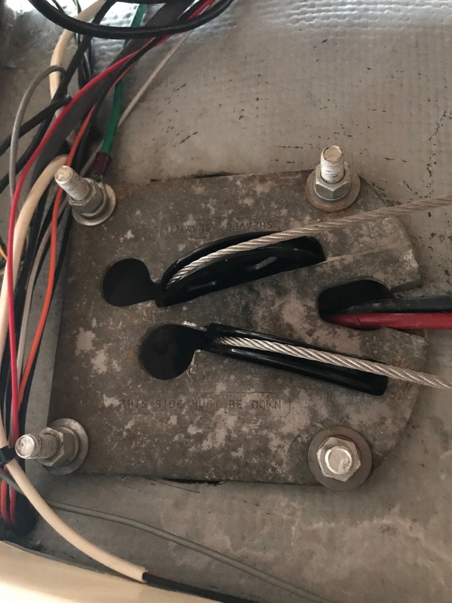

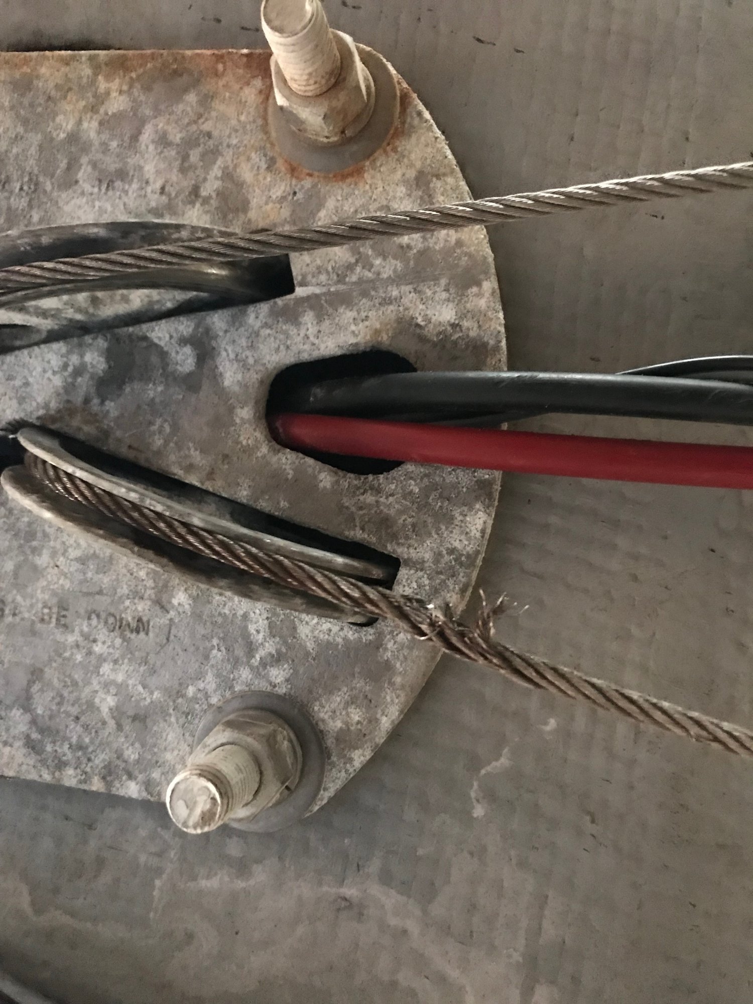

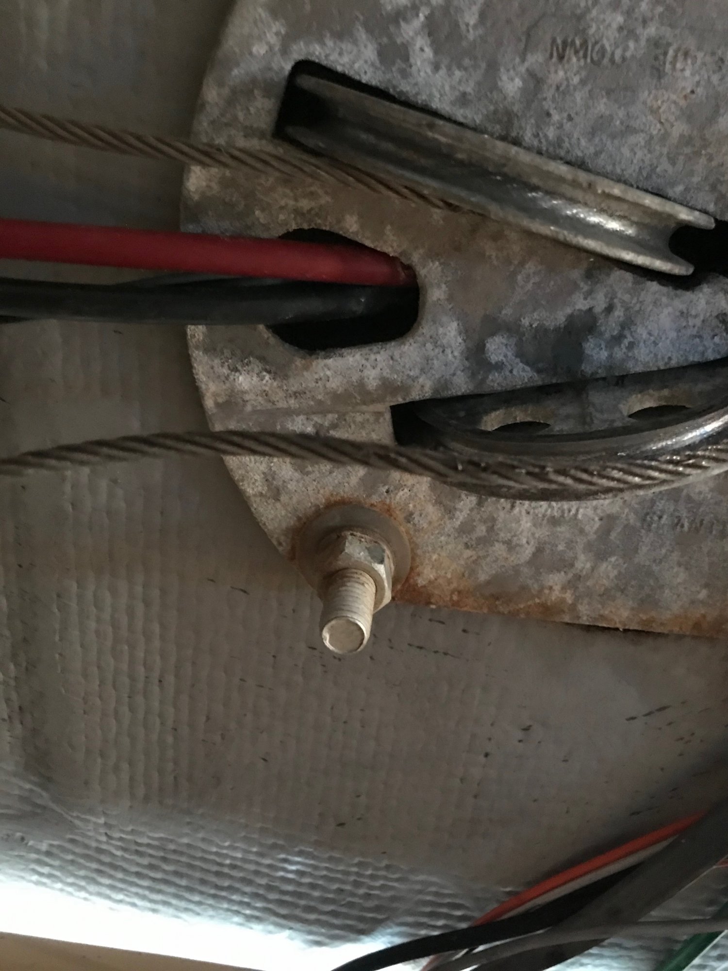

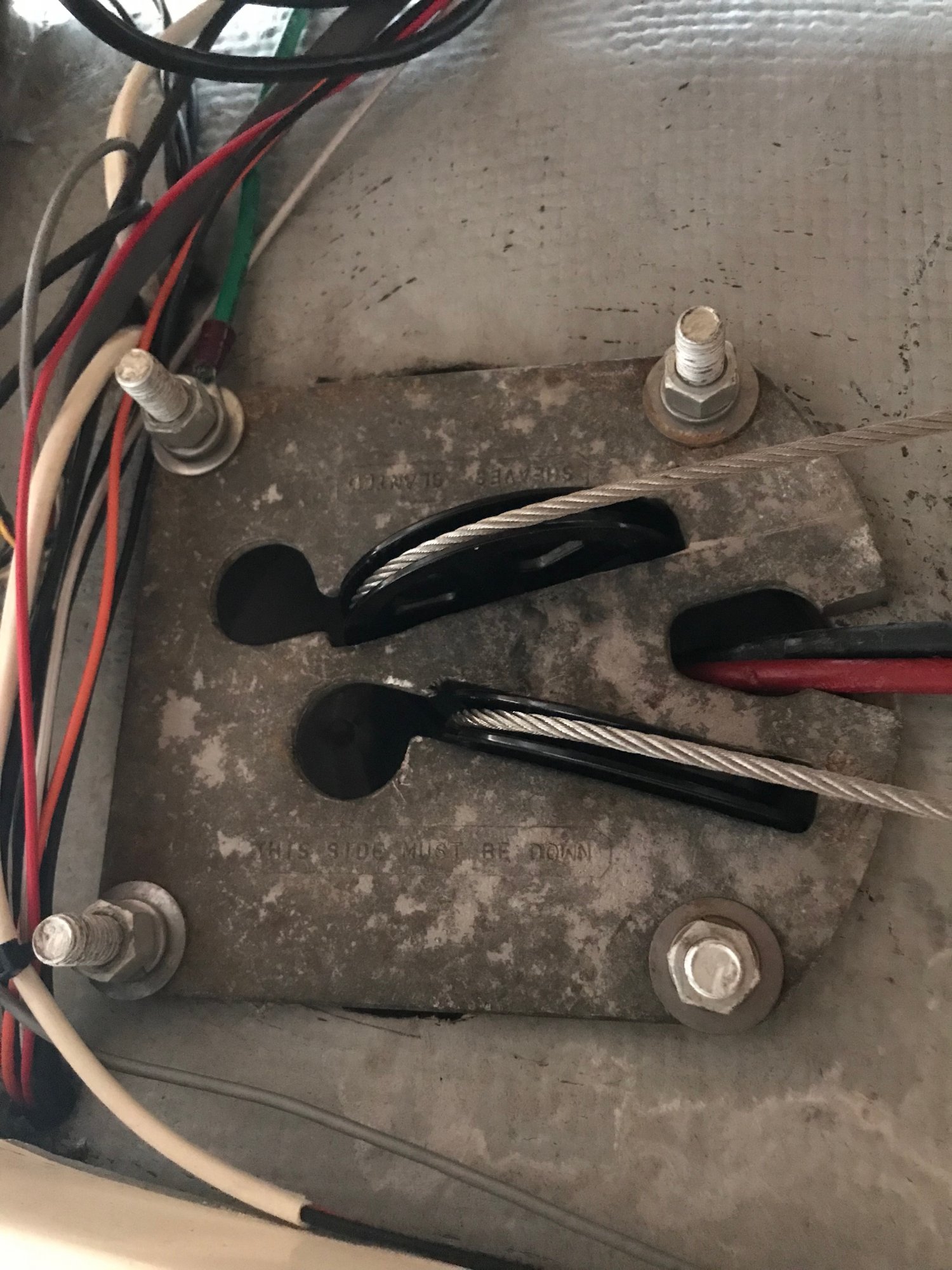

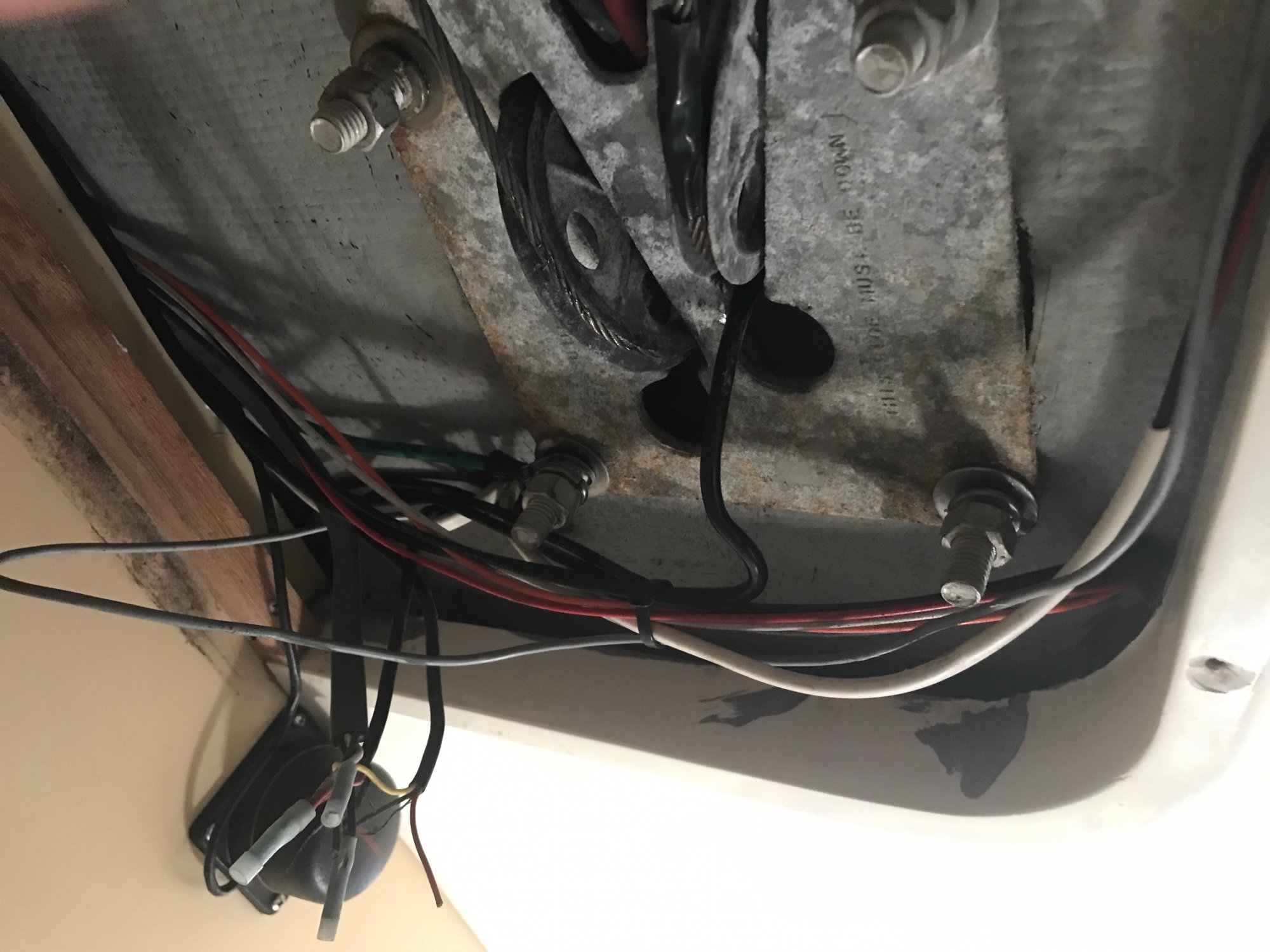

WEEKEND REPAIR...last week.
1) Steering cables were loose, fell off pulley/block into space between plate below helm and shredded (Actually I shredded one putting it back on) ....Parts = $650 New Bedford Edson supply...
2) Repairman = ME! No one else was available for 2 weeks. Took me hours to repair, cut plate to save time.
3) Emergency tiller, worked well, motored 5nm to dock in Falmouth for repair using wheel but with tiller ready, yet my duct tape repair held.
***Lessons learned, A. have emergency tiller ready & know how to use it. (took me 1hr to find it) B. Tighten play in wheel, before cables come off ****
