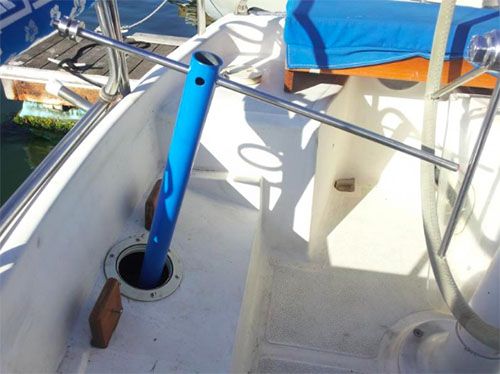

Most boats are with a wheel also include an emergency tiller that drops into the steering quadrant from the deck. It may not be the most convenient way to steer... but it beats having no steering.
Not infrequently, emergency tiller parts are missing, mismatched, or broken.
Does yours fit that description, or is it safely aboard? Have you ever had to use your emergency tiller? Do tell.
Mine's a lot like the one in this picture. Crude and ugly. I broke a cable once so I know the pieces are there and it works.
