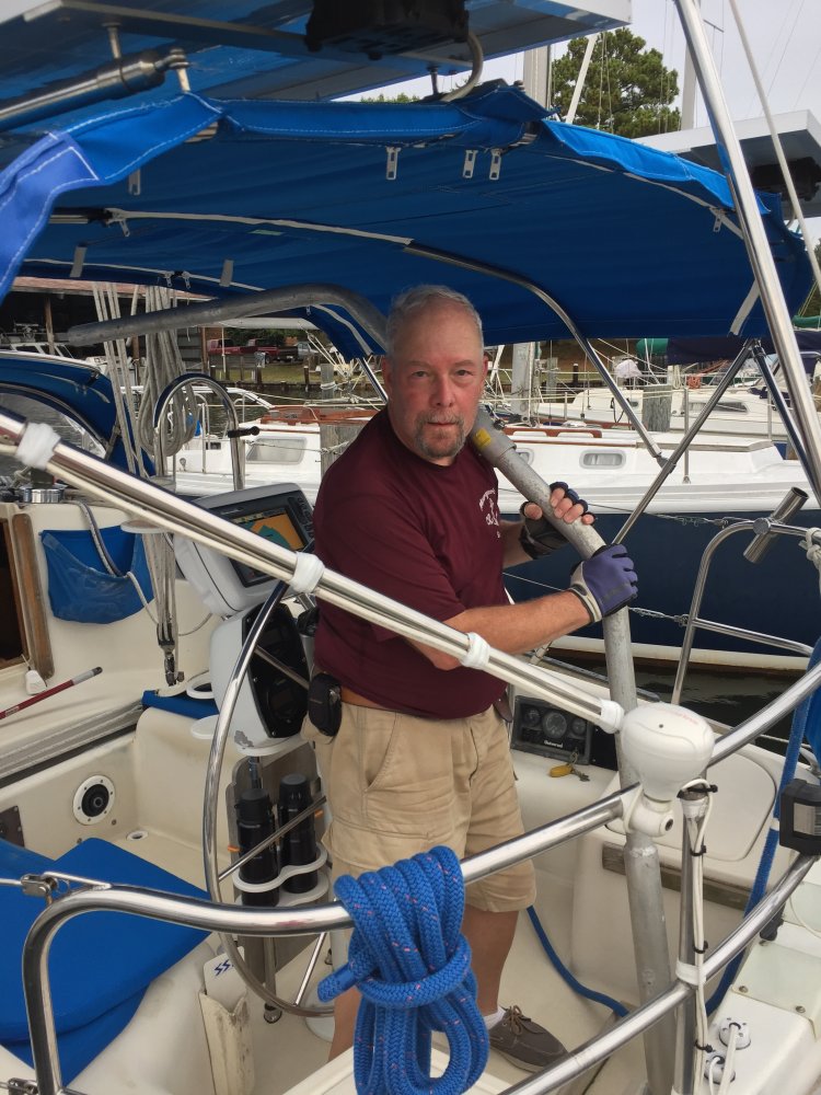

IMG_6862.JPG My sailing mate didn't understand that he was driving the rudder into the stops in some heavy weather last year. He hastened the failure of the 30+ year-old stbd idler pulley. Steering was flakey, but the below-deck autopilot worked fine. As we were beginning to proceed up the creek to the slip, I decided that we should break out the emergency tiller just in case. As I began to turn to port to line the boat up for reversing down the fairway, we heard a loud clunk as the stbd idler fell on top of the fuel tank, and I had absolutely no control with the helm. We calmly put the emergency tiller in place, and I got into my slip on the second try. It pays to be prepared!
