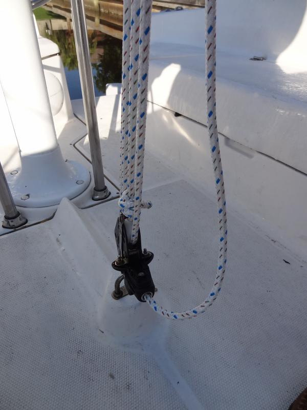

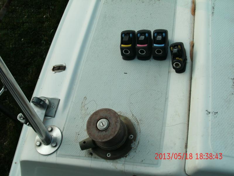

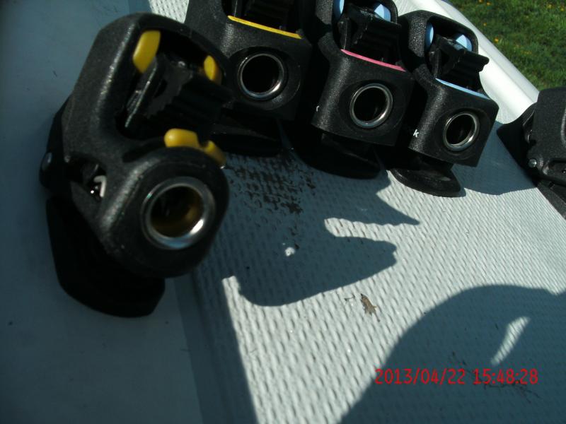

Spinlock Powercleats
I installed PXR0810/T cleats (mounting holes cross vs. inline) for the main- and jib sheet. It needed a little modification on the main sheet purchase to mount the power cleat but they were fitting as direct replacement for the jib clam cleats.
As main sheet I use a 5/16" XLS line. Have a new 3/8" jib sheet but may have to replace it also to a 5/16" line. Not practically tested it yet.
