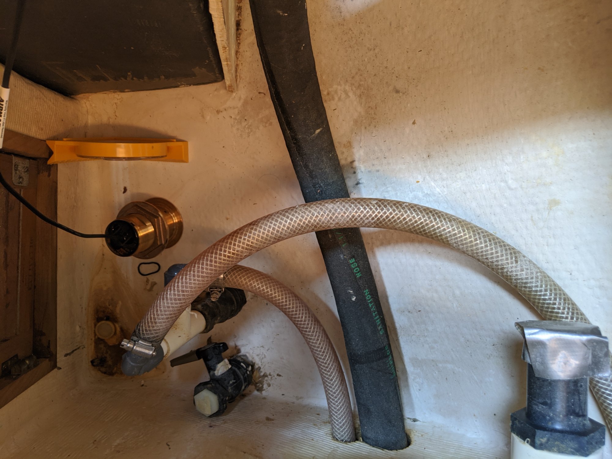

Hey all - I'm working up the courage to install my new Airmar B619 through hull transducer, and trying to find every reason to put it off (half joking). My question is why I see people using a piece of wood as a spacer when installing through hulls? The Airmar came with a plastic/rubber (something) spacer, so I'm guessing that's sufficient? Seeing as the hull is a bit curved, I'd think that the spacer (which is flat) would keep it from keeping consistent pressure over time. I've attached a photo of where were thinking.

Ralph, I appreciate the comment. I'm not kidding when I say that we finished the installation right as I got your response. Curious about why you're against the thru hull, though? Is it just the additional benefit vs risk?

PS: I believe the answer to your original question is that depth transducers are larger than most water intake/drain thru hulls. The smaller sized thru hulls need a spacer of a larger diameter to spread the load of opening and closing the thru hull valve.
