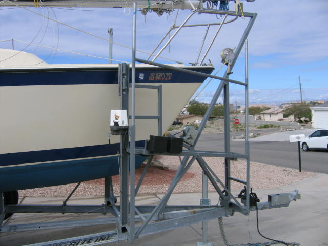

I'm not a fan of the brake bump so have devised other ways to bring the boat to the bow stop. The double winch is the simplest. Extend the current winch post 2', or higher, above the bow eye and add a second winch to lift the bow as you bring the boat on to the trailer using the primary winch to move the boat forward. If you make this second winch high enough you can use it to raise the mast with a gin pole. If you mark where the bow stop should seat on the bow you can put the boat in the proper place everytime. It all has to do with making the boat, while sitting in the water, the same angle as the trailer is on the ramp or at least close. If you want to build a new or highly modify your trailer, my latest trailer design works better.

A rotating keel stop positioned at the "pivot point" allows the boat to settle into the trailer when it's not at an optimal angle. Removes the need for other winches and stuff, and gets it right before the trailer comes out of the water. A brake bump will not be happening with 7500 lbs of boat.....
