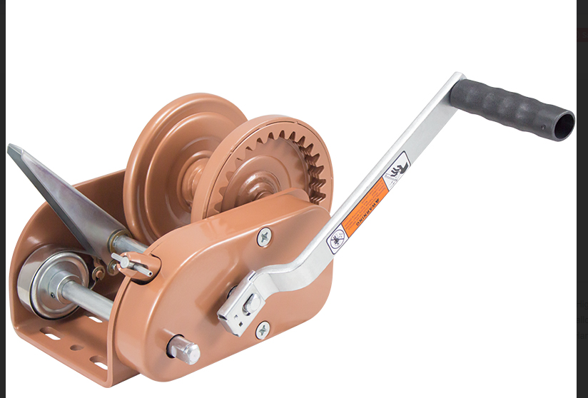

I used to own a Balboa 26 that had a 1200lb lead bulb on the bottom of a large cast iron keel. I'm guessing the entire deal was over 2000lb. It used a winch similar to this one.
There is a hand break that allows you to let the load down slowly. OR you keep you hand on the break while lifting so that if things go sideways, you can control the drop. Anyway, you don't need electricity....
https://www.dutton-lainson.com/proddetail.php?prod=14894

What I would love is a winch that runs on electric with a mechanical back up that I could hook a socket to and go after by hand. Cuz I am lazy. Cranking that up and down doesn't sound like a hell of a lot of fun.
Likes: rgranger
13,096
I agree!
