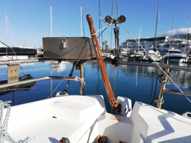

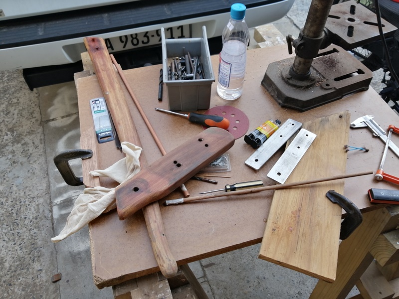

Also; removed the wooden tiller to take it home for some refurbing...just can't help myself = First project! The tiller handle is weathered and the attaching plates for allowing it to swivel upwards were having rusted bolts, was worn and floppy and looked way to homemade!

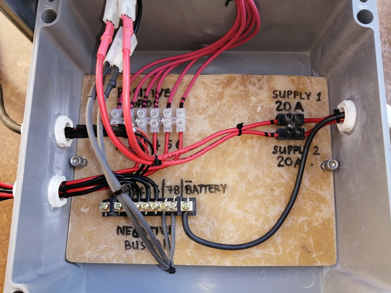

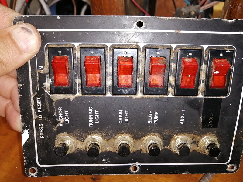

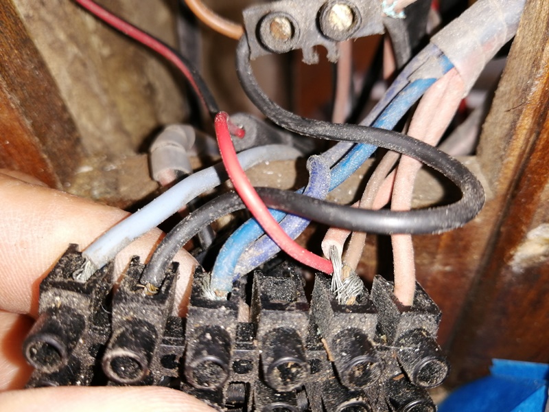

Ok... this is going to turn into a bit of a hybrid thread between my C/J22 and the Theta 26. Reason being that the C/J22 did not have an electrical system and I always planned to fit one... and... the Theta 26 has an electrical system that is a rats nest of spaghetti and corroded terminals and mix match of wiring, household, automotive (non-marine grade) and some really old built in electrical wiring = none of it actually working! Stay with me on this...
My plan for the Cat22 was to build the DC electrical switch panels into a watertight electrical box that i could then mount in a suitable location on the boat and from there run the external wiring to the various electrical loads = mostly lights, the GPS and fitted VHF. That plan has changed since procuring the new to me old boat. The priority is to get the Theta back home from it's current location. The electrics need to be sorted as there is no ways I trust the mess and not having necessary lighting for navigation and cabin it is not safe.

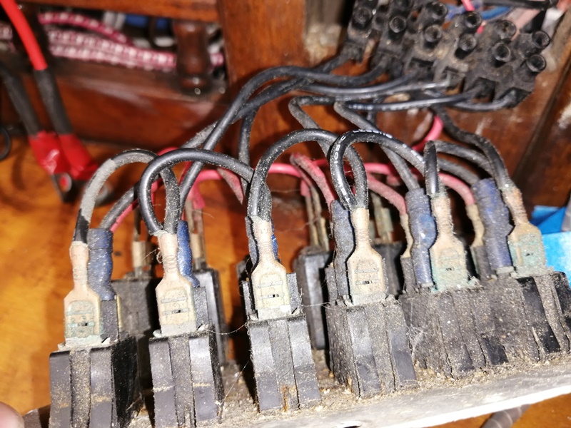

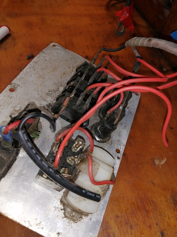

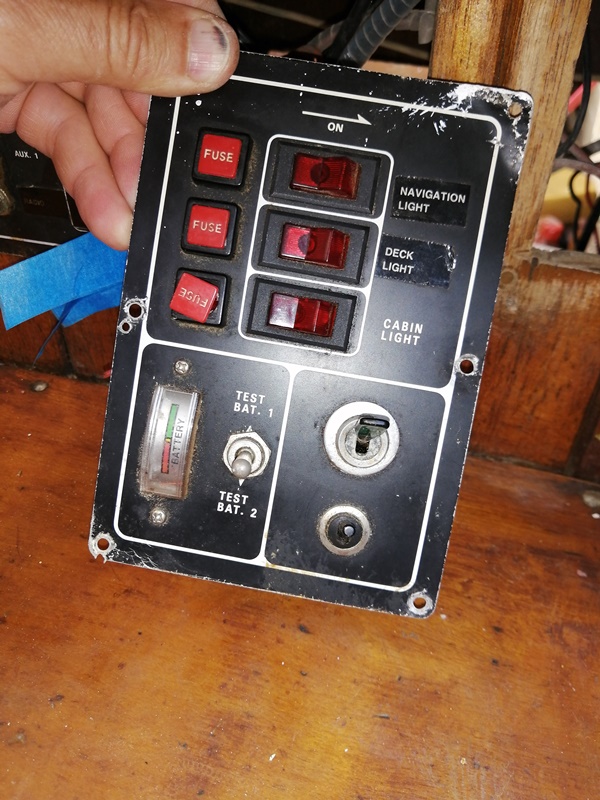

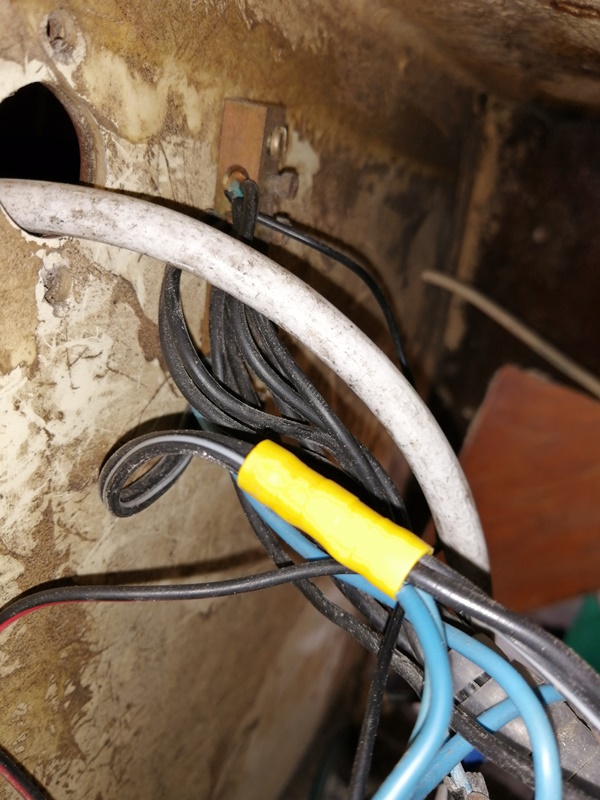

The first issue was nothing really worked at all. One of the two batteries was dead and although the engine alternator was charging, it did not do anything to revive the dead battery.
Some pictures of the old stuff as I ripped it out...

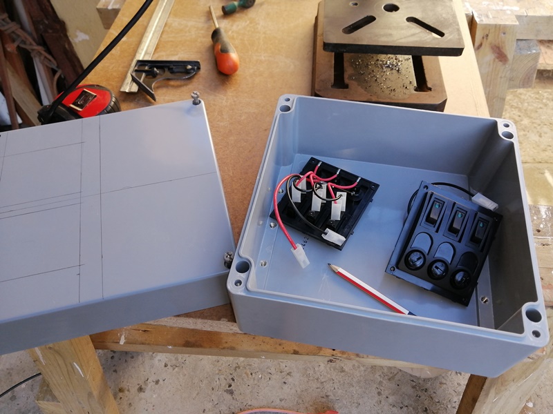

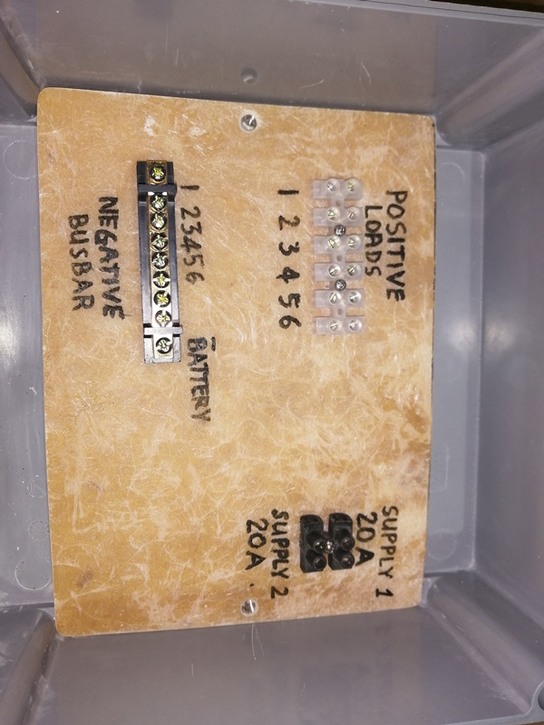

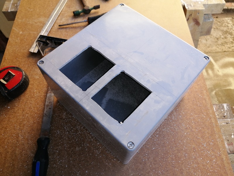

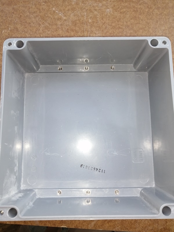

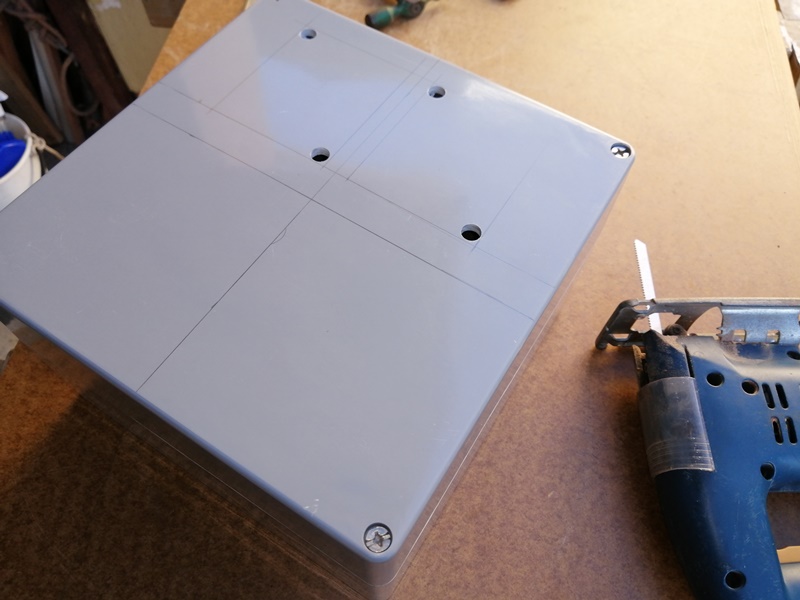

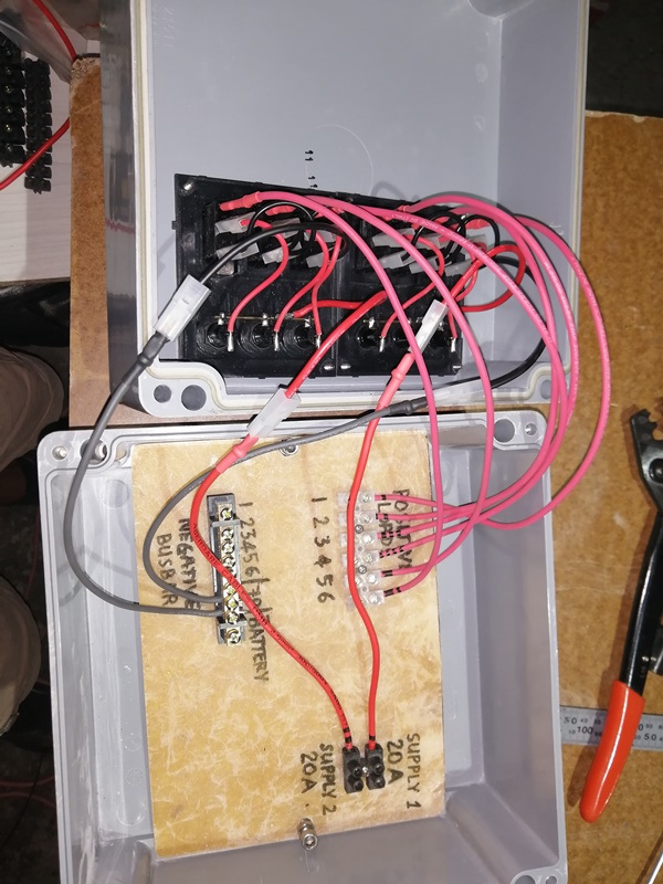

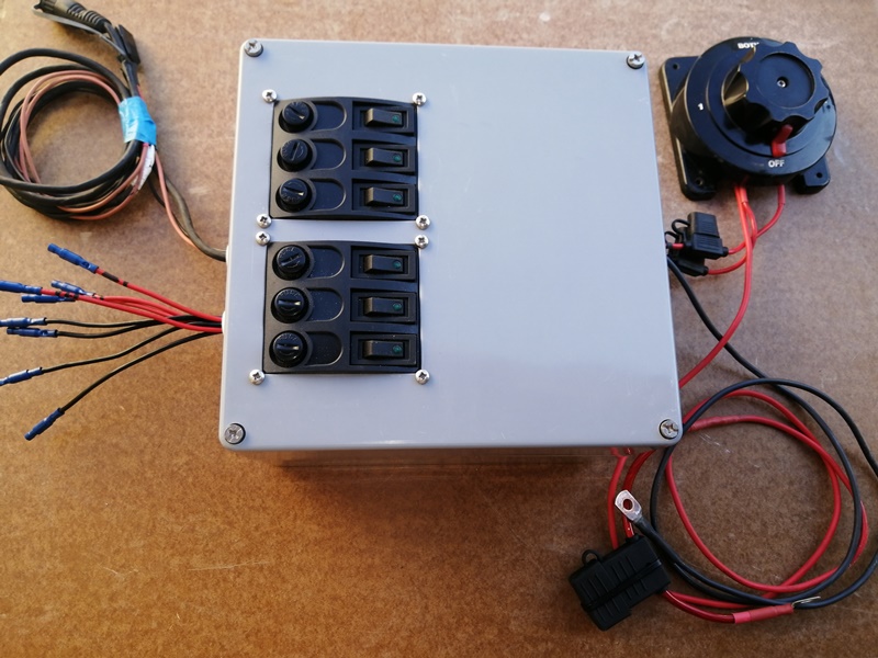

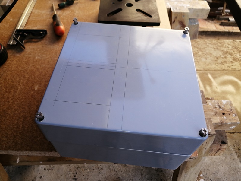

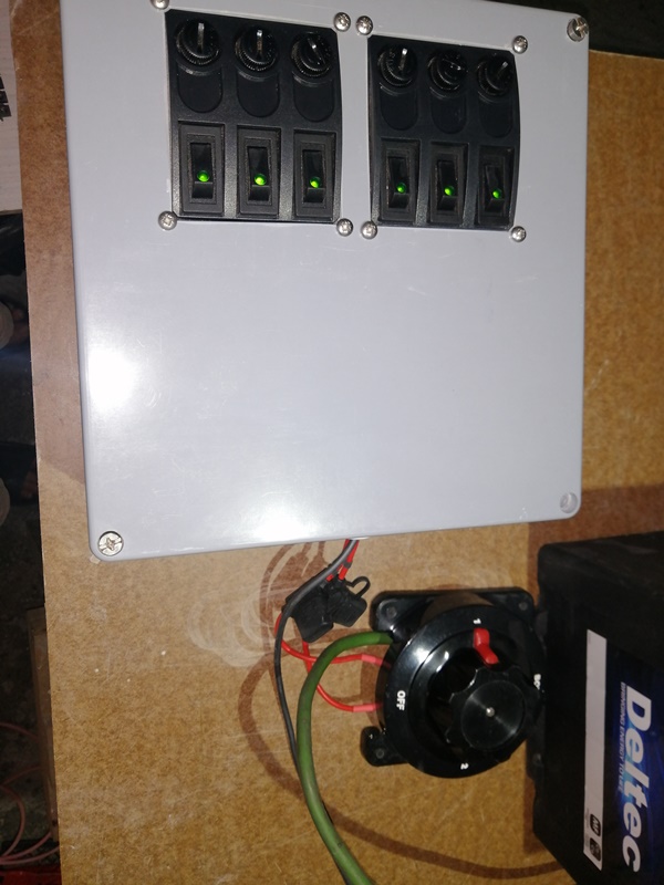

The new DC electrical panels which were originally purchased for the Cat22. I wanted the switch panels, positive break out terminals, the negative busbar, the supply cabling and the outlet cabling to all be mounted into the watertight electrical box. Cabling passing through gland seal fittings. I also wanted to have a separate fused supply to each switch panel. I did a lot of research and youtubing to get the necessary advice and know-how for this project. Specifically listening to Jeff Cotes presentations, Pacific yacht Systems... (no I get no bux for this!)

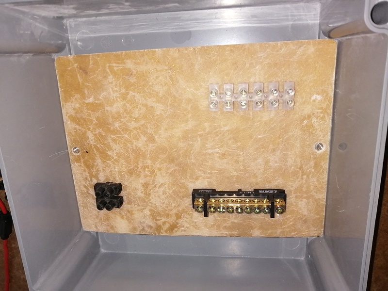

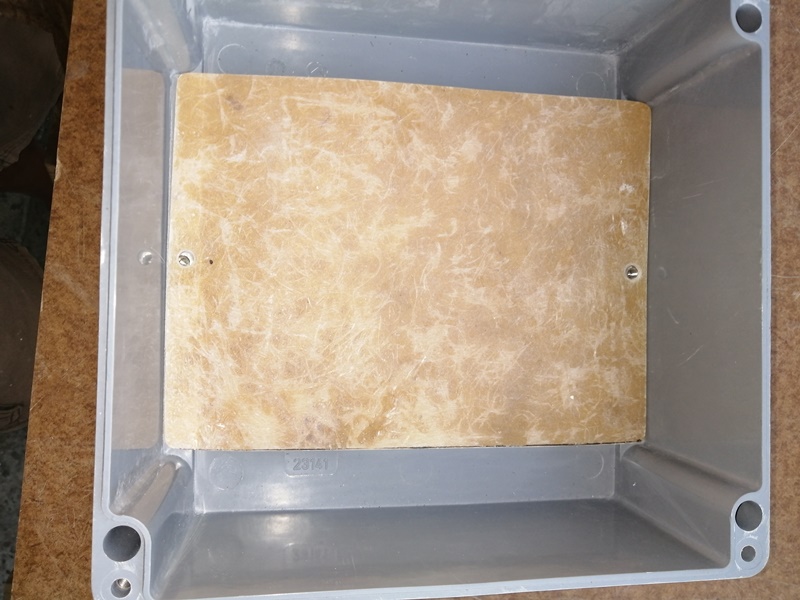

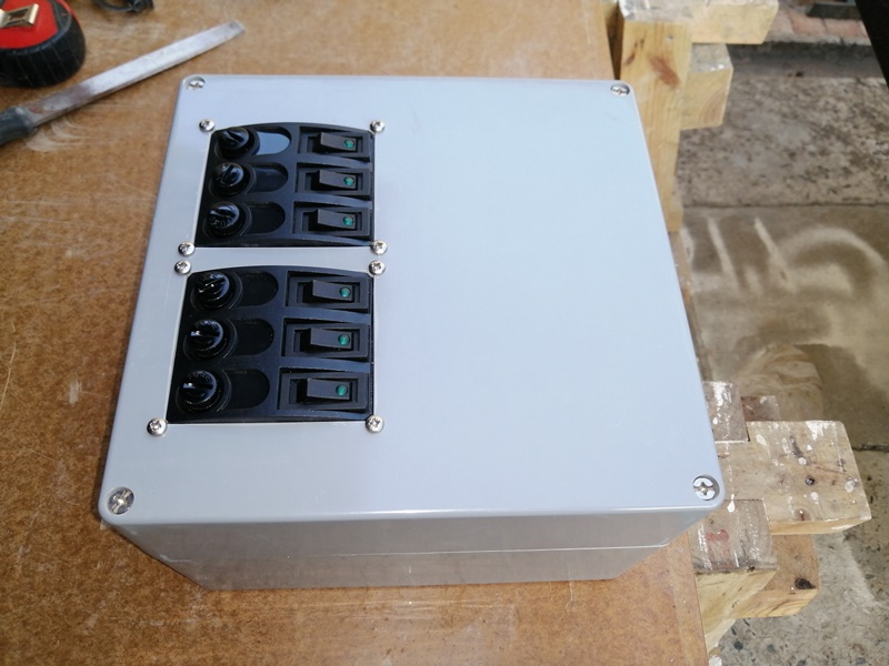

Starting with the enclosure box had to plan layout, cut holes, shape the holes to tightly fit the switch panels, make a backing board to mount the termonals and busbar on and the drill holes and fit the glands. Then it was time to run the cables. I used what I had and what I could get hold of locally. All exposed wire ends were tinned and heat shrink applied where ever it could go!
The job was done in my garage at home and then transferred to the boat as a ready to install kit. I like it and am planning the same idea for the C/J22.
Here is the box being prepared to accept the switch panels. They are two separate panels of three switches each. There is room for two more panels should my needs aboard increase.

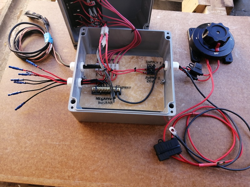

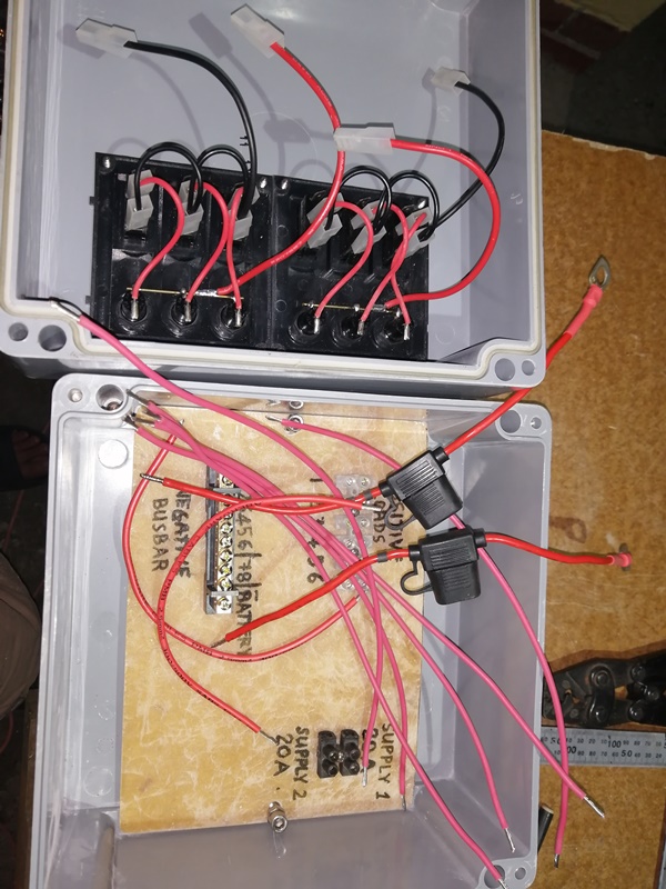

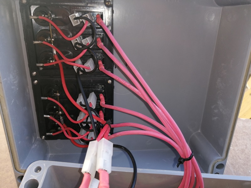

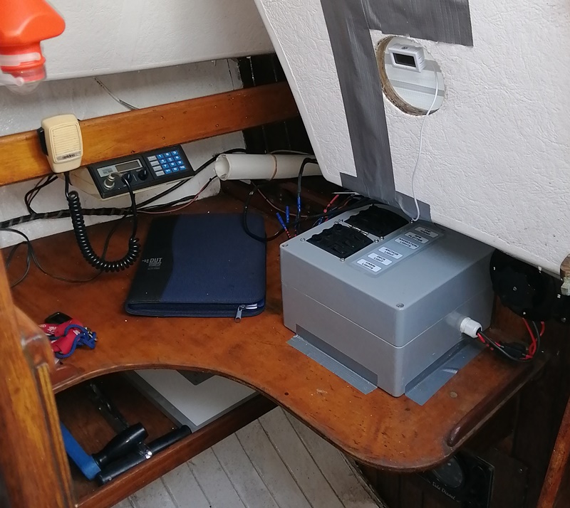

Here I am preparing all the wiring and then installing it. I managed to obtain silicone insulated wiring from a local electrical supply store. We don't have the likes of West Marine or similar in our area. So what I had and what I could source as best is what I used.
I made up label the next day and forgot to take photo of the finished project.
Outlets on the left, inlets on the right. From the supply battery there is a 60Amp fuse at the positive terminal of the battery. This is led to the battery isolator. Then from the isolator two separate 20Amp fused cables into the panels, one each. The negative battery terminal cable goes straight to the negative busbar. from the 6Amp fused switches the outlets goes to the break out terminals and through the gland seal. Same with the negatives from the negative busbar. From the top is the VHF, GPS chartplotter, navigation lights, anchor light, deck light and cabin lights.
Edit: Added the last photo showing the electric box temporarily installed on the chart table. You can also see the label which I made on the computer and then laminated. Unfortunately the box is just to tall to fit where the old panels fitted without carrying out some kind of woodwork panel surgery. I will spend some time using the boat as is before I decide to make modifications to structures.

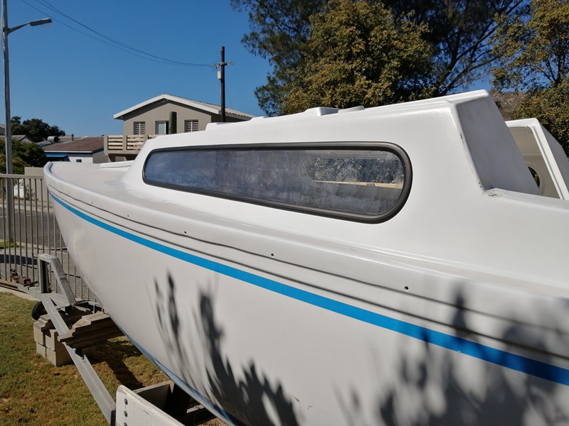

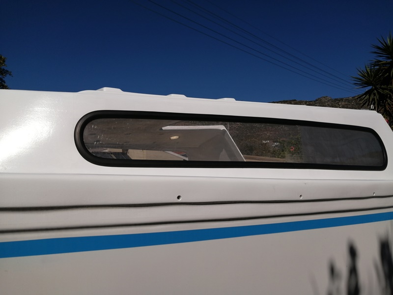

So I have been neglecting the boat rebuild for a while now. There's only so much sitting around, so much "work from home" one can do before cabin fever sets in!

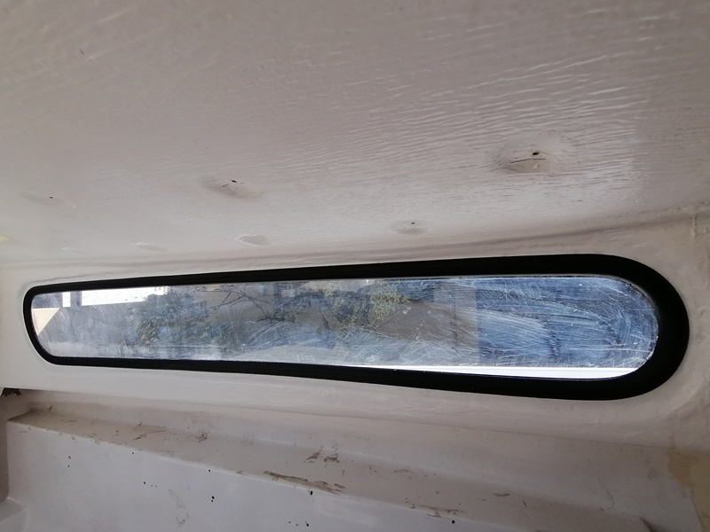

I had the items required to fit the windows or portlights but have been putting it off since way back when. So i spent a day cleaning out the accumulated dirt and fallen leaves from the tree across the road just to make it more pleasant to work in the boat. Then it took me two days of sweat and curses to fit the actual window. It's not difficult, just extremely awkward to do on your own, a little cramped inside up against the ceiling and it was actually two hot days.
I had previously shaped the old perspex windows to fit into the holes with the correct clearance for the moulded rubber beadings. So I had to cut the mouldings to the correct length then fit them to the opening. Lots of soapy water and a couple of putty knife type scrapers and sweat and cursing finally got the perspex window fitted into the moulding = one day. I was quite sore in the neck and shoulders from working at odd angles and using brute force.
The next day, millimeter by painful millimeter, I fitted the locking wedge shaped moulded rubber bead into the slot in the rubber frame. This secures it as well as expands it to clamp and seal the window side and the fiberglass side.
All in all I think it looks good, the window is pretty solidly in place and best of all it withstood a heavy spray jet of water testing = no leaks.

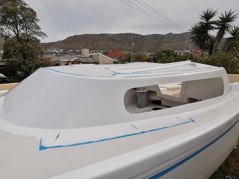

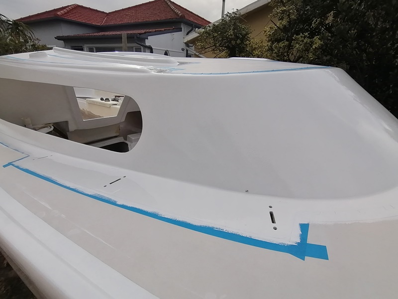

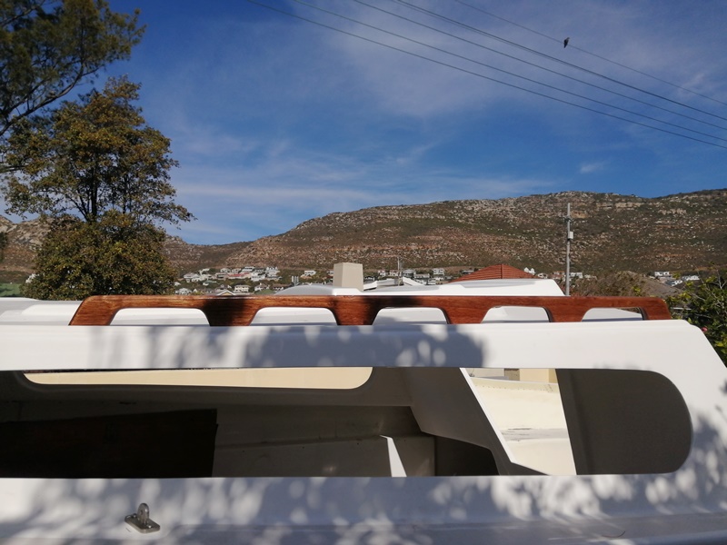

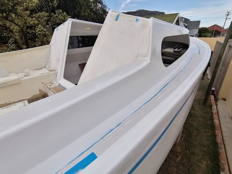

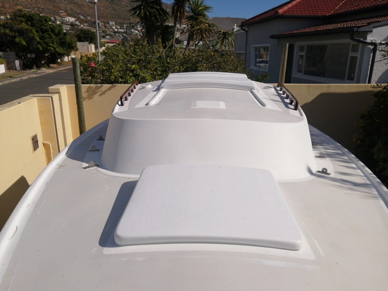

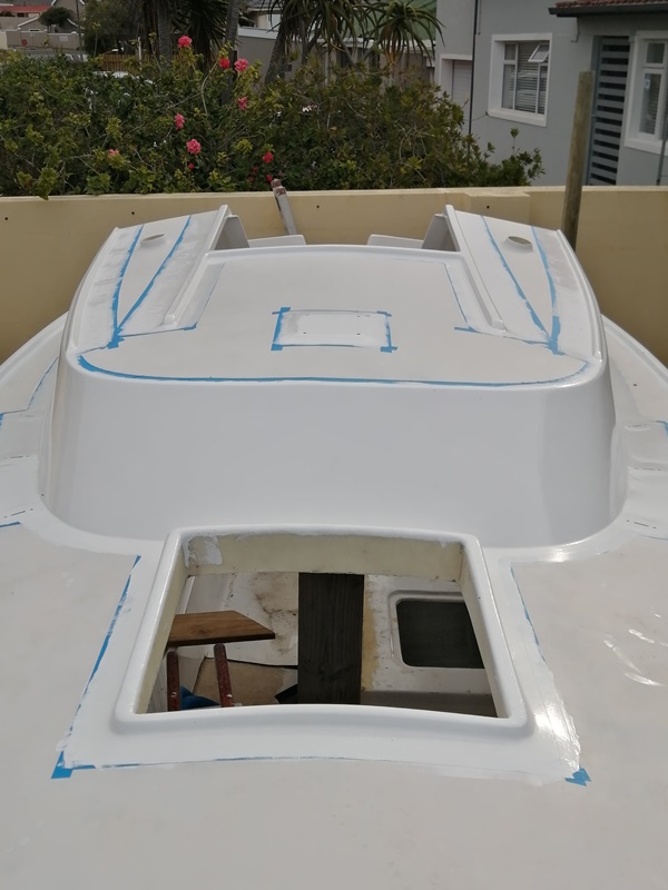

I needed to get the deck painted with primer and topcoat before I could fit the woodwork. The wood work in question being the handrails/grabrails, the sliding hatch rails as well as the side rubrails.
There were a couple of really calm days forecast so it was on... water paper sanding the previos coat of primer, washing down and dry the deck. A days work. The next day was wait for the day to warm up, dry off the nights condensation, clean and wipe down with the thinners. Then two coats of primer. Another days work. Next day was very lightly waterpaper the primer coat to remove the inevitable bugs and dust from painting outside.
Then it was two coats of white. Problem is here by late afternoon, 3pm~ish, the day cools very rapidly and condensation builds on all surfaces, even inside the boat! I should have just applied one coat but I mixed to much and did not want to waste it. It all looked fantastic until the next morning! The paint that was besaut shiny and smooth had turned all matt overnight with the cold and water condensation. It was touch dry by late afternoon however I suppose it had not cured properly before the condensation set in.
So, more sanding and painting in the warmer months again. I'm using International Mediterranean white two part polyurethane topcoat. Looks off-white in the photos.
greg_m
May 23, 2017
692
Catalina Jaguar 22 Simons Town

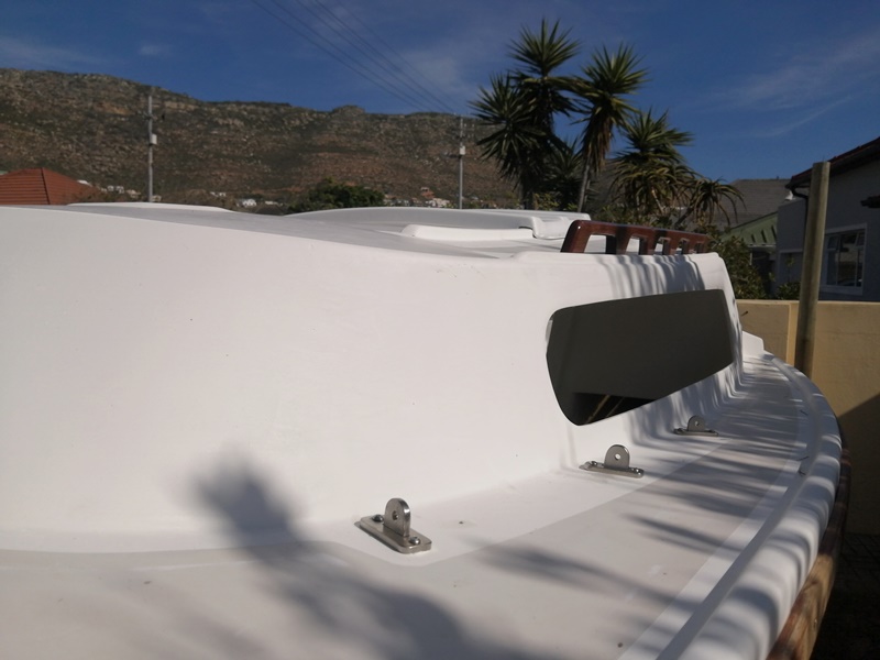

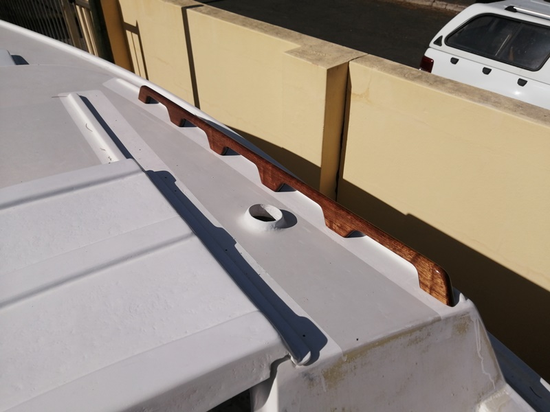

Handrails were next as the were mostly done. just a couple of final varnish coats. The look fantastic and really help the boat look more boatie!
Although fitted they are not sealed down as they need to come off for redoing the paint.
In these photos you can see how the gloss has turned matt. You can also see i have fitted the chainplates as well. Again nothing is final sealed/installed.
