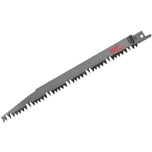

I have an idea for you. If you have a Sawzall type reciprocating saw.
Buy a nice stiff blade for it. I would suggest a pruning blade as they are long enough and quite stiff.
Drill several holes in the blade to attach a wooden/metal extension to it so it can reach the bottom of your keel pocket. Then add a piece of plywood sized to hold a half sheet of sand paper. you now have a skinny reciprocating sander that can reach the bottom of the pocket.
Genius!!

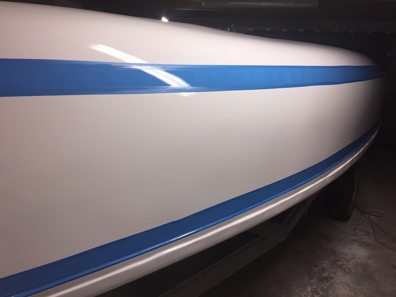

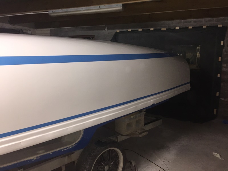

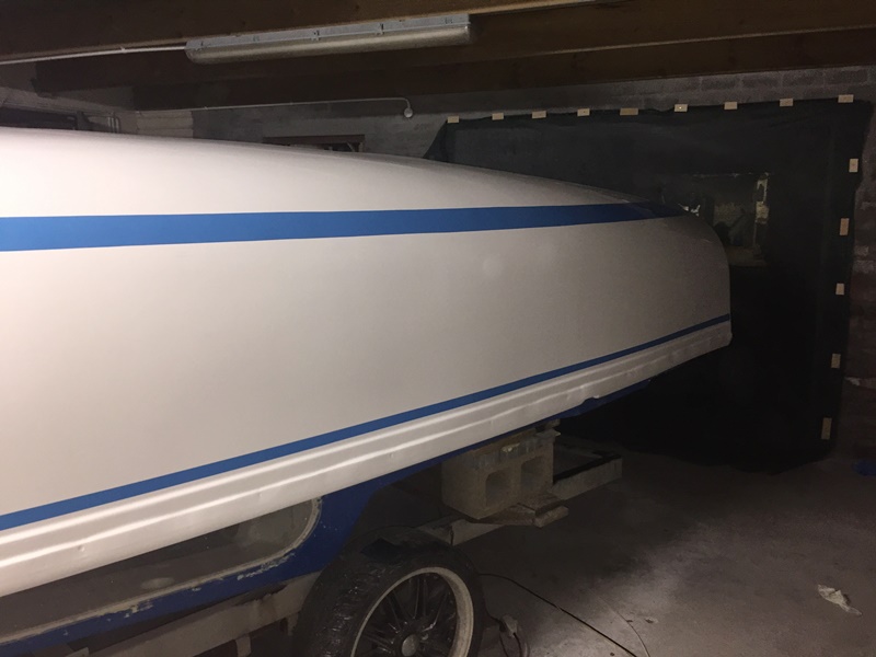

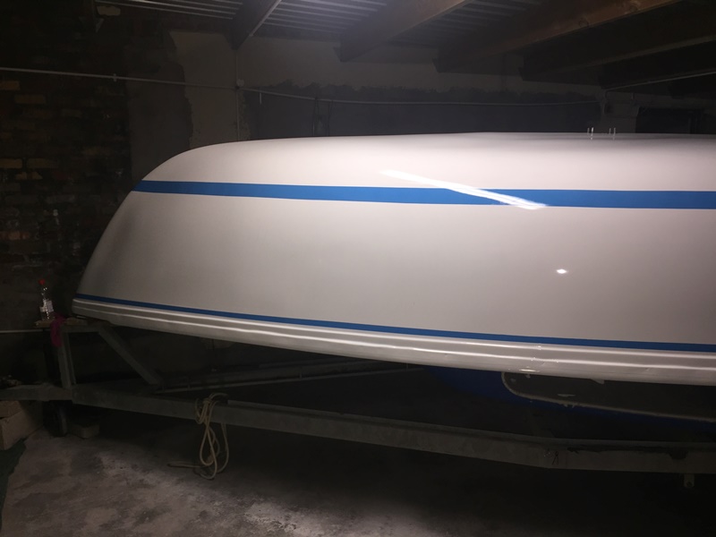

Painting update: The stripes for the water line/boot line (which ever you prefer!) and the cove line as I have heard it referred to!
I have decided to go with a light blue colour - International Toplac - Bondi Blue colour. This was taken late at night and only took one for record keeping purposes! This was also the first coat of the blue. masking tape is also blue so makes the stripes look wider than they really are ... look between the lines as it were :)

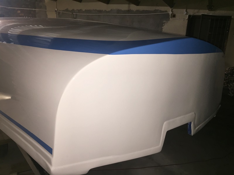

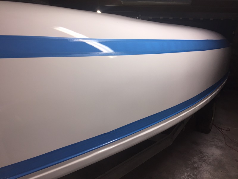

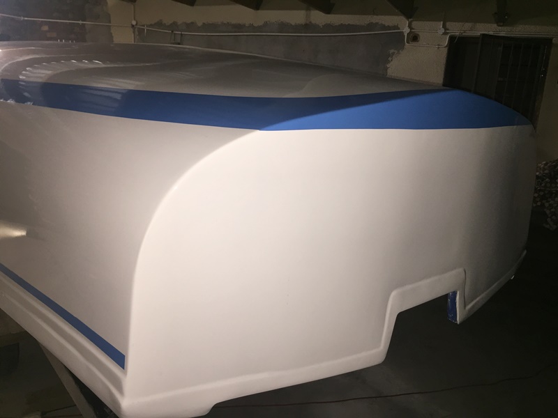

Righto... so the first coat of blue paint has been flatted down with water paper and the second coat of blue paint has gone on. In order to call this part of the project completed I waited just long enough for the second coat to dry so that I could rip off the masking take. This was before I get the silly notion of flatting down and putting on a third coat!
So as of today the hull bottom and side are done... woohoo, and all! It's been a long slog but it's done.
What is next you may ask... the deck, cockpit, coach roof and hatches!
Pictures were taken at night.

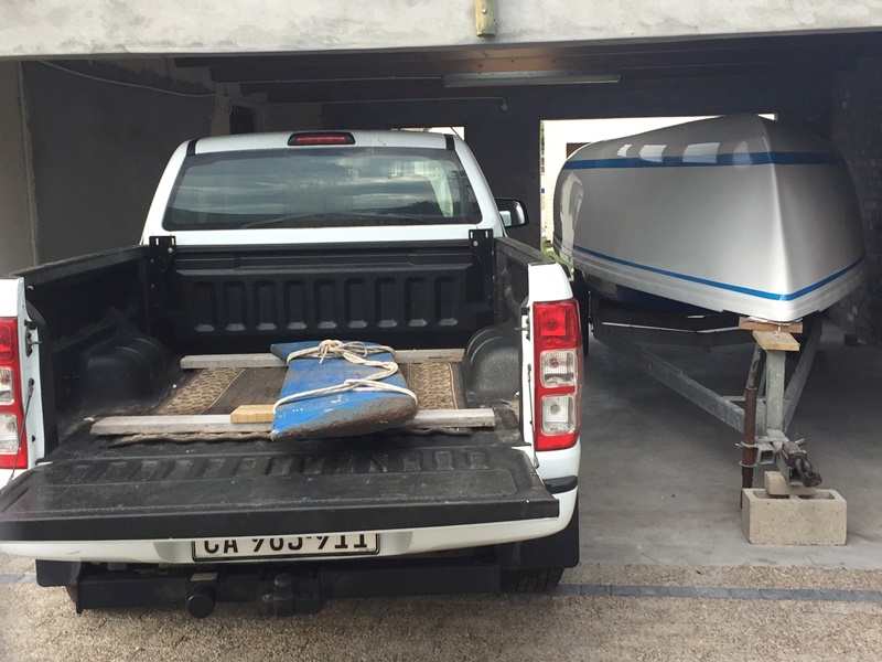

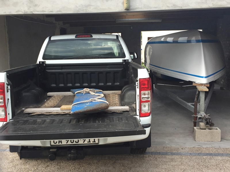

So an early morning daylight shot of my boat ready to turn upright and the keel loaded onto my "truck" ready to go to the sandblasters!
I hope to be able to have the boat upright by the end of this coming weekend...

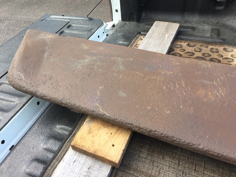

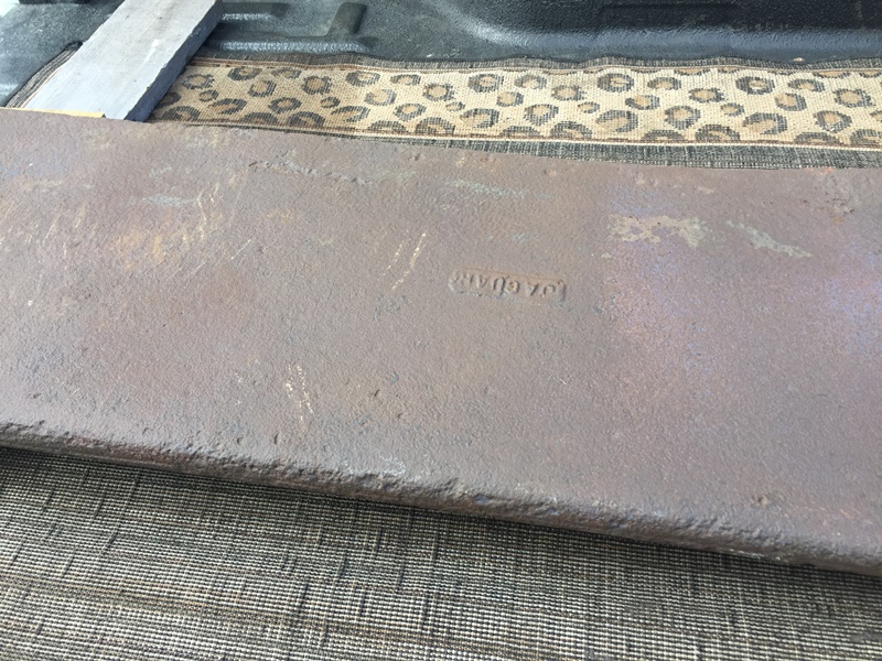

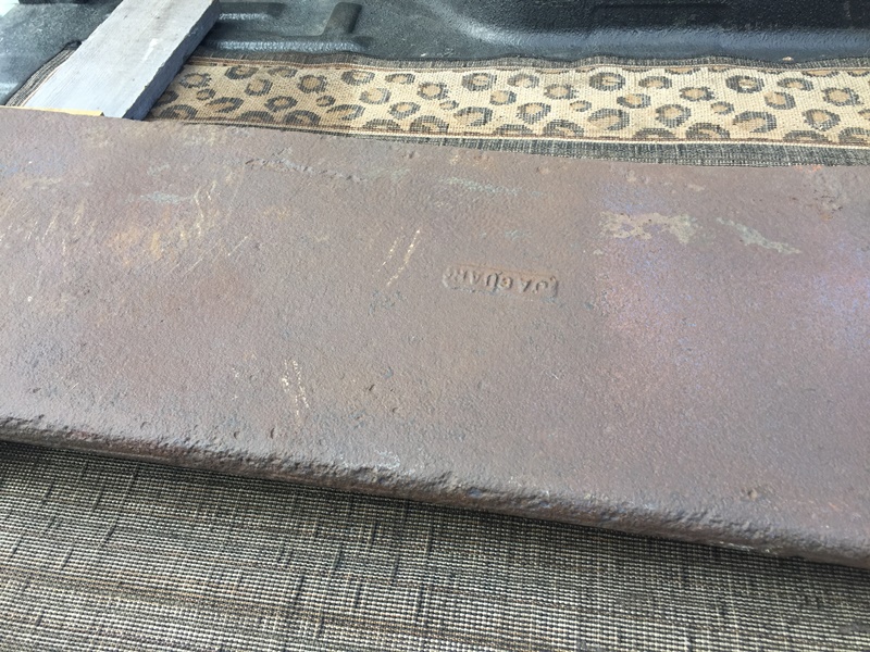

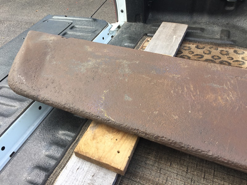

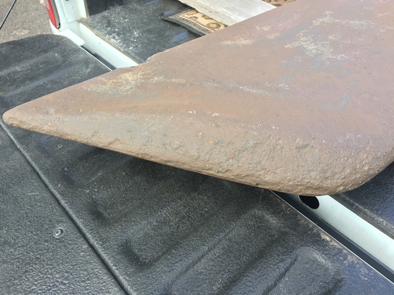

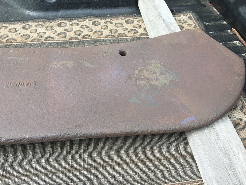

S'pose been a bit quiet... but stuff has been happening! ;)
I got the keel back from the sand blasters... aside from the expected surface pitting and corrosion it is actually in very good shape from what I have seen of other keels on this website. So I will spend some time this coming weekend smoothing down the leading and trailing edges, cutting and shaping the lifting eye-bolt slot and then drilling and tapping out the thread for the eye-bolt. Then a coat of epoxy resin, then a bit of fairing... phew hope I'm not being too ambitious!

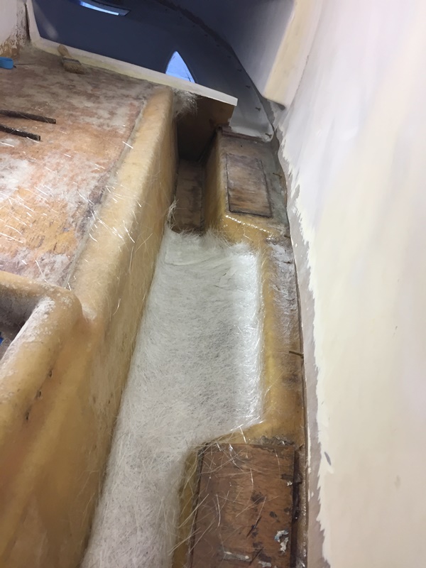

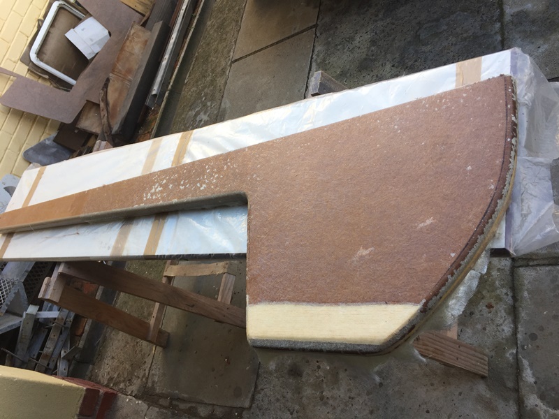

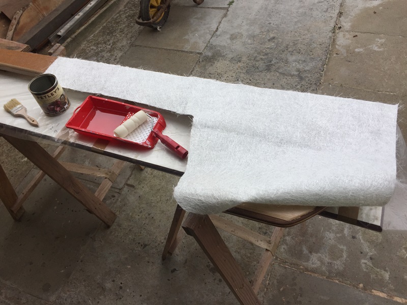

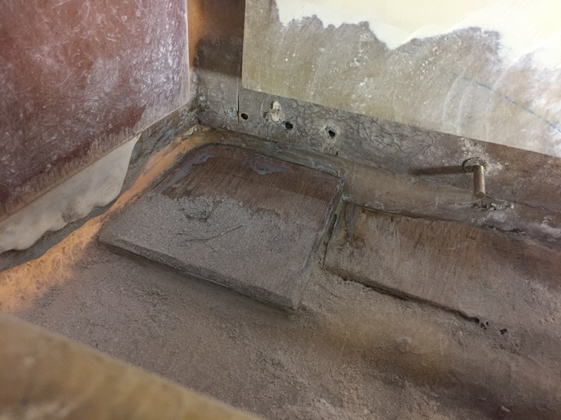

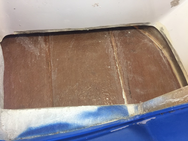

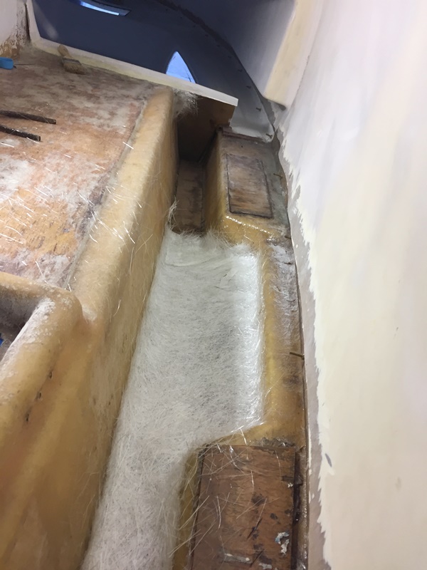

I also did some fiberglass work to finish off the laminating of the transom and the underside of the rear decks where the original plywood was never sealed/coated/covered from day one of being built.
The transom you can see in a previous post where I cut out the inner lining and completely re-laminated it with new marine plywood. Here I am just finishing of the joints between the plywood sections as well as filleting around the edge and hull sides. The photo is showing working in progress.
The rear under deck areas I just dried out the wood by letting it stand for ... erm, two years now... sanded with 60 grit, wiped down with acetone and then CSM glassed over with polyester resin. At some stage I will paint inside these areas. I also added several layers of CSM cloth in areas where the rear stays eye-bolts will mount, the rear fairleads/cleats and the foresail winches will mount. The photos are showing work in progress.
Boat currently still upside down...

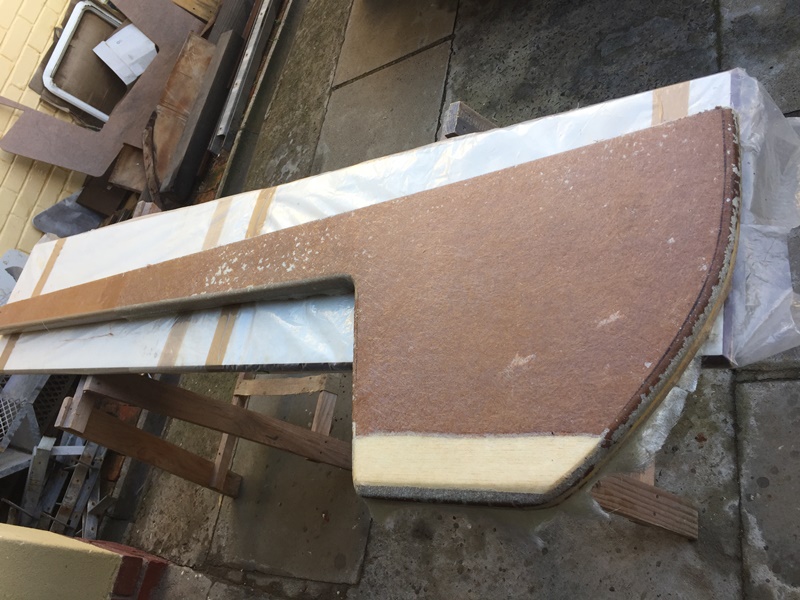

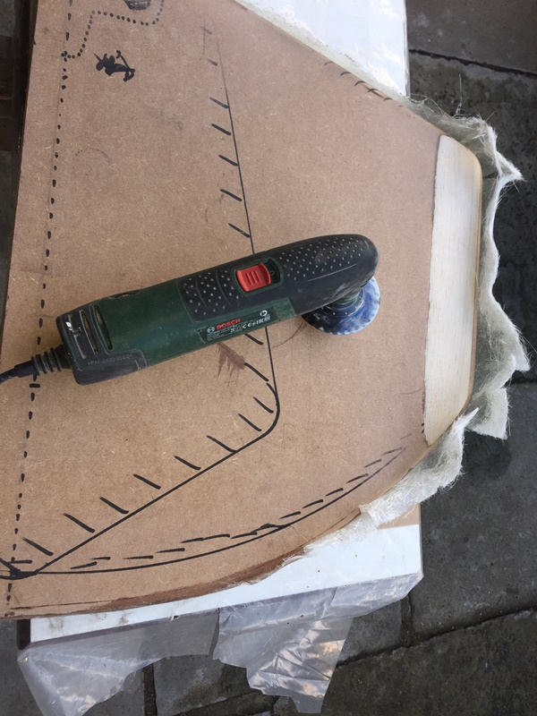

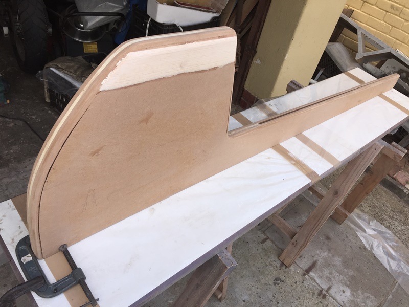

Then I have also been busy with the male mould plug for the keelbox "sleeve insert" that I am going to install. The mould is being covered with CSM and ploy-resin to get it to correct thickness.
So stuffs happening and progress is being made... slowly :(

That keel looks MUCH better than most. Most C22 keels that you see online were U.S. built boats with keels cast in Mexico, at a time when they were not known for manufacturing.
