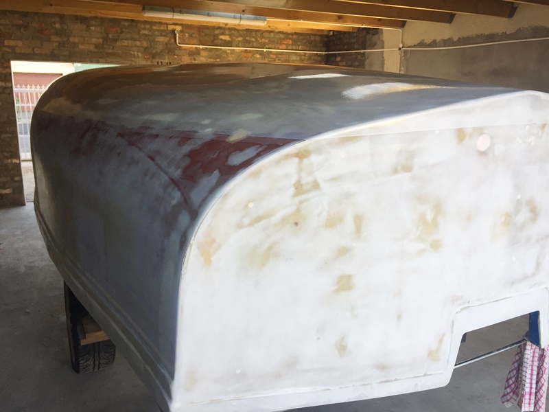

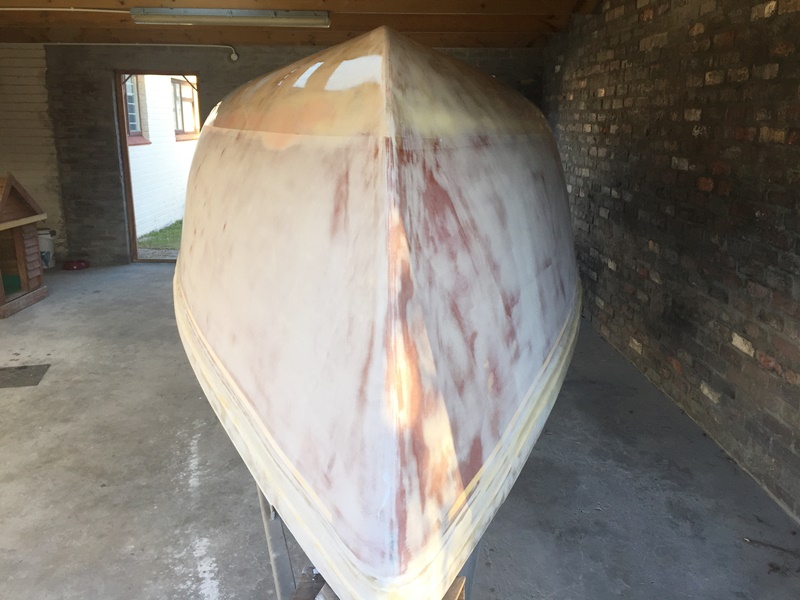

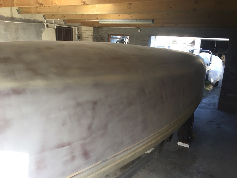

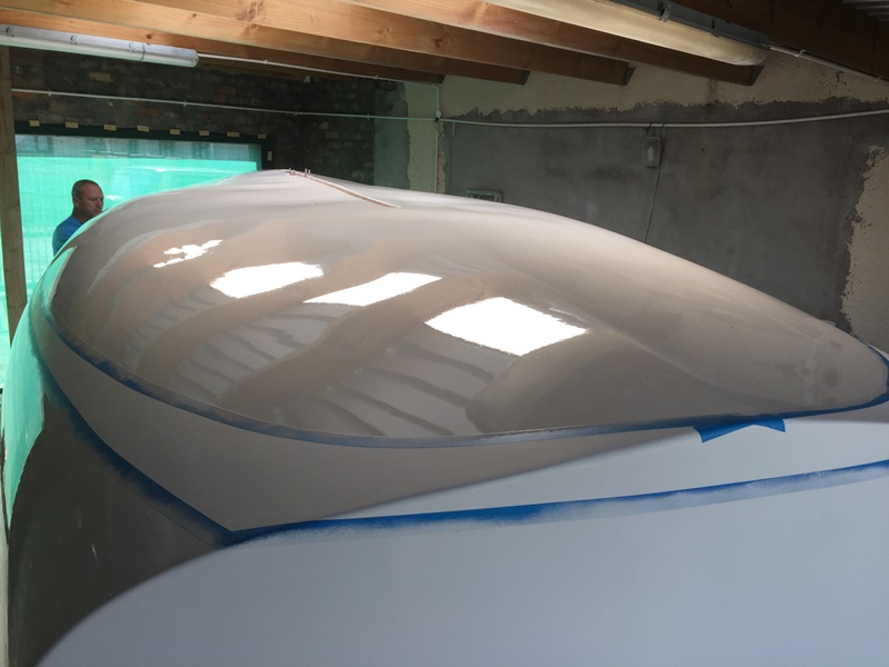

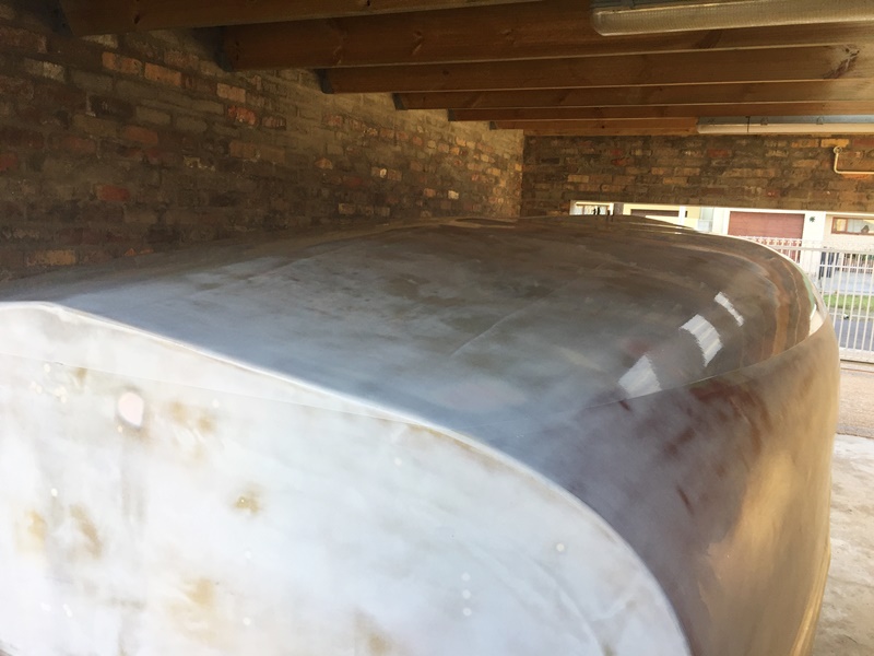

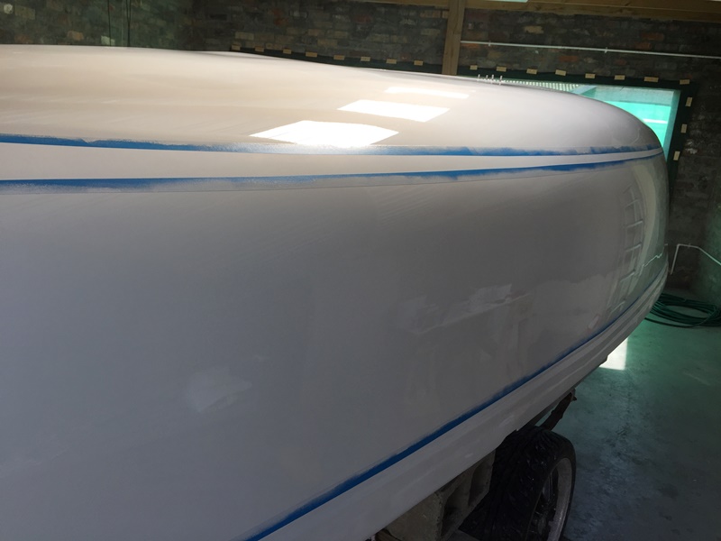

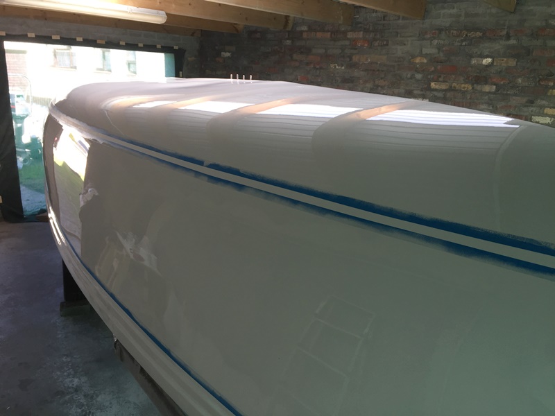

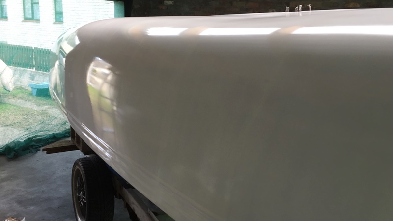

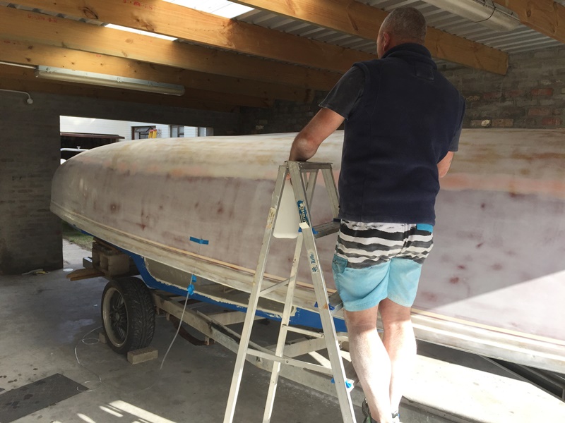

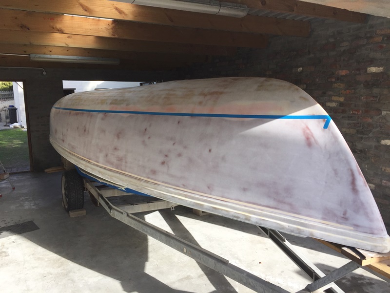

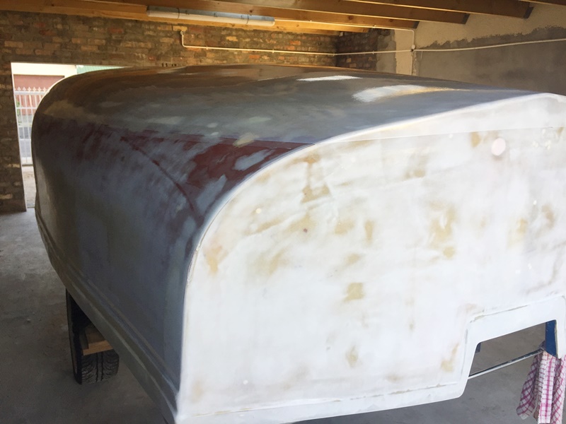

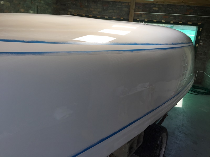

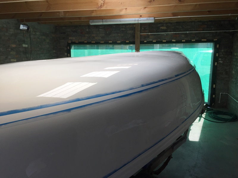

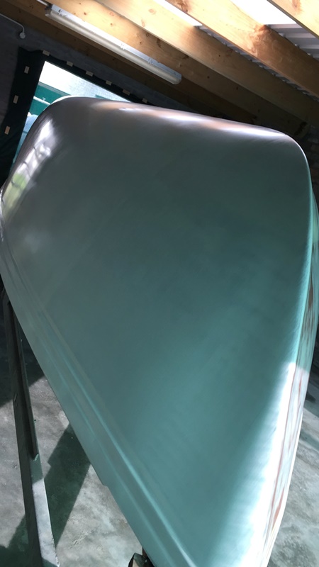

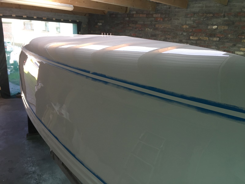

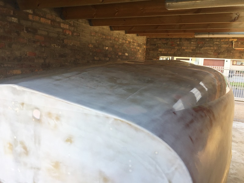

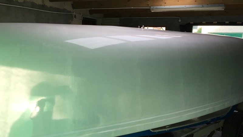

Hull coating update... so after sanding off the bugs and imperfections on the sides, transom and bottom of the hull I was not happy with the bottom. So I decided to actually kill two birds with one stone... Redo the epoxy coating but to water level only. This way the water-plane area is epoxy sealed and I will have a coating thickness "ridge" to follow as a witness line when applying the bottom paint and waterline stripe. Not intending to sand the ridge away, just smooth it down. Took the day off work to do this... and it rained!

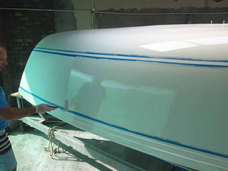

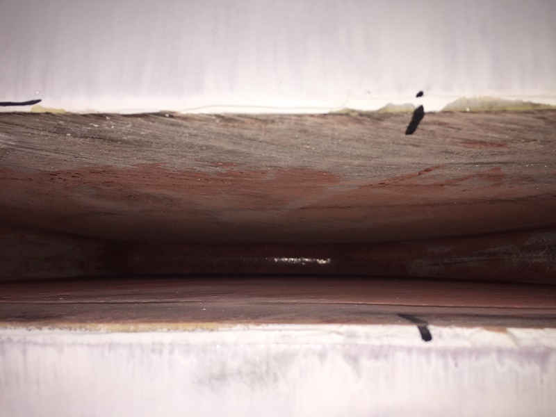

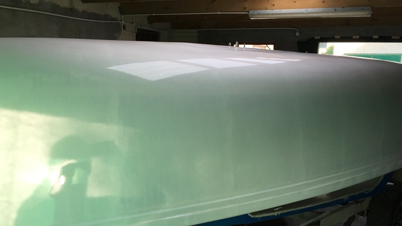

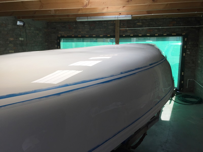

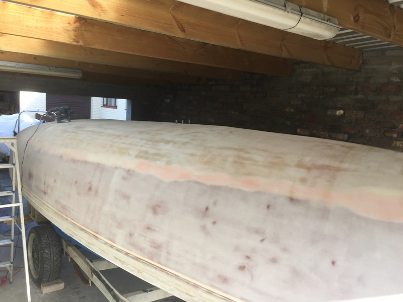

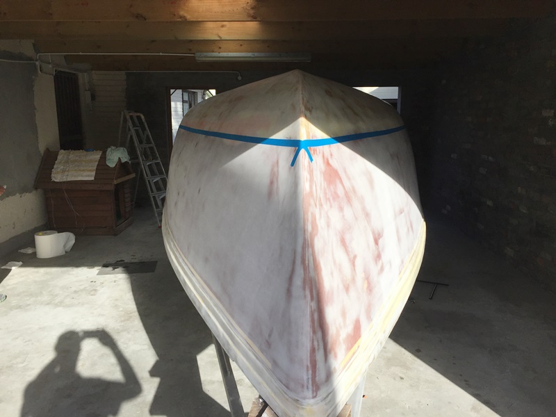

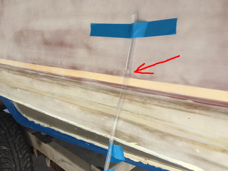

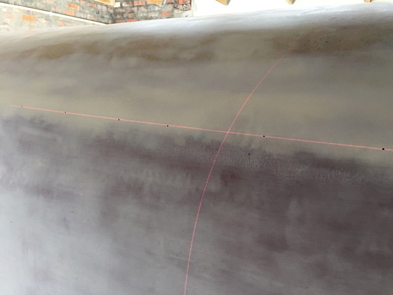

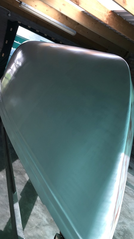

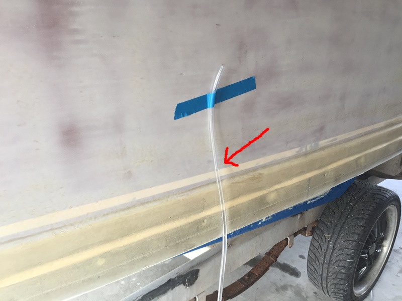

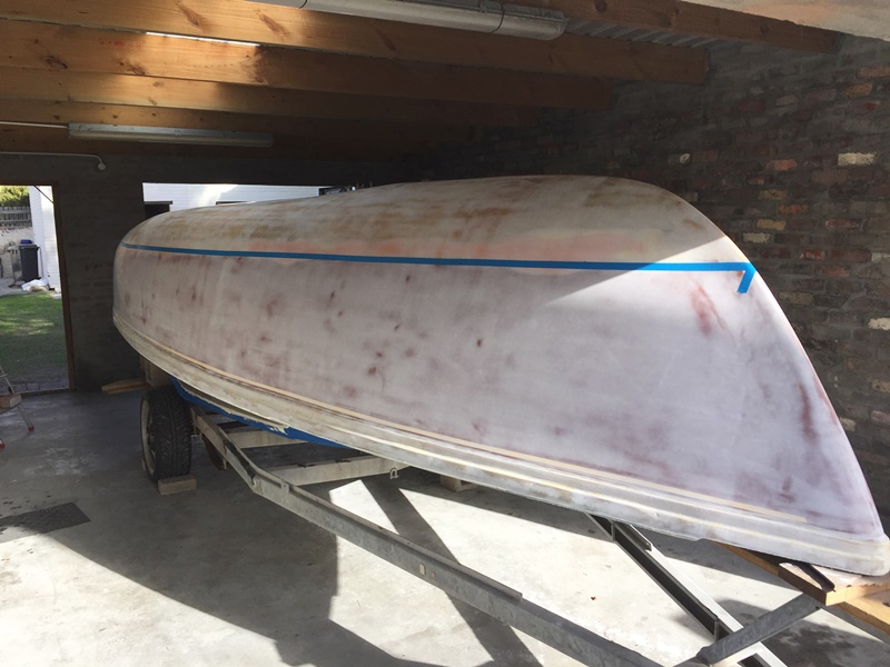

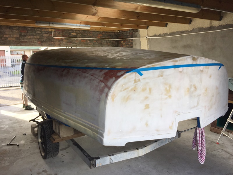

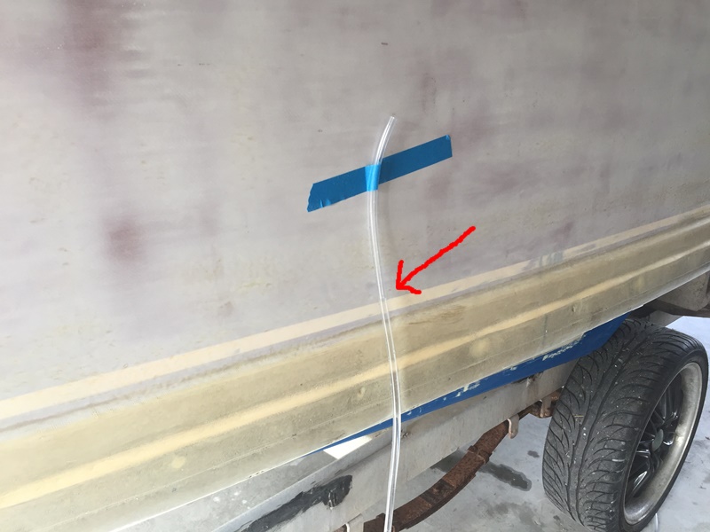

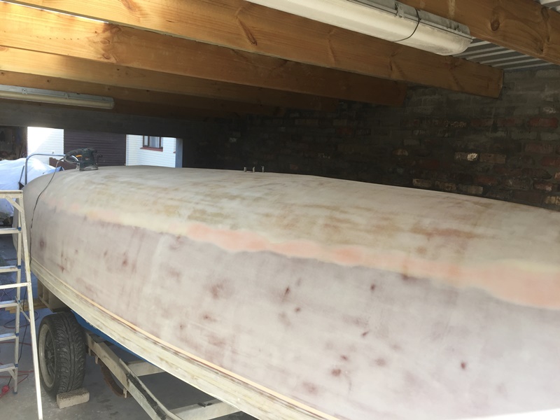

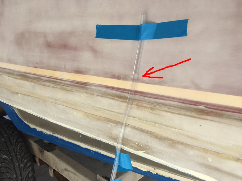

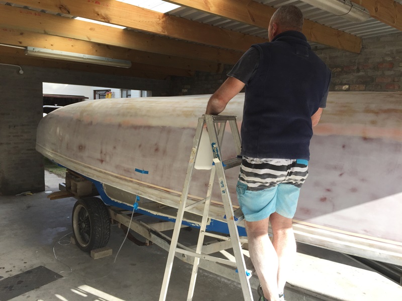

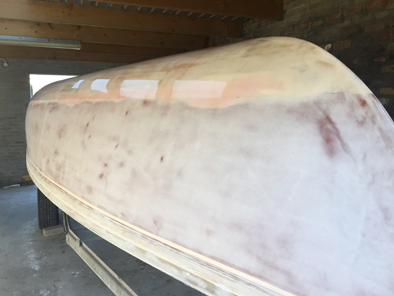

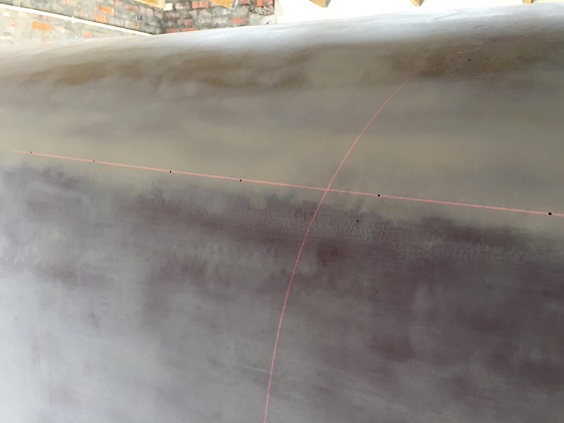

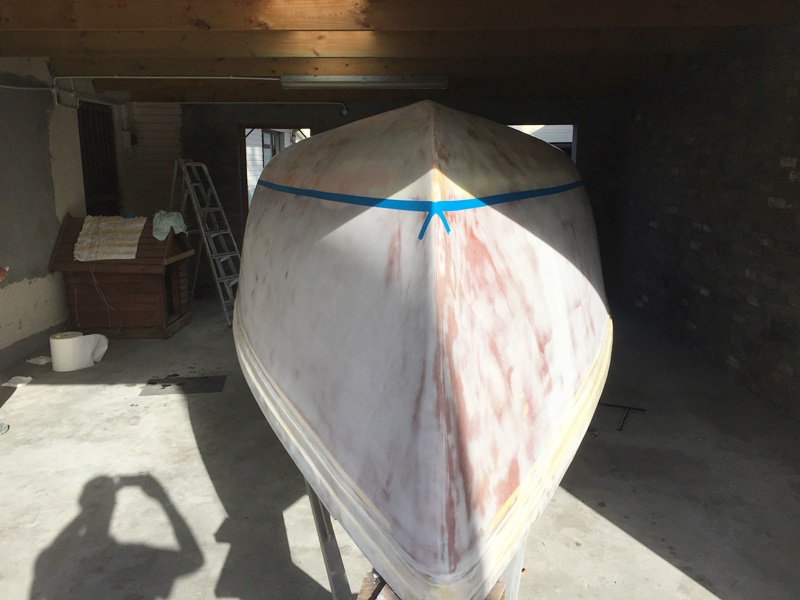

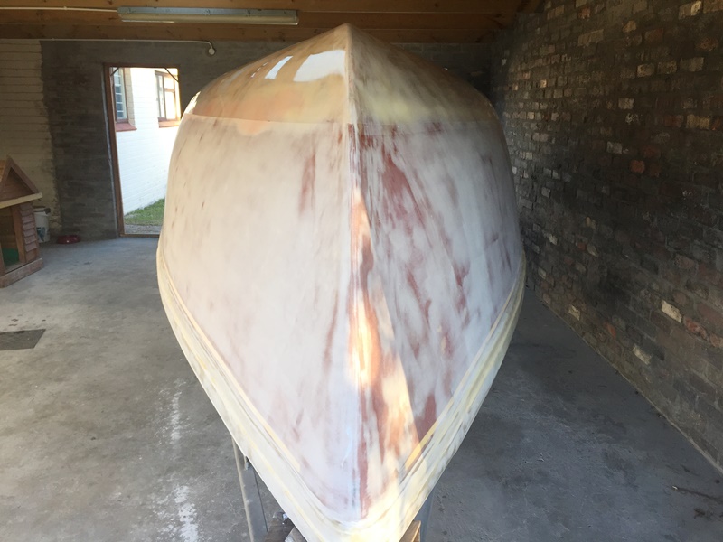

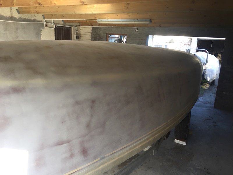

This is the preparations being made. My neighbour and I sanded down the bottom of the boat to just above the waterline area. This was followed by cleaning, washing, drying and then acetone washing. I leveled the boats waterline forward and aft using a clear plastic tube with water! I used the original marks for this on the bow cut-water and along the transom edges. Then I leveled the boat port/starboard the same way with the water level gauge! Then I set up my laser level projector and simply marked along the laser lines... easy peezy lemon squeezy! I then ran some masking tape around the hull following the marks.

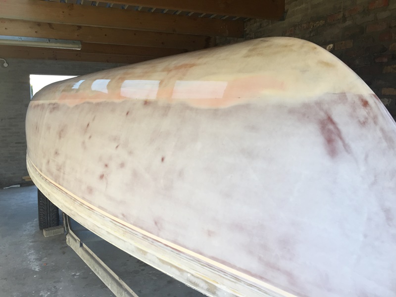

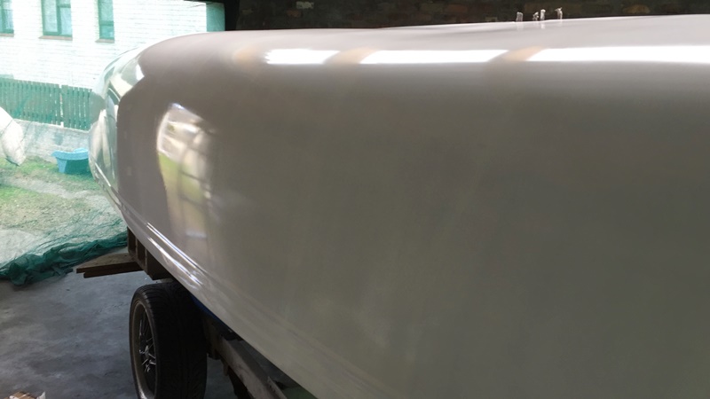

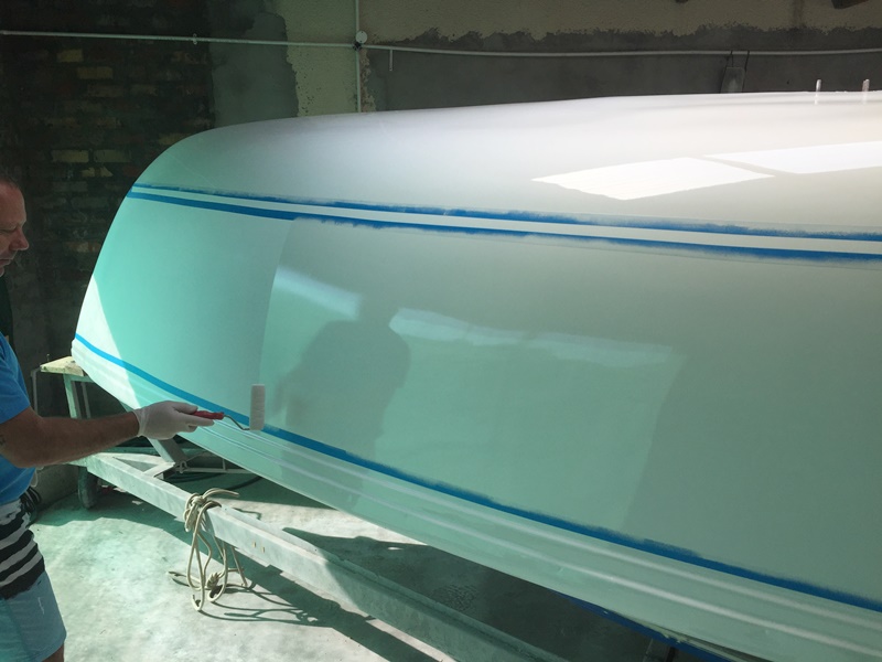

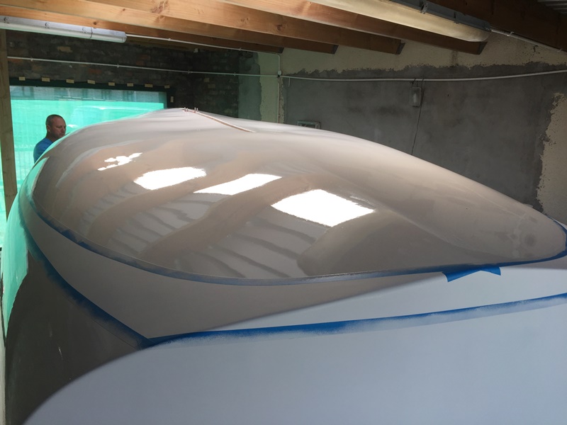

Very happy with the setup. Did not take after coating photo's as it got to dark (my battery died!)
