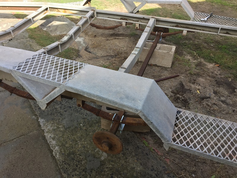

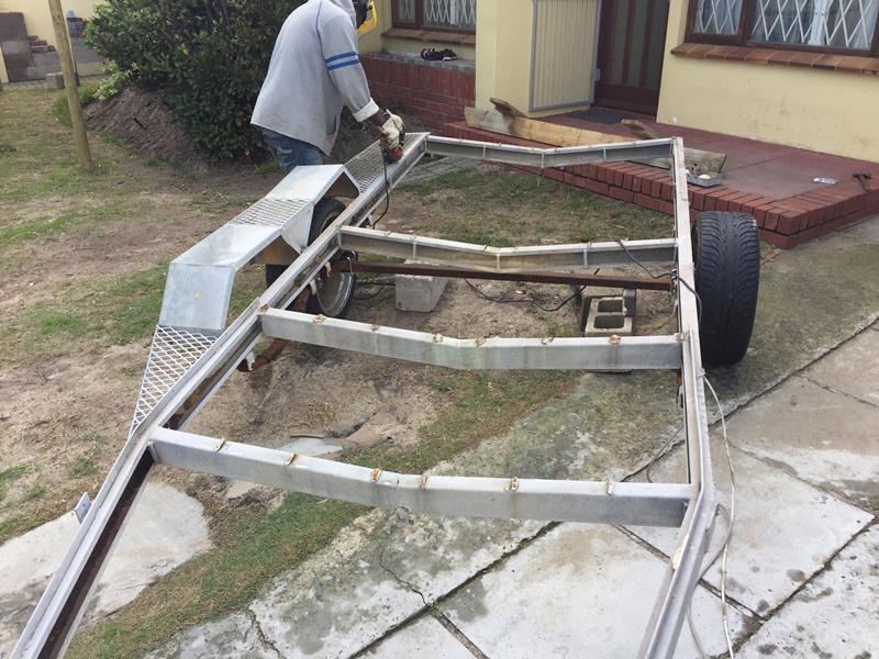

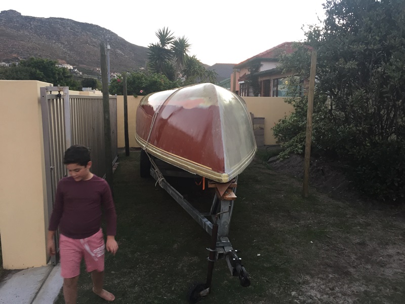

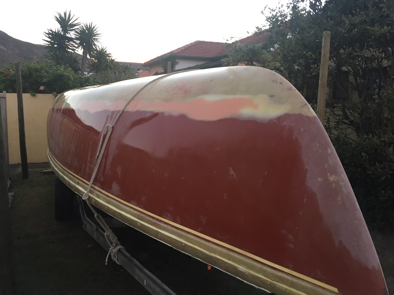

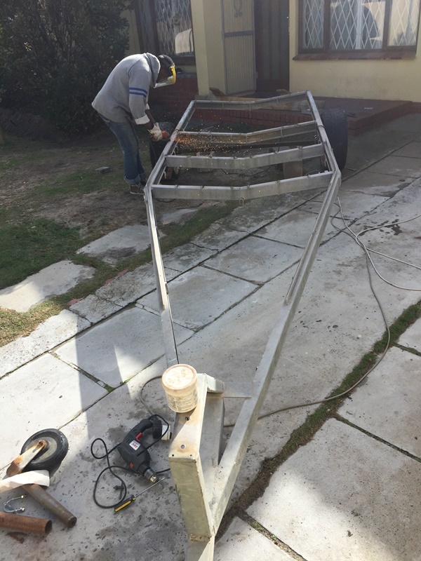

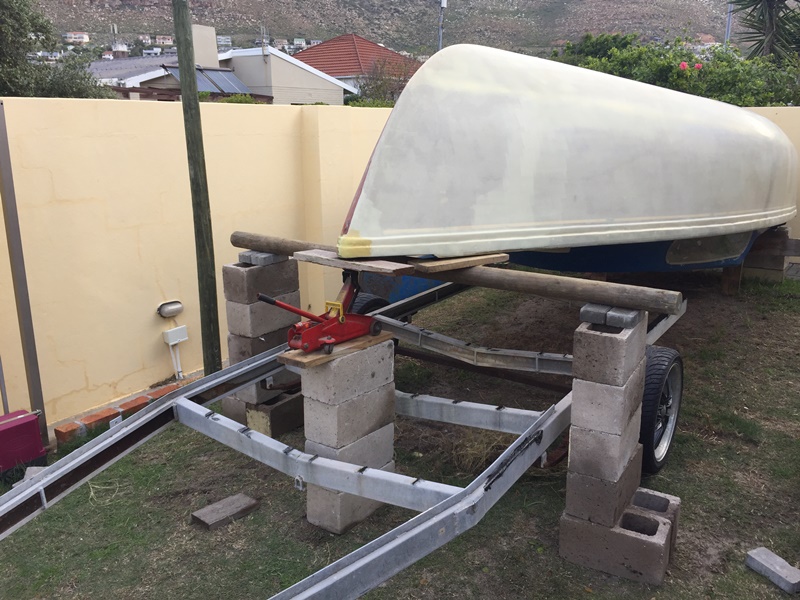

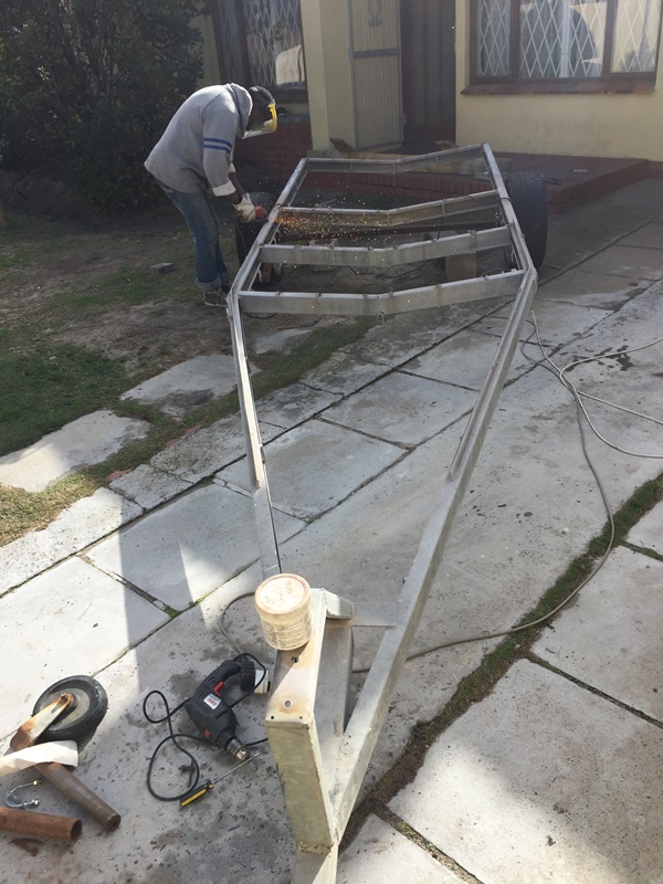

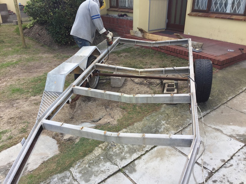

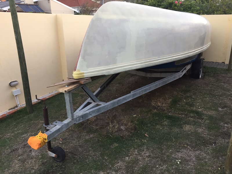

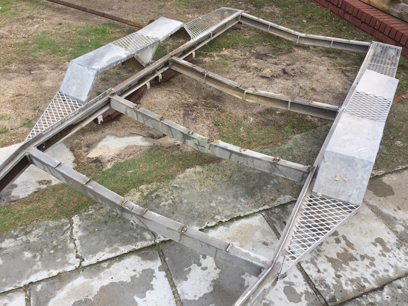

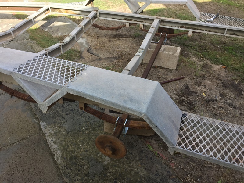

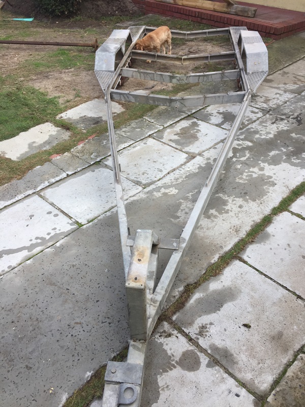

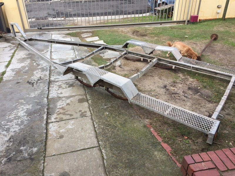

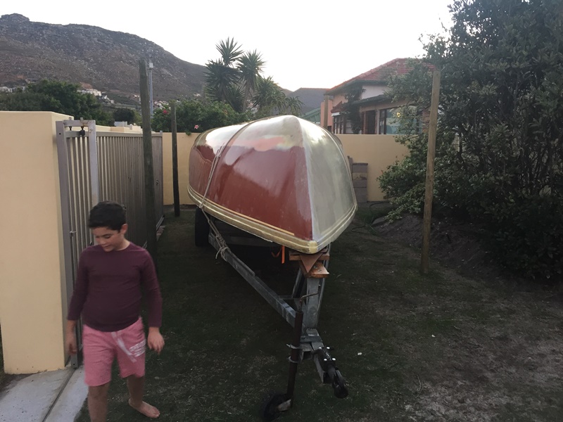

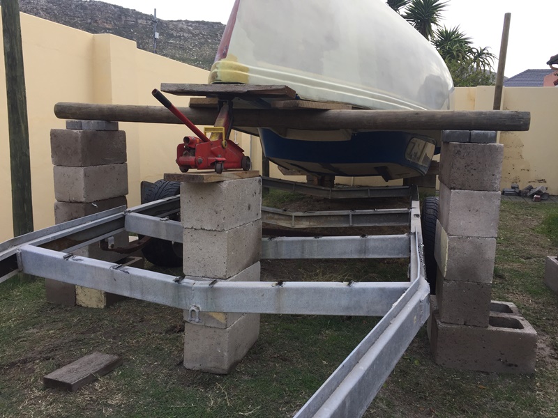

So it has come time to prepare the trailer that i bought some time last year. It was a vee-hull motor boat trailer which has now been put to much better use = a sail boat trailer!!!

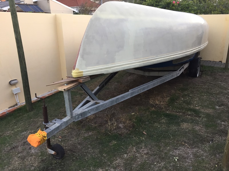

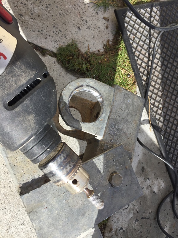

So cut away all the Vee-hull support brackets, cleared away the heavy and already half broken off wheel mud gaurds and side walks... all I am really interested in is the actual main frame. I also had to enlarge the jockeywheel bracket hole for the larger sized tube and actually shorted the trailer tounge length by about half a meter. I only installed one of the old axles for just transporting the boat across the road. I also only made VERY makeshift boat supports until such time as the hull is painted and we flip it back over "CloudDiver" style. Then I will need to fabricate the bunks.
