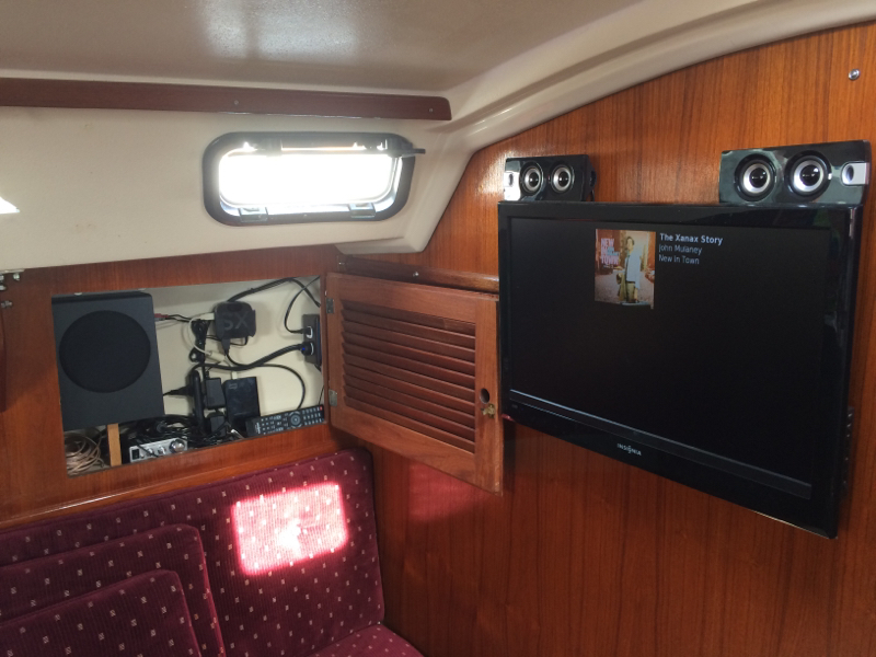

I installed a 12 inch dual coil subwoofer under the seat that is below the LCD screen shown in the prior pictures. My Cat 30 has the full wrap around seating. Mounted the sub amp under the chart table. Really enjoy it. Bangs hard all the way to the cockpit under sail.
Alec
