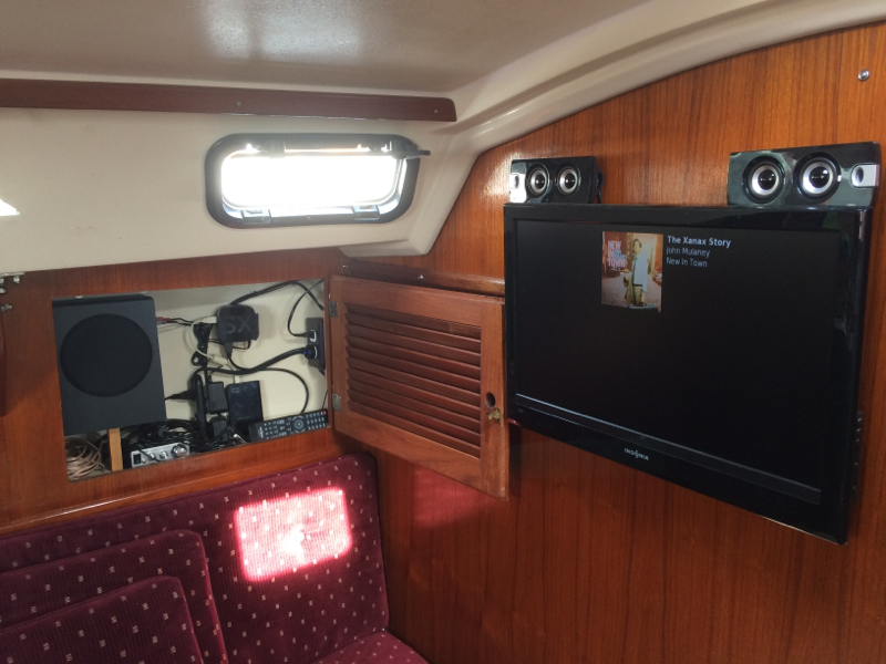

I ended up connecting the yellow wire directly to the house battery only. It's better than having a lobotomized sound system every time I go on it. I ended up buying the Pyle $65 sub amp which is more than enough, and I first tried using the existing starboard side cheap car speakers as subs, but they're just to low quality and have no excursion capabilities and can't handle any power. I can get them to supplement low end at low volumes, but I'll have to change them out. I found some 6.5" woofers I had laying around:
https://www.parts-express.com/goldwood-gw-206-4-6-1-2-oem-woofer-4-ohm--290-300
And they look like they might work a LOT better. I'll have to work on dampening the cupboard space above the closet (the doors rattle), but I think I can make this all work without buying a dedicated sub and using existing holes. But, if it still doesn't sound good enough, I'll consider getting one of the self powered ones, I like the kicker one you found.

Subwoofer installed. The port side cabinet has all the media equipment installed.
