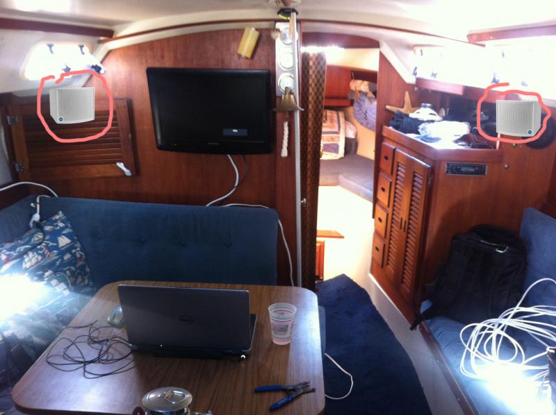

My downstairs will be more of a home-theater type setup. Sorry for the messy cabin, I've got things pulled apart and doing some wiring at the moment. But, I photoshopped where my little speakers will be going.
I'm going to just try and use the existing speakers as pseudo-subs with a separate amp that has a crossover adjustment and see how it goes. If it isn't good enough, I'll first try different speakers, then if that isn't good enough I'll put a real sub somewhere.
The Fusion sub/amp thing is cool, but a bit pricey for what you get I think, but it is a simple solution for sure. It's only 25WRMS per channel though.
