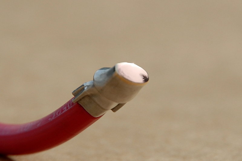

Keep in mind that nearly every industry uses crimps reliably, without solder, including aerospace, space, automobile, medical, laboratory, truck industry, heavy equipment and have been for years and years and years. I was working on my neighbors John Deer tractor a few months ago and every single connection in that tractor is crimped.
The artesian well at our old house was 245 feet deep and was a true artesian. It over flowed/bubbled out the well cap almost all year. The crimped butt splices were about 240 feet below ground and totally submerged... These wires connecting the well pumps are crimped and adhesive heat shrunk with what are called Stakons (basically adhesive lined butt splices). These bare copper, non-tinned, wires have been under water now for approx 16 years only crimped and heat shrunk. I think that today that same well pump is still going strong..
Crimping solder tinned wire:
If anyone gets really bored NASA has some great wiring standards as does the US Military. It is exciting reading (NOT). My crimp tools all meet or exceed MIL-T- 7928G because it is the most stringent for crimp terminals. The ABYC standards for crimp tensile strength, by comparison, are PATHETIC....
Keep in mind that crimping solid copper wire or solder tinned wire can also damage the dies on the crimp tool and throw it out of calibration..
Here's what NASA's standards have to say:
"4.3.4 Crimping Stranded wire shall be used for crimping (Requirement). Crimping of solid wire is prohibited. Crimping of solder tinned wire is prohibited."

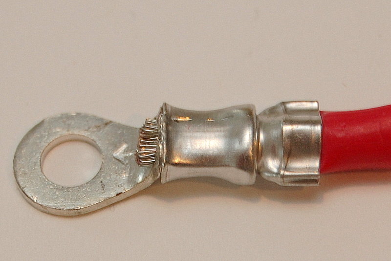

Soldering after a crimp has been made is fine provided you:
*Know what you are doing, IME most don't. (in my line of work that amounts to about 98% of what I come across did not know what they were doing when it came to solder.).
*Use a heat sink to prevent solder creep up the wire.
*Use the correct solder.
*Use the correct wire prep or rosin core solder. (Non-activated R or NC or a high quality RMA rosin core flux from a known and trusted manufacturer are about the only products that should be used in the marine environment. Be aware that there are many RMA fluxes out there that are not acid free. Get this acid into the fine strands and it can be impossible to clean out and will lead to corrosion.)
*Use proper strain relief or adhesive lined heat shrink.
*Use the proper crimp terminals for crimp/solder which are different than typical insulated terminals and rarely as robustly built as the insulated ones or heat shrink ones.
Crimp/solder terminals utilize a B or F type crimp also known as D-Sub etc.. They are extremely tough to find in a good tinned robust build AND they require a specific crimp tool..
Image Courtesy Innova
*Use the proper crimp tool for the solder/crimp terminals which most don't own or have on-hand if they have been using a crimper designed for insulated crimps.
In short doing crimp then solder requires different tools, proper training and more labor than just using a good quality crimp tool and high quality terminals..
There are billions & billions of crimps in use world wide, maybe even trillions. Yes solder makes a great electrical connection, no one would ever dispute that, but apparently it is very tough to do correctly & from what I see on boats...
People botch crimps too, lets not kid ourselves. You can't get caviar results with a dime store tool and dime store terminals, but people try all the time.;)

Proper tools, terminals and techniques yield excellent & repeatable results:
Crimped Yellow Terminal & 12GA Wire
Insulation Removed:
Cut at the crimp band:
Another View:
