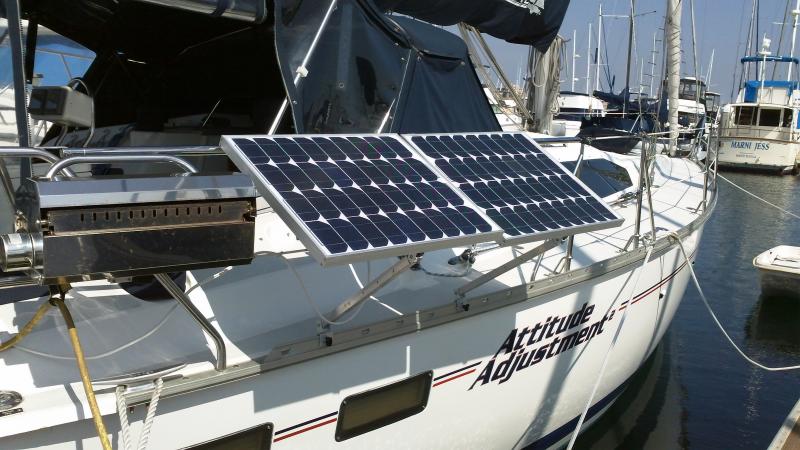

Do you have the panels mounted? How about some pictures and which controller did you end up getting? Will do. These will only be used when I am off to my island mooring for five days or more. The four 50 watt panels will hang from S/S tubing I used to replace the upper aft lifelines. I made telescopic mounts that attach to the toe rail that will allow some orientation to the sun. I'll post some pix after I get it set up. The MPPT controller is one from a US distributor branded for his own company. Reviews were decent, but it looks a bit hokey to me. We'll see how it works out.

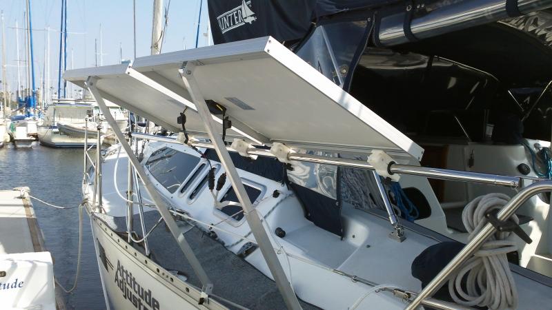

Update on Temporary Solar Panel Installation
So, I got my mounting hardware squared away. Everything is wired in. The panels fit in the dock box once I got rid of a bunch of stuff I had there (brought home a coffee can with a bunch of bronze wood screws from my wood boat 40 years ago). The output was only 5 amps with the batteries down 18%, but that is in a marina and with the sun angle lousy, so I figure half is about right. I need to tidy up the wiring, put some strain relief on the panel wiring, etc. I left off the blocking diodes and put switches in line after the fuses. They are not water proof but I'll put them in boxes later.
