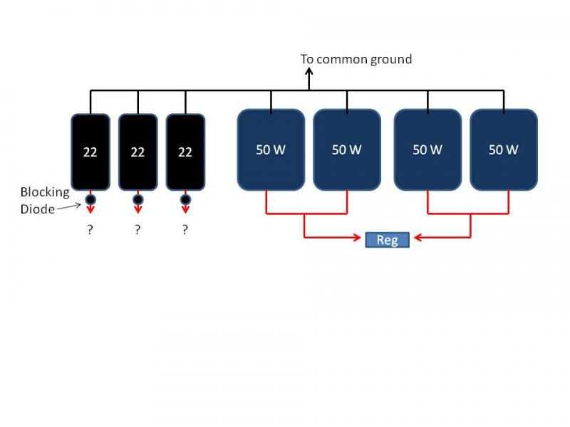

I have three solar panels now on my boat which are flexible panels I use when I am on my mooring. They are 22 watts each and ganged together and go to a regulator. They each have a blocking diode.
However, I am planning to add four 50 watt panels to the system and a 15 amp regulator, I am planning to gang two of the panels together on each side of my installation so that the regulator will see it as two individual panels rather than four. However, the panel description makes no mention of a blocking diode, rather just the junction box.
So, my question is: should I add a blocking diode to each panel or will the regulator do the job for me? The regulator does have reverse discharge protection.

if all the power will be going through the regulator and the regulator has a blocking feature then you do not need blocking diodes on your new panels. You can take them off your old panels and have 0.5 more volts or a "massive" 1 watt increase in power output.... probably not worth it.
Another thing to consider, if your flexable panels put out 16 volts and your new rigid panels put out 18 volts and you connect them in a parallel fashion will not the rigids overpower the flexables. This is similar to using different battery types together. if the voltages don't match then you get problems. Perhaps your regulator can handle two different types of panels. If that is the case then you would want to keep likes together. In any case if the blocking diodes on the flexables sees a voltage greater then the forward voltage from its panel it will just shut down its panel. 0 output.
Also 4*50+3*22=266 watts of panels. that is 266/14.4=18.5 amps!!!! and you are buying a 15 amp regulator???????

A closer read suggest we have some confusion as to how you are going to wire the panels together. I assumed you would not be putting any of the panels in series with other panels.
You mention 3-22 watt panels but I'm thinking you are only putting the four new ones on the regualtor?
This is what I think you are describing.

...first, thaks for all your help. I am planning on running two of each of the 50 watt panels in parallel and then to the 15 amp regulator which will then see the panels as two 100 watt. I am planning on leaving the regulator for the three 22 watt panels in place and regulating the 50 amp panels separately as Bill noted.
The reason for all this is that the three 22 watt panels sit on my bimini and are never used underway. The 50 watt panels will hang on the rails I used to replace my aft upper lifelines. The reason I did not simply go with two 100 watt panels is that I need to store them in my dock box and the 50 watt panels will do the trick. I only want them when cruising, not day sailing or racing.
So, I was referring to blocking diodes, not pass through diodes. I am double checking myself to be sure there isn't a problem somewhere along the line with what I propose. There are good resources on these boards, so I figured I should take advantage of them.

If I'm reading the above correctly I think you are making things more complicated than needed.
We have 3 panels on the Mac, a 40,60 and 100. They are all the same type panels and operate with the same voltages. They are all wired ....
.... to a common terminal strip (shown above without the panel wiring that is attached at the top). The terminal strip is under the panels in the lazarette. Then there is a pos./neg. wire from the terminal strip going forward to the ...
....Blue Sky MPPT controller (bottom right arrow). For the controller to be most efficient the panels should be of similar construction and operating voltages. Also size the wiring for minimal voltage drop to take full advantage of the panels.
The terminal strip allows us to remove any or all panels pretty quickly. Be sure and read the charge controller instructions on disconnecting panels to make sure you don't damage anything. I have a switch that disconnects the charge controller from both the ship's batteries and the panels at the same time.
Rick,
Two charger controllers together can do battle with each other and panels of differing voltages should ideally not be used together on one controller or you can bring the performance down to the lowest common denominator.. When in bulk mode it won't matter one iota if you have two controllers and both sets of panels can pump in the most thay can get from the sun. This is because neither controller is the "voltage limiting" phase at that point.
The alt however can usually get you back to absorption voltage then the controllers and solar need to take over to get you back to 100% SOC. The problems can occur when you're in absorption charging and things can get quirky between multiple charge sources..
It would be extremely rare that both controllers were set to regulate to the same exact voltage and as such the one with the highest voltage setting will win. The other controller will likely just shut down, if a shunting type, as it is seeing the bank voltage is above its absorption voltage set point. In some cases the second controller will never turn back on unless you take the other controller with the higher voltage off line or drop the bank back into bulk mode where the controllers can't reach 14.4V or what ever they are set to. With two controllers you'd want the one for the 200W of panels to have the higher absorption voltage so you don't give up their performance..
I had a customer this summer who was getting horrible output from his two 80W panels. About half or less than what he should have been getting, or thought he should be getting. He bought them as a kit and each panel came with a controller so he wired them both into the system. Both controllers were identical models and brand. Still, one controller was set about 0.06V higher than the other for absorption voltage and the other one simply shut down or "shunted" because it sensed that the system was over its regulation voltage. The result was that it took considerably longer to charge his bank than it should have.
I wound up replacing both shunting controllers, as neither controller could handle both of the 80W panels together, with one Morningstar ProStar 15 PWM regulator and he was fine. Lucky for him both panels were identical and thus no differing panel voltage issues. I cut his time to "full charge", from where the alt left off, by days just by putting both panels on that one controller.
With your panels you're a good candidate for an MPPT controller but be sure to look at controllers that allow you to adjust the voltage up beyond the controller for the flexible panels.
