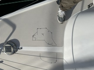

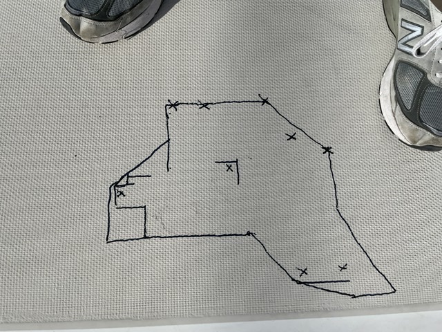

So sad that on Tuesday I started to address the soft areas on the foredeck. First discovered this problem when I noticed a cracked more-or-less heel sized damaged spot on the starboard side.
You can see the impression above the bottom left edge of outline.
The outlines include the area identified as soft with hammer taps.

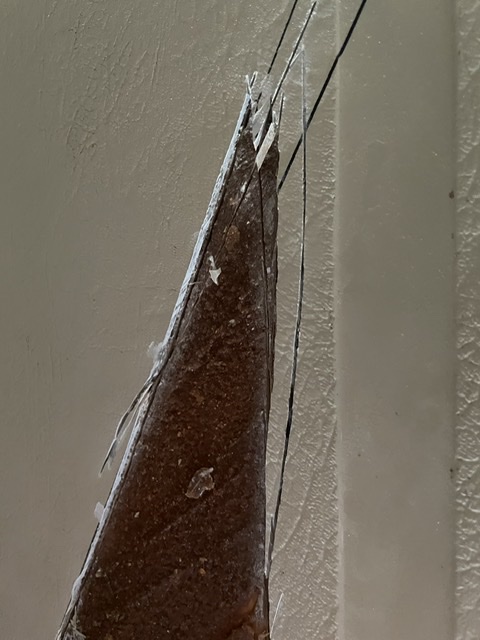

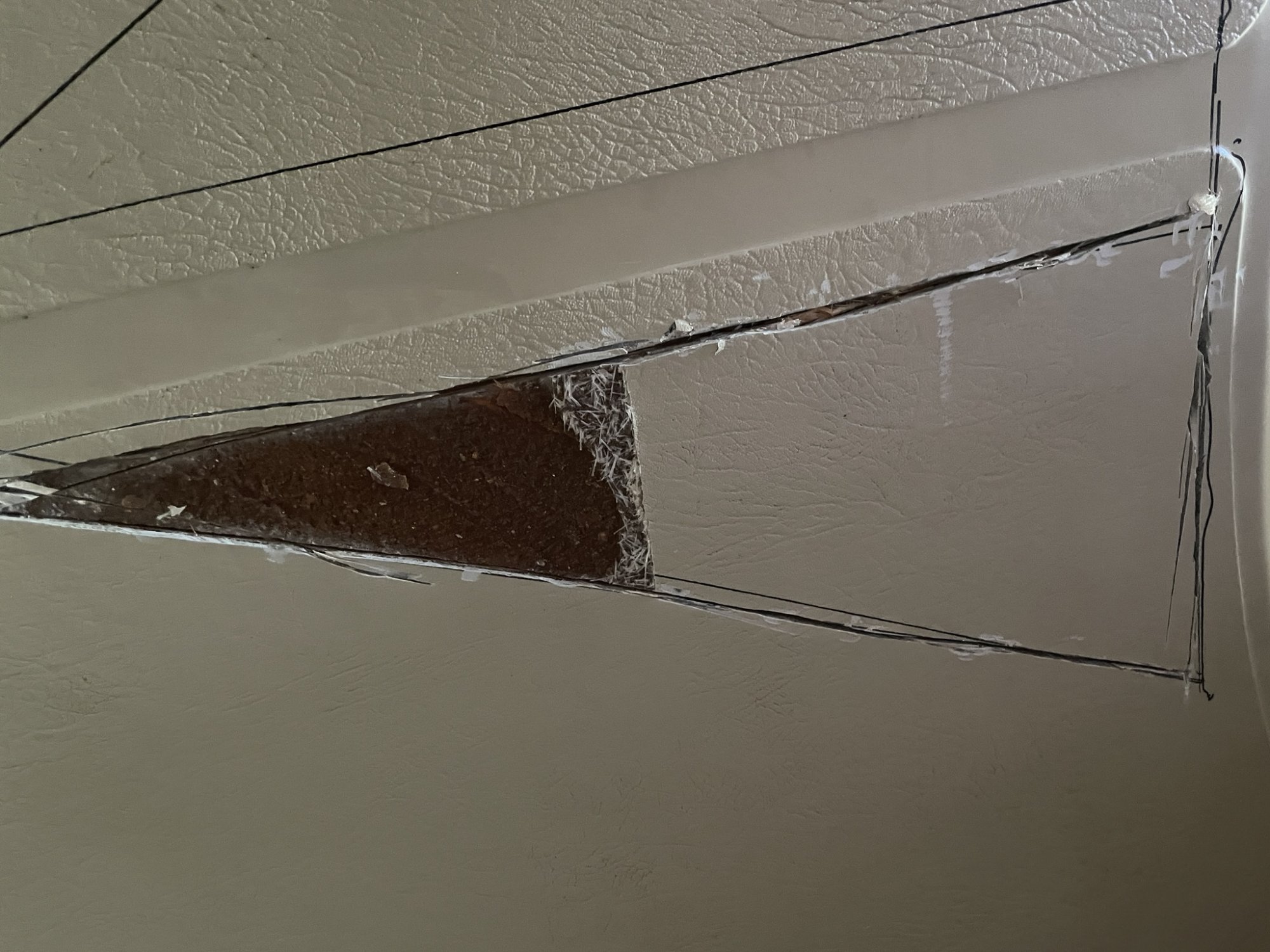

Following the advice of Allan Vaitses (The Fiberglass Boat Repair Manual) I am getting to the core from the interior. I’m cutting with a DeWalt oscillating tool with semicircular blade. I thought this would be safer and cleaner than a mini circular saw, although a small saw would have had depth control, which the oscillating tool does not. Here is the result:
You can see I made a mess of the cuts. A mini circular saw probably would have been been better. Anyway, the tip of the triangular area easily pulled away from the core and broke off from the larger area. The rest of the triangle, which points forward, is firmly attached to the core.
I’m not sure what to do next. The soft area outlined on the deck can’t be fully exposed yet, but the strong attachment of the headliner to the core makes it seem like overkill to rip it all off.
Damaging the interior of my boat this way hurts, but at least some of it needs to be done. I’m just not sure how far to go. Any thoughts will be most welcome.

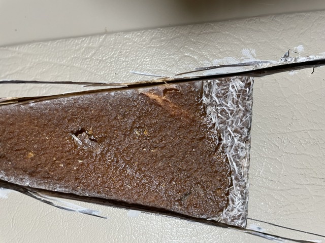

Thanks for the thoughts jssailem & denise030. The area of concern is shown in my photos of the deck. It isn’t large. Today I lit up the area revealed by the broken off liner.

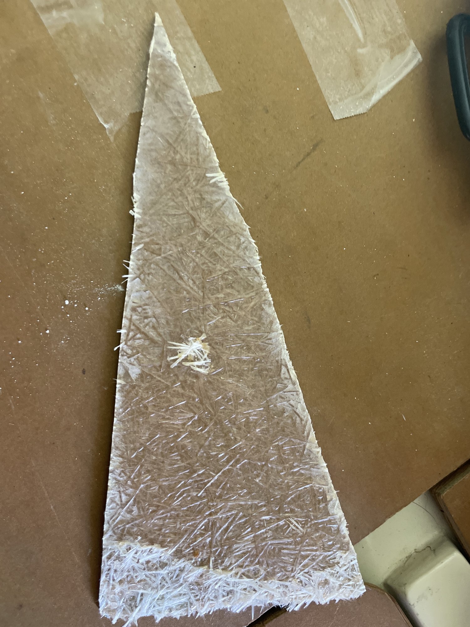

You can see the core and it is plywood that looks practically new. So no rot or decay. It is 40+ years old!! The delaminated piece of liner was the way it was left when built. The thickened resin did not fill here between liner and core. If you look closely there is a lump of hard clear resin in the middle that probably contributed to the issue by separating the liner from the core. Here’s the inside of the piece of liner
I
There’s no thickened resin on the glass. What’s more, the glass is poorly impregnated with resin. There were lots of voids in the glass on the hull when I looked, and we repaired all of these. I’m suspicious that the other soft spots result from poor glass work.
I do not want to tear the boat up any more to find construction issues. I will inject epoxy under the deck in the soft areas, repair my interior damage, and call it done. She’s an old, good boat, and although I prefer perfection, this does not look like the normal core deterioration that would demand a full court press.
Now I have to figure out how to inject the soft spots effectively and how to repair the damage I’ve done to the liner.
Still interested in your thoughts.
Peter
