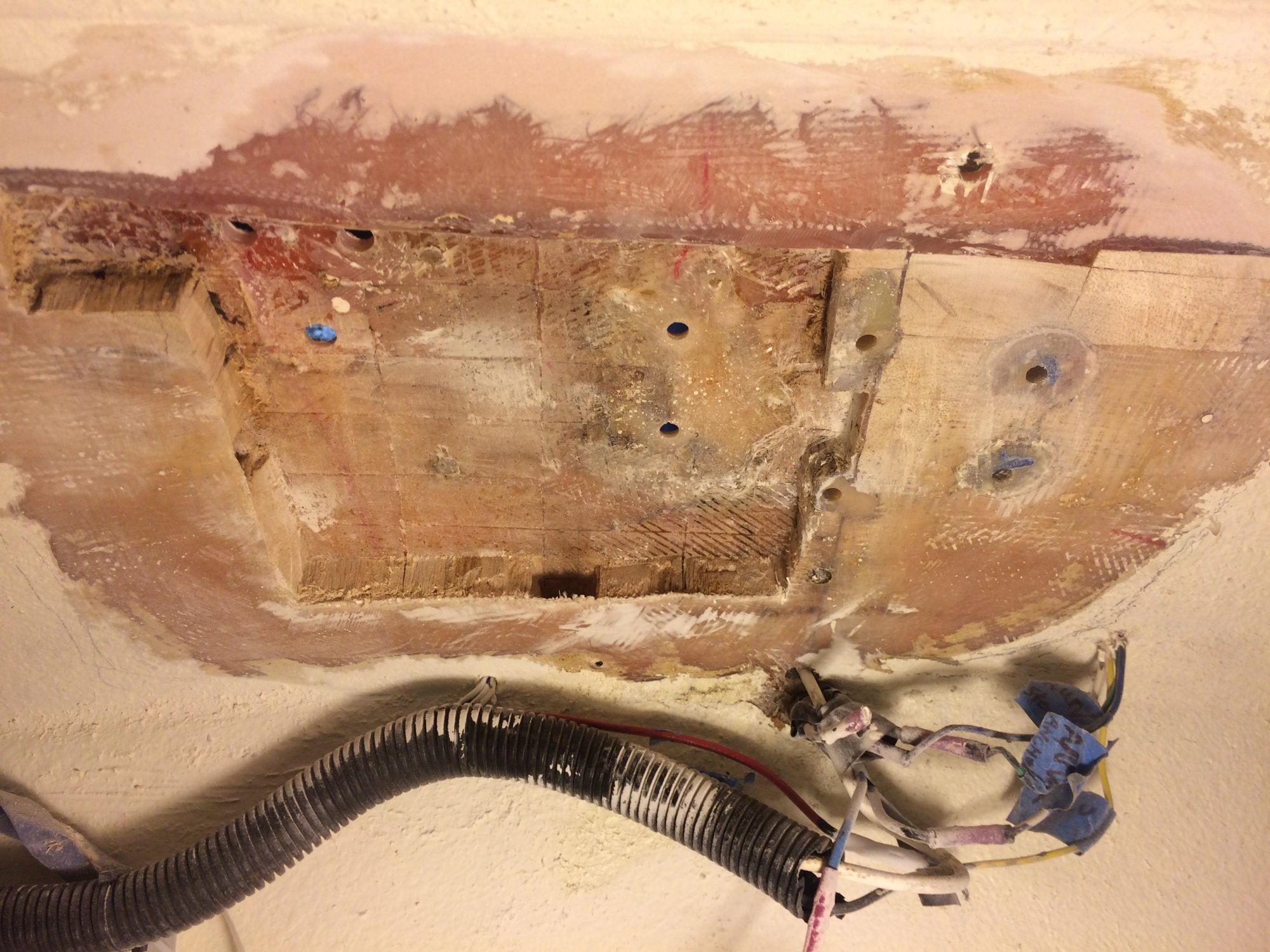

Jun 25, 2004
1,109
I've done similar repairs from underneath. It's not that messy or hard to do. And the dock still looks like the original. It's actually less work, looks better when done, and lasts longer.

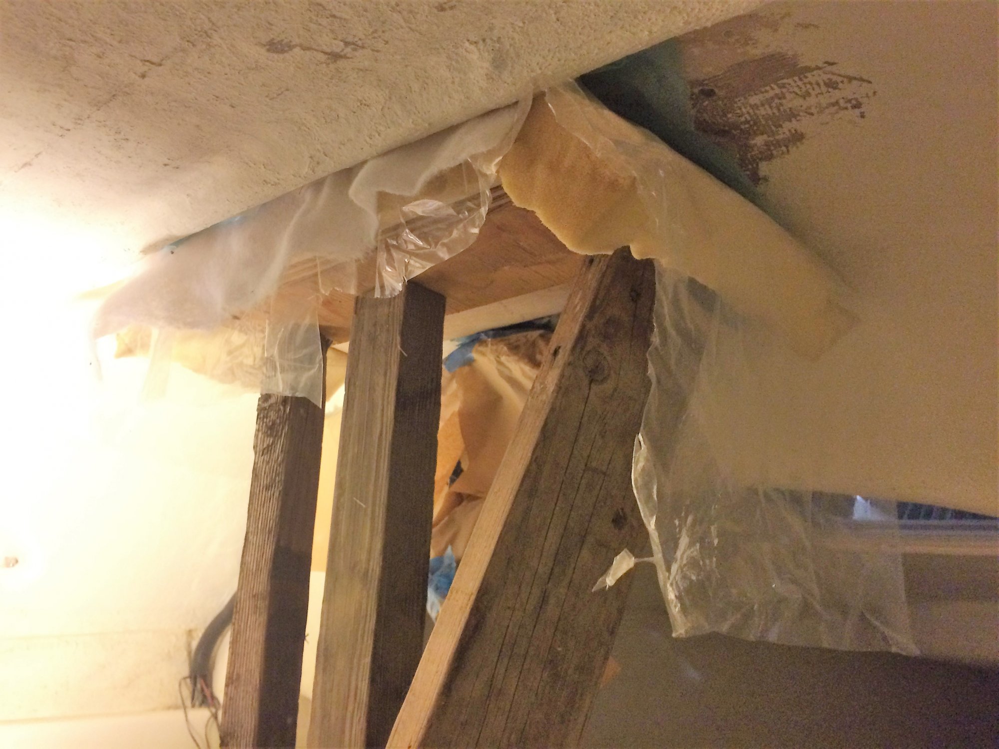

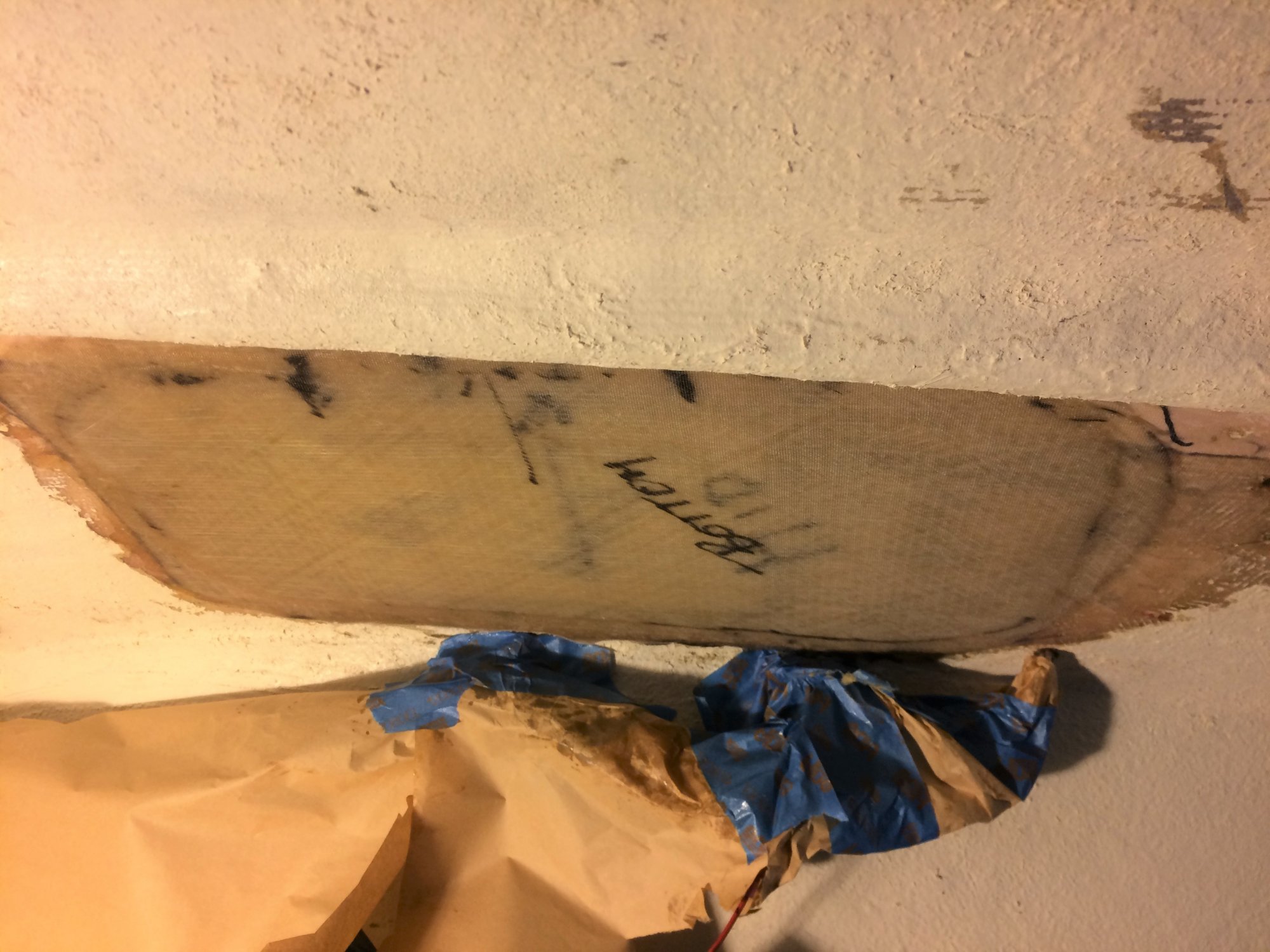

You can thicken the epoxy so it doesn't drip. Once all the materials have been pre fitted, it's a 10minute job to put everything in place and put it under compression, with two people. One person mixes the resins and wets out the materials out on the bench, while the other person lays them up inside the boat. One person could do it solo, using slow cure hardener.
For the patch, we used
  • Divynacel foam (but you could use endgrain balsa core) slathered with West system epoxy with cabosil thickener.
  • 1708 mat/glass (which is compatible with epoxy resin) . The three-layer patch was wetted out in one step and placed on the roof in one piece.
To compress and hold it while it kicked we used the following underneath the glass (from top to bottom). The technique we used was similar to vacuum bagging, but much simpler. We use foam and pressure to compress the repair instead of a vacuum bag.
  • release ply (to let excess resin squeeze through without sticking)
  • an old polyester matress pad as breather fabric, to soak up the excess resin which squeezed out under pressure.
  • plastic drop cloth as a barrier
  • old corrugated foam rubber, to conform to the curve.
  • a skin of wood that was flexible
  • a scrap of pllywood
  • 2 x 4s and wedges to push everything up against the roof, under pressure, until it cured.
If you click on the last picture, you'll see a beautifully smooth patch, with a textured finish, that isn't overly resin rich.
