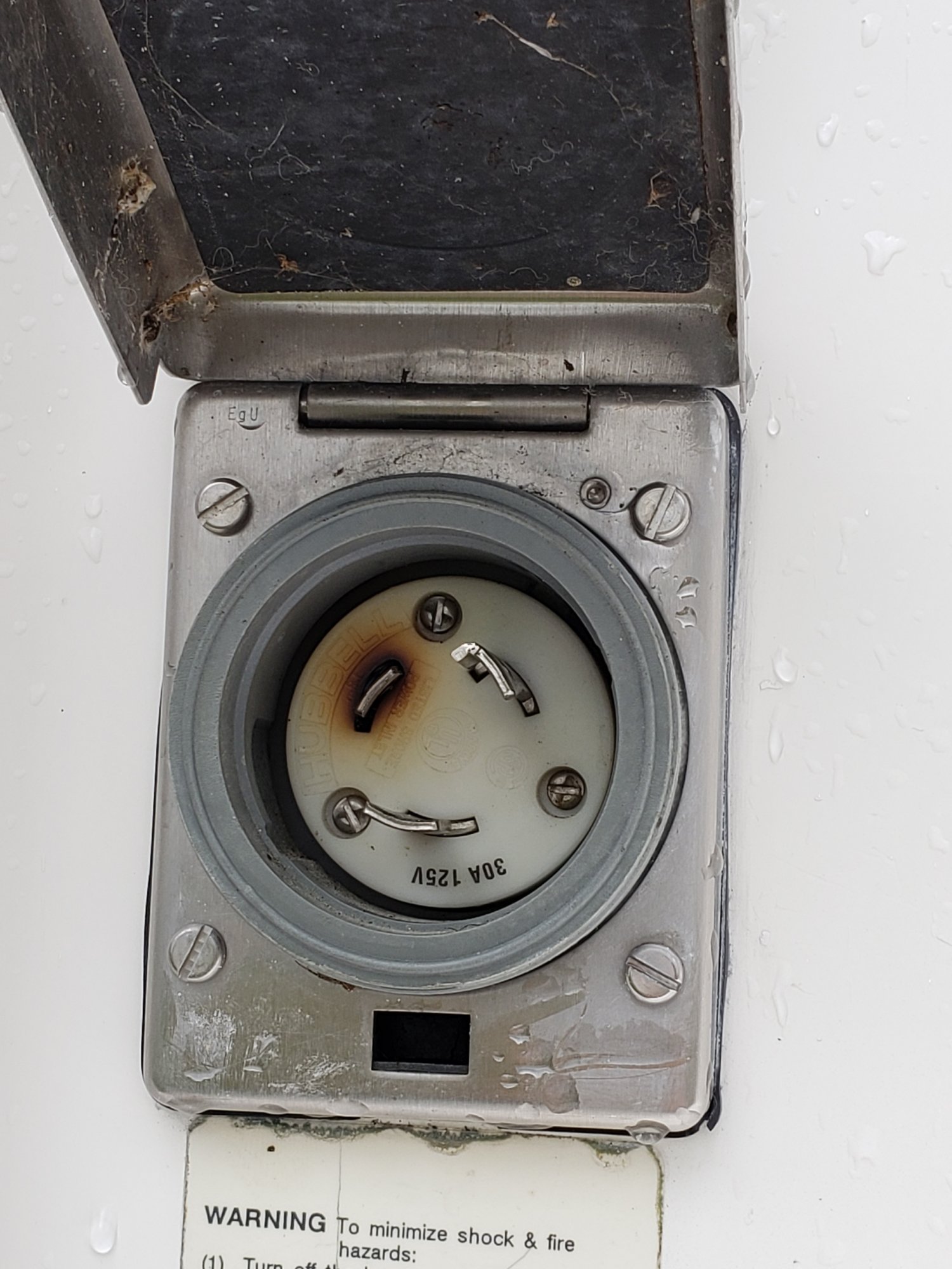

Here is the End result and reason we installed the smart plug! We bought the smart plug in the winter and we were going to install it in the spring while on the hard and finally did so after the weather got better. Looking at the plug on the stern of the boat this is what I saw! Installation took about two hours-removing the old one-Cutting the end off the EEL cord and than re-installing the new Plug etc. on the cord and on the boat. This is a job that anyone can do, the instructions were a little oblique but if you can do any electrical work on a boat you can do this.
I did borrow by buddys wire cutter that made cutting the cable and stripping the wires easy.
As you can see there was a burnt spot and one of the prongs was pushed in! Saved!:D
Thanks for everyones encouragement and input!
As soon as we get a season on this I will let everyone know-Wife thinks it looks way easier to use for her!
