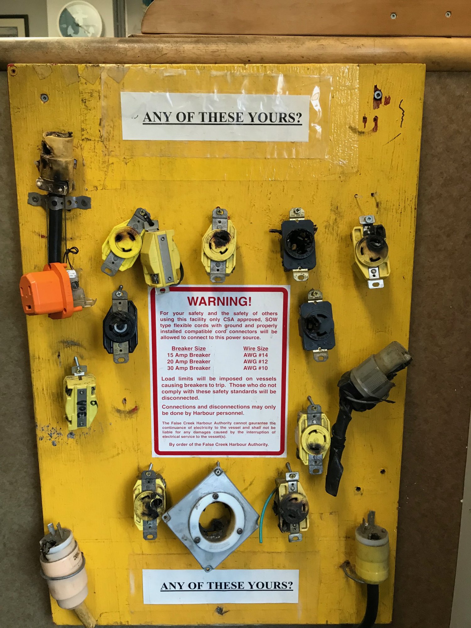

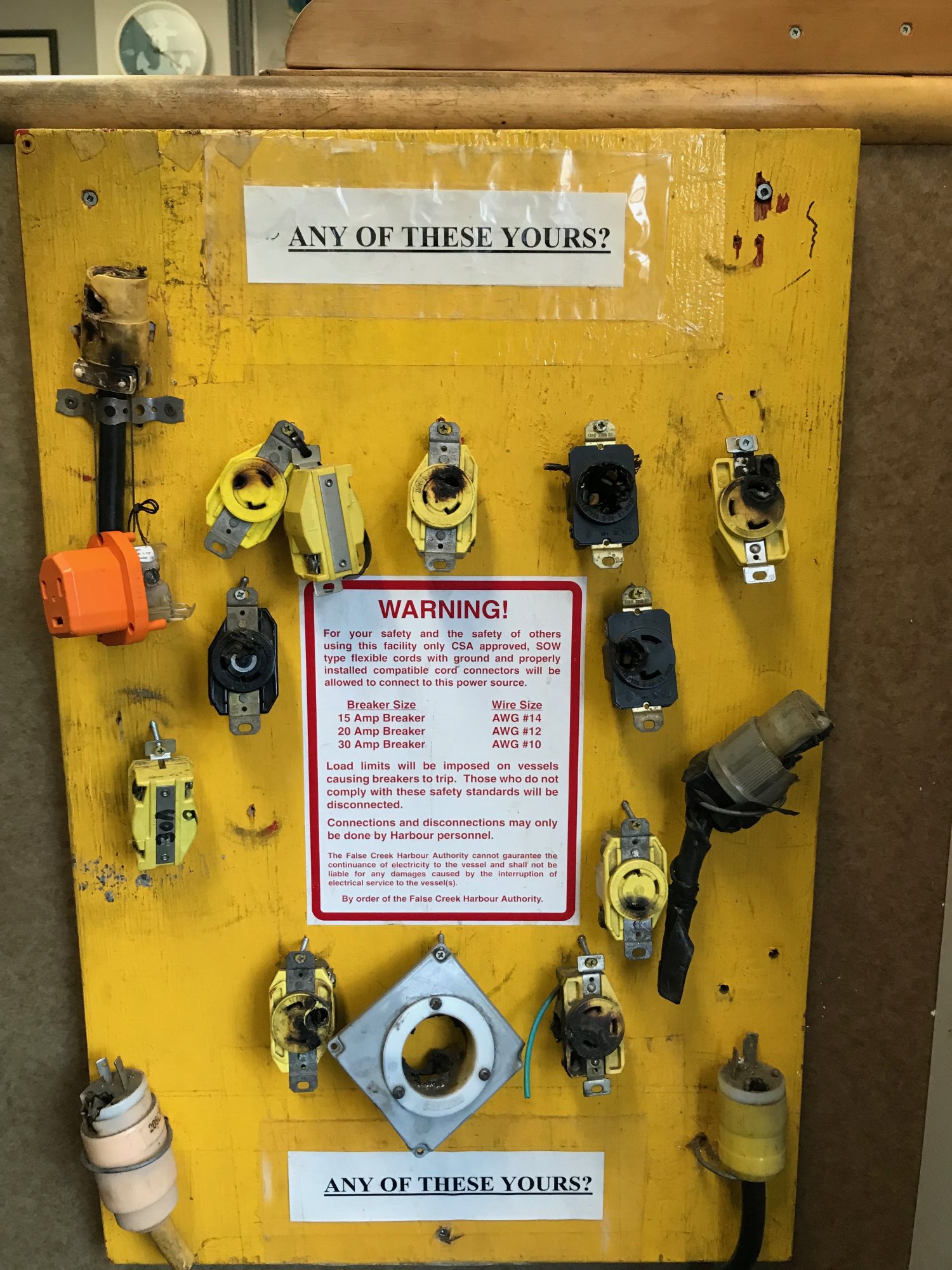

The alternative is frightening... I found this in the Marina office, Vancouver BC.
The example of the Smart plug showed no burn out.
