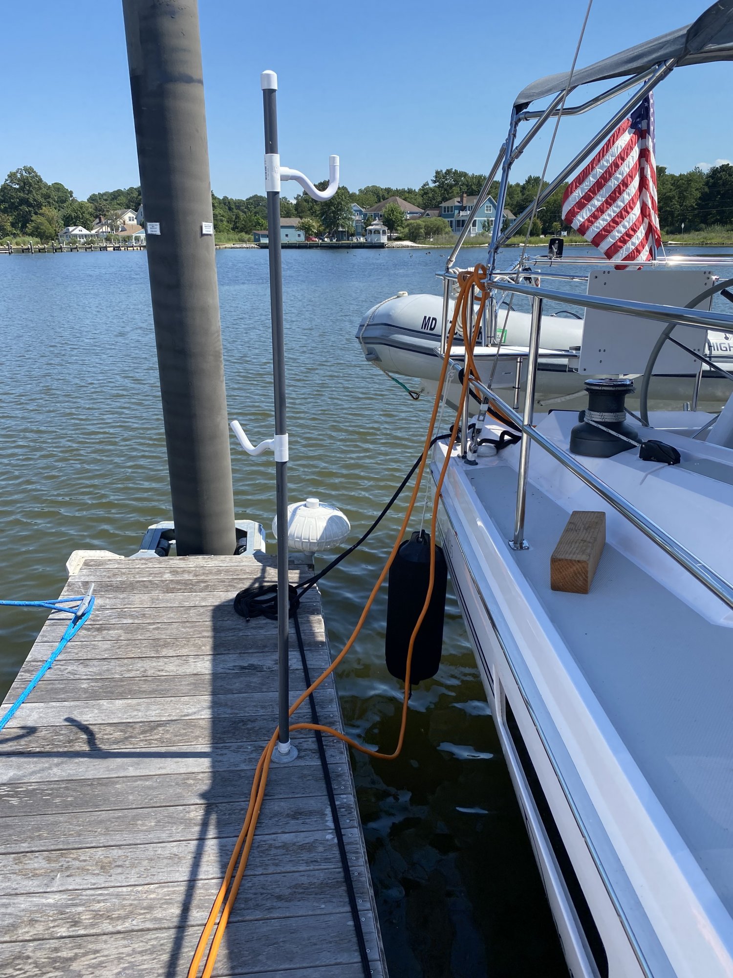

I made a line holder for our finger pier. It holds an aft spring line loop and a stern line, both fixed to the finger cleats and is made from 1" Schedule 80 PVC pipe (Lowes) and Schedule 40 fittings. The dock plate is galvanized steel (on its third season). The hooks are PVC condensate traps with a little heat bending and capped flush (tricky). When docking my first mate picks up the spring line off the top hook and loops it over the midship cleat. She then turns around and lifts the line looped on the lower hook and hands it to me in the cockpit for a stern tie. I go into gear (idle forward) and lock the wheel away from the finger (to port with finger to starboard) and the boat glues itself to the finger, allowing her to easily step off and tie off the bow lines which I toss to her. Since the boat is already tied up in the photo the lines are "on" and the spring line is seen lying on the finger.
