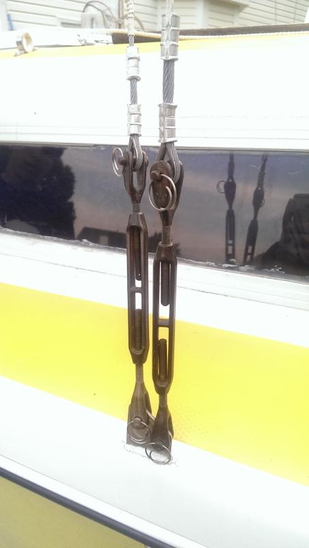

BUT!!! Your description of them getting slacker and slacker concerns me, especially if you have cotter keys on your turnbuckles. The keys prevent the turnbuckles from turning and loosening up. I know, first grade stuff but you said you were a newbie.

When you say "cotter" i dont think thats what I have. Maybe your talking about the same thing. its a pin but its more of a ring that keeps the pin from coming out. I dont know if that matters just wanted to be clear. Ill post some pics to night when I step.
The V-22, or at least mine has 6 stays. Ill have to wait till i get off work to check the other connections.
cotter rings .... as opposed to cotter pins. same function.

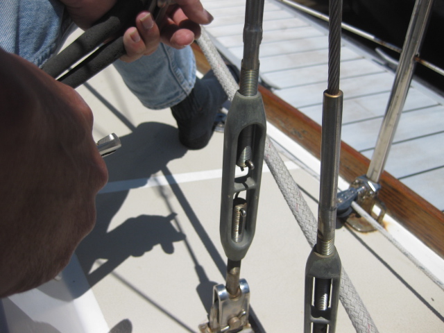

Cotter keys in a turnbuckle
Here is the best picture I have of my turnbuckles. I was adjusting the tension on my stays so the starboard stay is complete with it's cotter keys installed and the tips bent to prevent snagging skin or sails. The aft lower is not complete and the cotter keys are not installed yet. Mostly, what you can see of them is the shiny knobs inside the turnbuckles near the end of the threads.

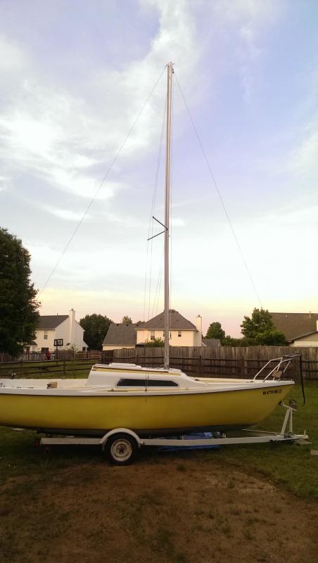

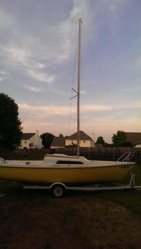

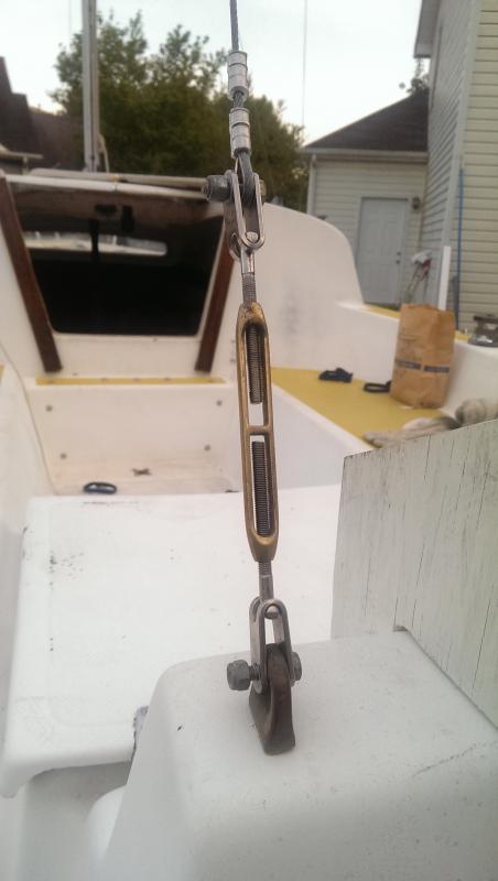

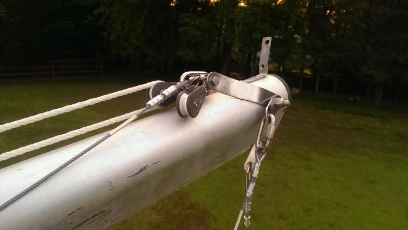

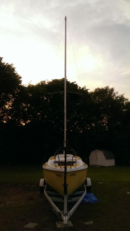

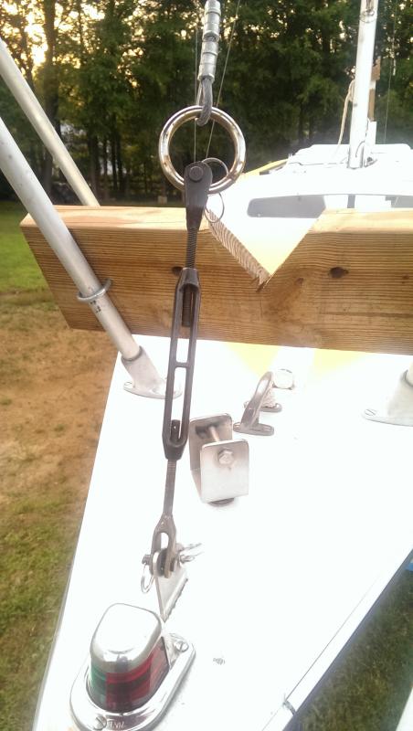

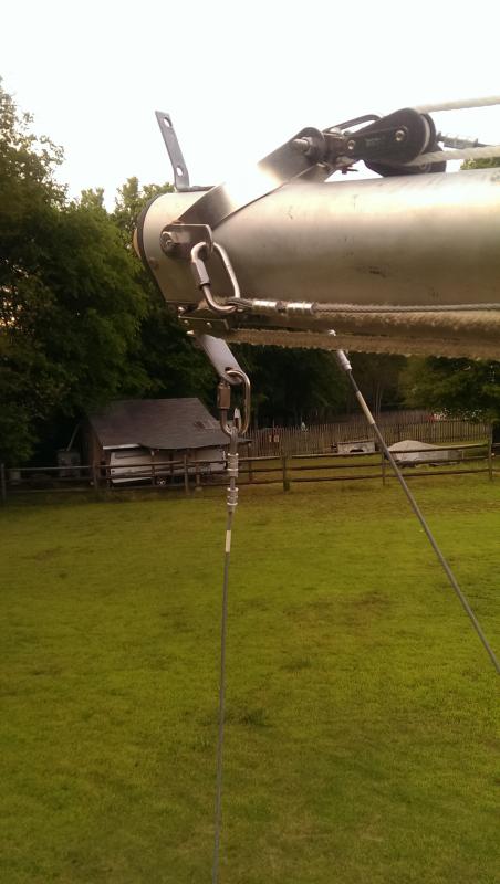

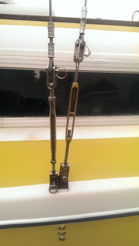

So, I step last night and I didnt see any compression in the mast. But heres the thing... Its on the trailer... that seems like it would give the boat a more solid set if that makes sense. I did not notice any compression on deck or in the cabin under the support post.
The chain plates all look solid as well. The rigging all looks fine at the top of the mast. Now that Im posting i just remember that I over looked the spreaders...:bang:
here are some pics of everything just in case you guys see something i do not.
should be in this order. Mast, Bow, Port, Starboard, Stern

okay... maybe this time BTW!! all the stays are tight now. I dont know if I mention that.... again thats in my back yard now not on water. I adjust when we were out in the water but for some reason it seems tighter on the trailer. Not by much. But before I adjusted on the water it was scary loose. (The shrouds that is.)

More of the rigging. if you look behind the mast in the starboard side pics, at the house in the background. About the same height as the roof peak. You can see the bend in the mast I spoke of in a diffrent post. I think this comes from the mast being supported (in travel) at the bow or pulpit area instead of the original mast bracket. I dont like that at all but no one else seems to think its a big deal. Im currently making a replacment mast crutch to fit on the mast bracket. Maybe it will bend back..LOL I dont know. I just want to sail and this boat really only has to last about 5 years then I have plans to by something bigger. HEY!!!! I just relized!! I have a 5 year Plan!!!! My Mom would be so proud of me!!:D
