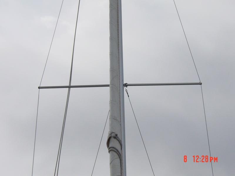

OK, your mast tabernacle looks great. Not compressed into the deck at all. I think I see why your turnbuckles are nearly closed but I'm not sure enough to say here.
A suggestion for you: Put tape on the screw threads right next to the outer ends of your turnbuckles before you go sailing again. IF your stays go slack again, check to see if the tape is still against the turnbuckles. If there is a gap between the tape and turnbuckle, your turnbuckles are unscrewing and need pins through the little holes in the turnbuckle screws. The closed turnbuckle on the starboard side should still have the locking nuts against the turnbuckle body.
The only way to figure this out now is to GO SAILING!!!! Enjoy the day. Check the tapes when you return to the dock.
About the bend in your mast, I say ignore it. My brother drove my 16 footer under a power line and bent my mast a bit but it never affected the boat's performance. It took several washings to clean his swimsuit, tho.

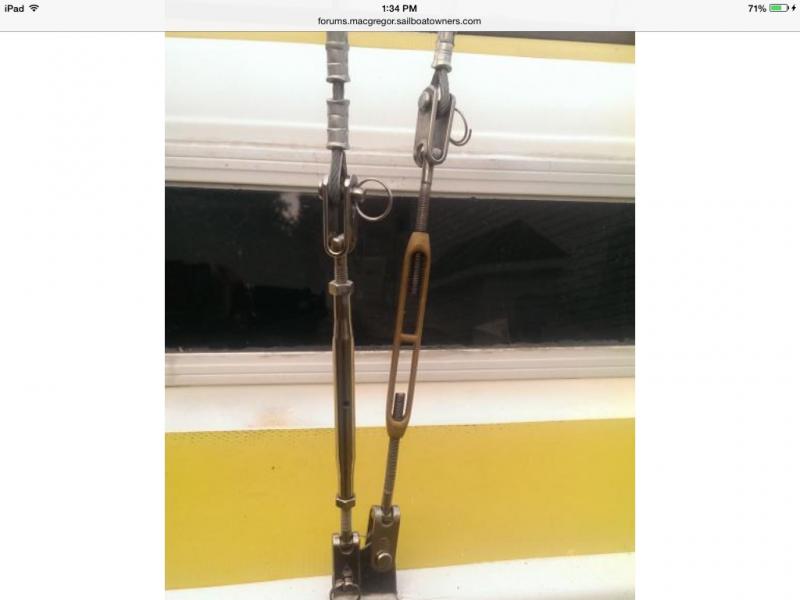

You have a non marine connection at the top of the shrouds... I'm talking about the carabiner thingy...... that's making your shrouds too long... and not adjustable. So... simply change the connection piece to give you another inch or so at the other end.
For instance... a simple "D" shackle would shorten the gap... the pin end will go through the hole.. the shackle body goes through the shroud eye.

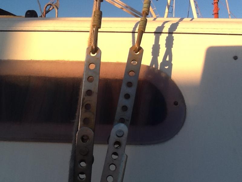

thimble should have gone through the the tang(s) on the upper end of the rigging, but whats done is done,
get a short D Ring as suggested, or start(smart) over, call it a learning experience, tenssion the rigging, and tune the mast, angle(s) and bow as U

Except for the OP's masthead rigging, that's pretty much how Roger designed these MacGregors, thimbles through a tang, and the tang through-bolted.
He also put the thimbles through the adjusters at the chainplates.

I don't know how long you've had the boat, but it looks like the rigging has been totally modified over the years with way too much extra crap that you don't need. I don't understand the ring at the stem fitting for instance ... it's just adding length. Also mentioned are those Quick Links at the top of the mast (those connectors that look like a C with a captive nut). Those look like they were added to make removing the shrouds easier. They don't really belong on your standing rigging and could be a weak link. Also, there are way too many fittings at the bottom of the shrouds with a swaged eye and then the separate toggles. I don't know why you can't just have your wire swaged to a threaded rod which gets screwed directly into the turnbuckle.
I would start from scratch and have a rigger (or do the research and do your own work) to simplify your standing rigging. It looks like it has been tinkered with so much with extra parts (and some of those tangs look questionable as well) over the years that there is no wonder that it doesn't fit. Start from scratch, simplify it, and get it right.

D shackles concern me. Seems like they could come loose easy, BUT again I do not know much about this stuff. If Im re-doing this I would feel more comfortable looping right to the tang. Would that not be the best option there? seems to be one less fail point.

Ahh ... that makes sense about the ring!
It's not a bad modification in that case. It's certainly strong. I think the Quick Links at the upper shroud fittings is what makes most of us uncomfortable. Joe's suggestion to use a shorter shackle is sound.
I prefer the 2 Pc shroud tangs that has 2 ears where the eye fits between and is secured by a clevis pin. It looks like you could replace your single eared tangs and eliminate the Quick Link (or a shackle) completely.
https://www.dwyermast.com/items.asp...are&familyID=28&familyName=Tangs+(Mast+&+Boom)
Here are some examples.
You would have to take the hound apart and simply re-assemble with new tangs.
thank U for setting them all straight
and yeah, I'm pretty sure about that
Nov 8, 2010
11,386
Wow. I'm at a loss to know what I really think about Roger Macgregor.
I look at that picture and that 'hardware' and I might think he's a duplicitous bastard.. Claiming to newbie boat owners that MacGregor has 'wink wink nudge nudge' figured out how to make boats 'just as good as the big guys', but at a lower cost due to their 'efficiencies'. Looking at the picture, you could reason that is NOT the real reason why they cost less.
As the same time, I don't ever really hear stories of Mac rigs falling down. And people love them for what they are.
Huh. Carry on, MacGregorites!
Absolutely correct. Get rid of that quick link(s), it's a disaster waiting to happen. First, it's too long, and Joe's idea about a simple D short shackle(s) is the right approach. Second, it'll get you back the room on the threads on the shroud base at the turnbuckles.
Look at the bright side: at least you have open bodied turnbuckles, not the closed ones! :)
Actually, solodare's got both.

YEAH, I dont like the new one. Wish I cold find and old one like the rest.
I have a brand new one like the one on the starboard side. I guess I could match the other side....
