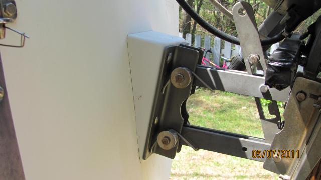

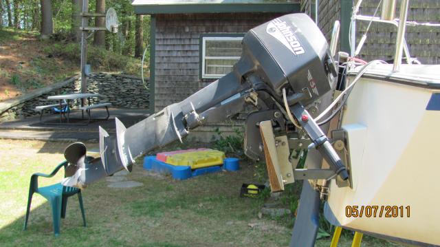

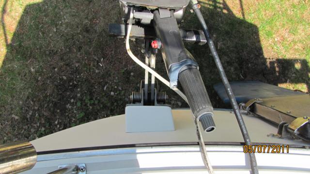

I'm using a 1999 Johnson 8 hp long shaft two stroke on my 1986 O'Day 222 and I love this engine. It's mounted to my transom on the original bracket that came with my boat and the bracket is mounted on a block on the transom which allows me the space between the engine and the transom to tilt the engine up without having to mess with the bracket tilt.

My pleasure! If you need a block for your transom, you would probably need to build one out of fiberglass. As far as I know, they aren't available anywhere.
