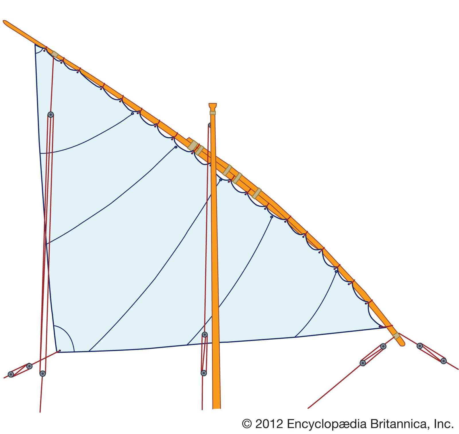

8,265
The sheeting angles would probably be all wrong. The mainsheet would be pulling down on the leech and not getting any outward force. That would leave the sail with too much draft and no way to introduce twist.
There is definitely a control for twist. Inspect this picture to translate marconi rig controls to the lateen's.
