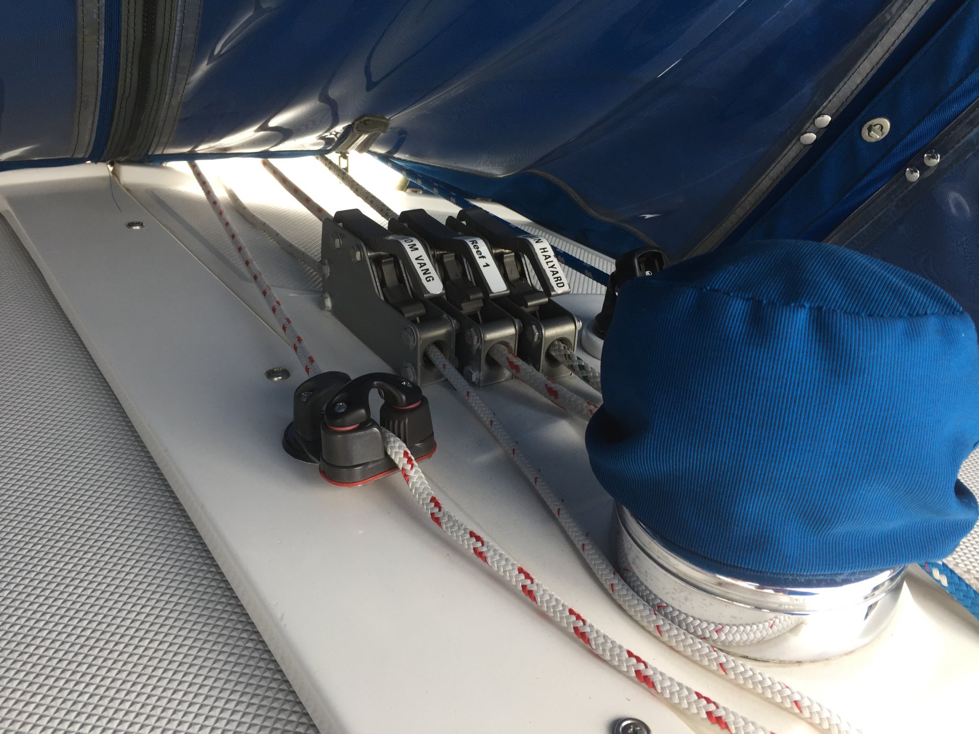

Not a great phot, but my rigger led both traveler control lines aft, inside of all the other control lines and halyards. Makes it much easier to use the traveler, single or multi handed. If you’re interested I can try to remember to take a picture of the rigging at the traveler.
